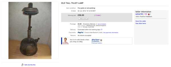

    Hi everyone, Now the auction has ended I can ask the question that has been burning since I saw it listed. Was the TL10 or 11 with the reeded column ever made in a short version? Silly question I know because i'm looking at one but why can't I find any reference to it on here or anywhere else, as far as I can see, on the web. Could it be extremely rare or perhaps never mass-produced? Anyway i'm stumped :-s Perhaps someone with a bit more knowledge could enlighten me O:) and maybe someone on here is the lucky new owner and will post some pics at some point. Best regards Matt

    Saw this one but just assumed the column had been shortened, would be possible wouldn't it to cut down and weld back in place?

    Hi Jean, that was something I did think of but the condition suggests it has been stored for quite some time and i'm not sure people would modify their lamps in that way back then. Unless the column got damaged and they salvaged what they could. It was not knowing, that stopped me going for it too hard. Hmmmm the puzzle continues :lol:

    Hi matthew i saw this too and reckon someone cut it down it looks proportionaly wrong as well and the big solder seam under the control cock looks wrong. Maybe someone just wanted a shorter lamp so chopped it down a bit people in the 50s\60s could do stuff like this was a time of fix it dont throw it away and buy a new one like it is nowadays. With the tilley factory anything is possible and stuff turns up not documented but i doubt it left the factory like that

    Hi Pete, I can't say I noticed the solder seem I thought it looked like silver paint or dull chrome but I didn't think that was right as the tank is obviously gold although it does appear to cover the majority of the column. It is certainly a strange one but i'm sure we will get the bottom of it. :lol:

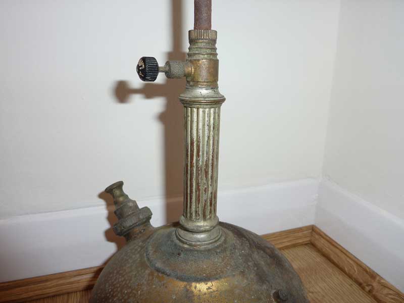

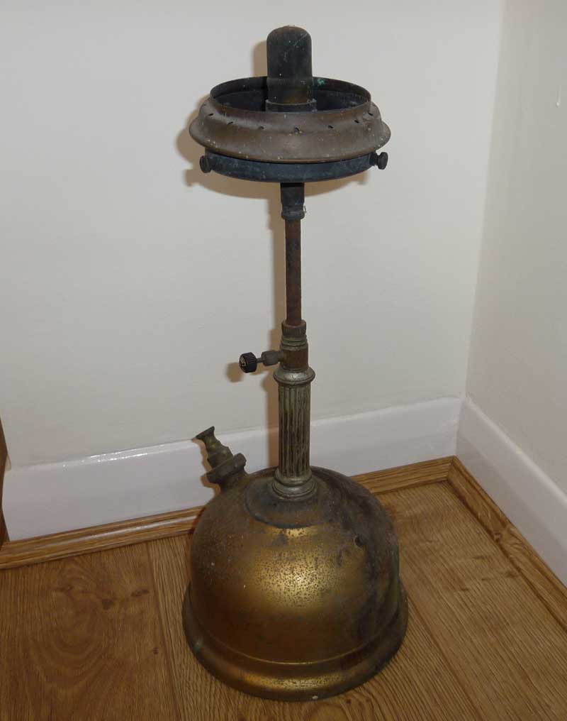

    I thought I would now break cover and let you know I took the gamble on the lamp and it arrived today :)

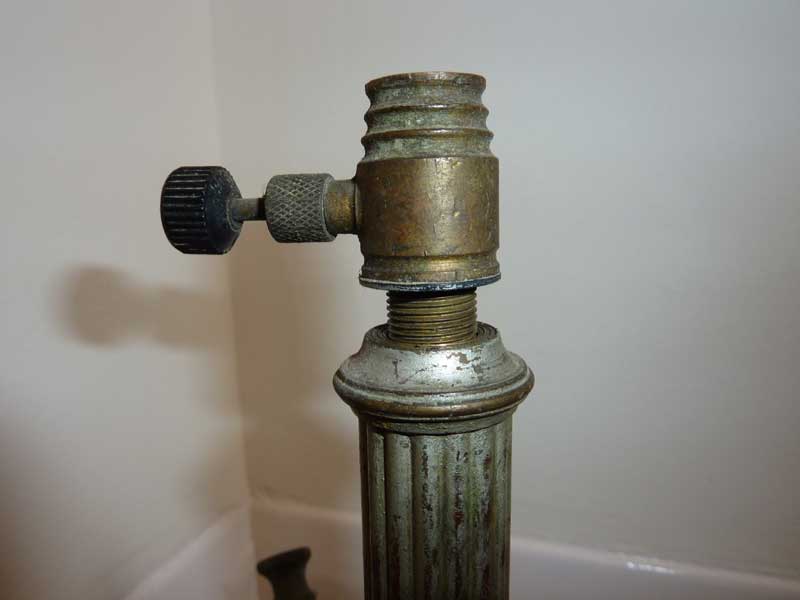

    I have attached a few photos of the interesting bits. There are no signs of cuts, joints or solder. I was very pleased to find the control cock unscrewed in the normal fashion as I was expecting to find it soldered on to the end of the stem. It does appear a proper short stem rather than modified ? I did wonder if the silver finish was solder when I was bidding but it does appear to be paint. The lamp needs some TLC but is a great project, even the pins and springs are good, gallery needs re-aligning. The tank is badly marked and I will try to clean it up to preserve the decal which is virtually intact (says Tilley Lamp Table Model) but may have to revert to a repaint and new decal.

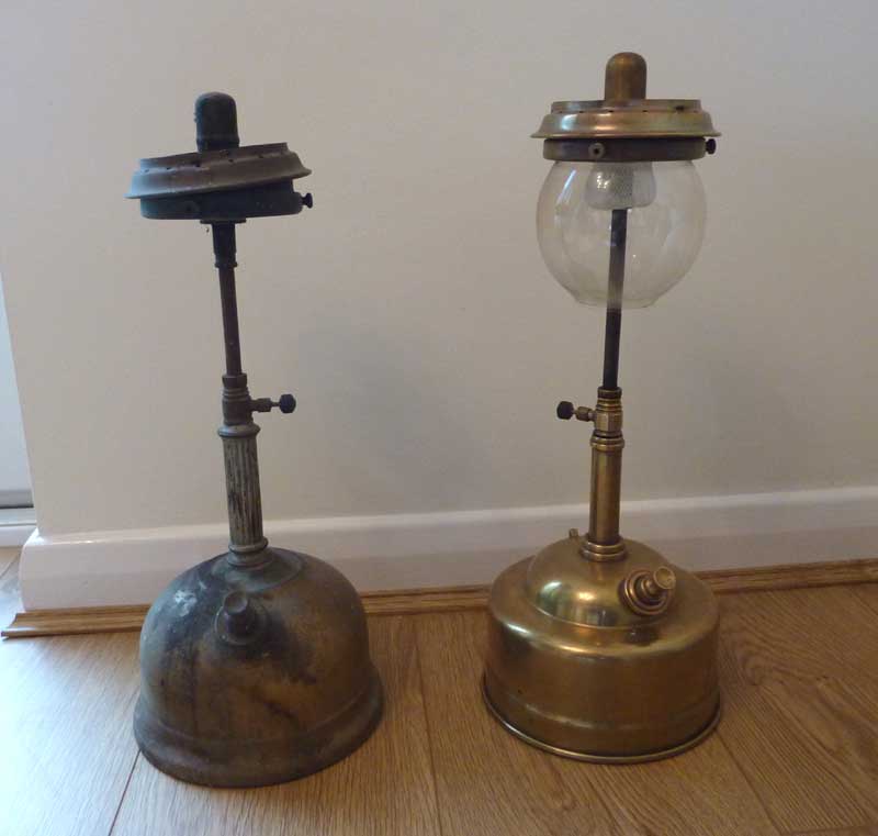

    Hopefully others will turn up in due course to help confirm it was factory made ? Last picture shows comparison against a TL136 for height etc, looks in proportion (although glass not original on the 136...) I wonder what model Tilley would have given to this lamp ?

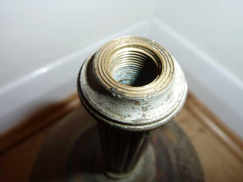

    How deep is the socket for the control cock, is it just deep enough for the GF control cock which it came with, or would it take an XN? Jeff.

    As I thought its only deep enough for the GF, tried an XN but it isn't deep enough. I am not too up on the timeline for Tilley control cocks, any idea on possible date ? By the look of it I think it is the original cock. Bit of a mystery lamp this one.

    The fact that the socket is only deep enough for the GF control cock, confirms my opinion that this is a WW2., lamp.
    Tilley introduced the GF control cock in 1940.
    It's also possible that this lamp was made by a Tilley worker for his own use, but if more examples of this lamp surface, then it's a so far undocumented lamp, Jeff.

    Hi, Comment from a real amateur here: is it not just that it has a shorter vapouriser tube? If you put the longer Tilley vap tube on it, it surely would be the same height? Also, the control cock does not seem to be right; too much thread showing to be original maybe? Perhaps I am being too simplistic or missing something?

    I had unscrewed the cock from the socket just to illustrate that it is a proper thread as we wondered if it had been bodged on there with solder. It does screw fully in. Its a good point about the vaporiser though, I think it is a short one thats fitted, will fit a long on tomorrow and see how that looks against the 136. I will also measure the length of the stem against a normal TL10 and report back to the forum.

    Well then this is interesting. David I think your gamble has paid off. I'm no expert but looking at your more detailed photo's i'm convinced it is the real deal. I think you can sleep easy tonight knowing you've got something that quite a few people around here would like to own. Me being one of them :mrgreen: . Well done and let us see when you have finished cleaning it up. Best regards Matt.
