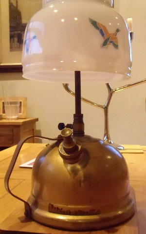

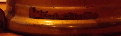

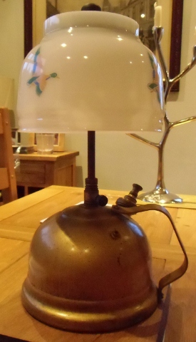

    Just a wee update after my 1st haul of lamps (when I only went to look for one).
    Washed and mantle fitted but will need new washers (ordered from Fettle Box) as pulsating when lit.
    Seems to be all original and the base, no picture, is black paint.
    There's no vote yet if it's getting to stay on the dinning table :shock:

    That looks really nice, where did the top hat with the ducks come from? Best regards Matt.
  3. monikieman
    Aug 31, 2012
    111
    Hi Matt.
    Literaly.....Scotland. Kind of near to Perth.
    I didn't know it was a tilley shade. :oops: I tried it in the bottom of the gallery where the onion globe goes. It didn't fit so I didn't bother taking it. I had bought the lamps and he offered to throw it in.
    A very nice chap (Shedman) explained that I may have been a little careless so I went back for it today. The chap might have a few more (not ducks!) and he has heaps of paraffin lamp globes and loxon mantles etc.
    Brian
    Fingers crossed!
    16,883
    Hello Brian, if it's pulsating then there is most likely a problem with the vapouriser or the burner or both.
    Or the fuel feed tube may need to be wired to clear any build up of muck.
    Fine shade! :thumbup:
