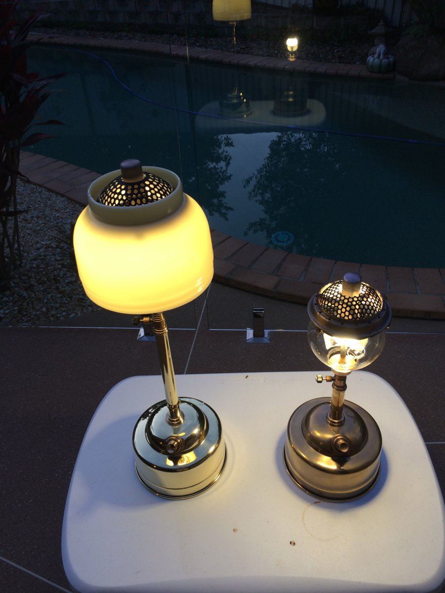

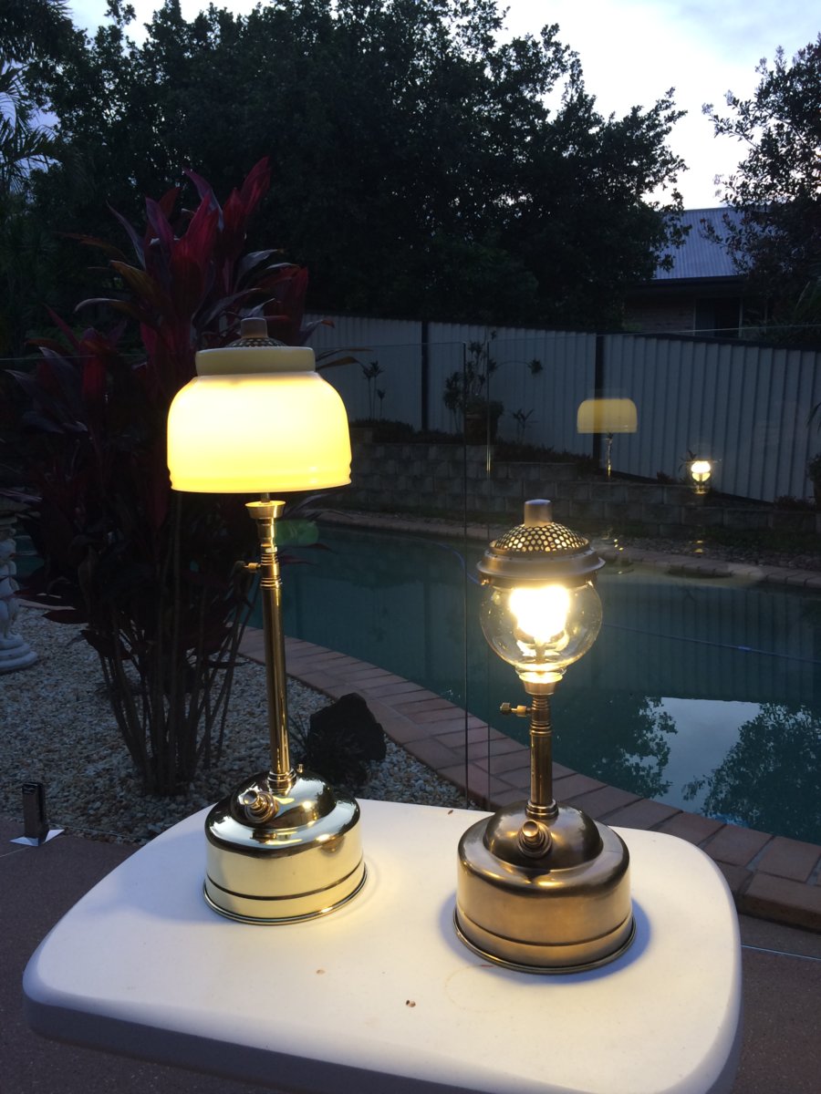

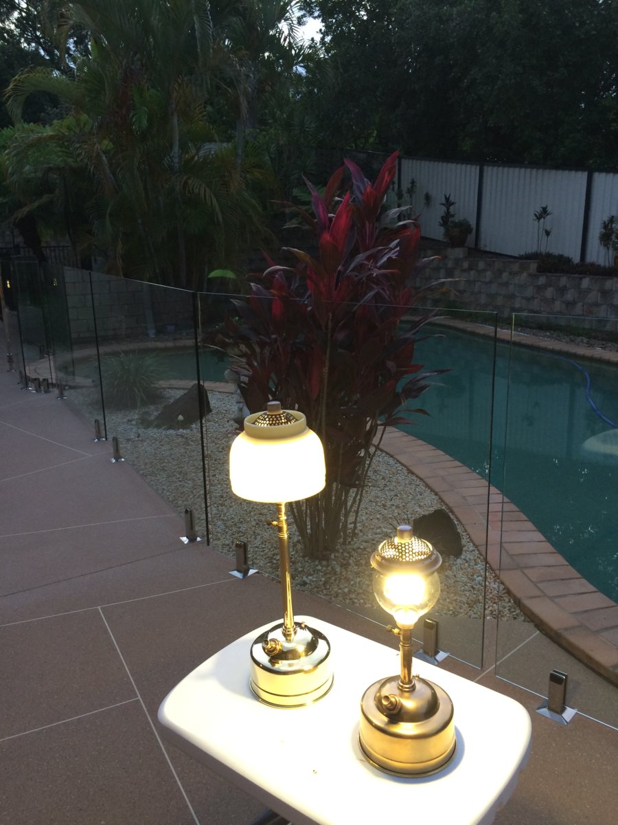

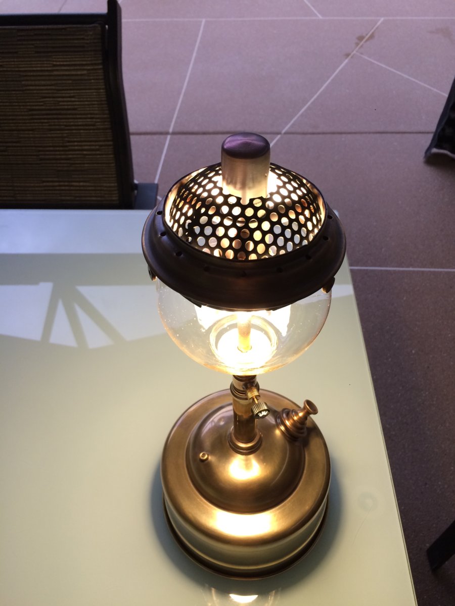

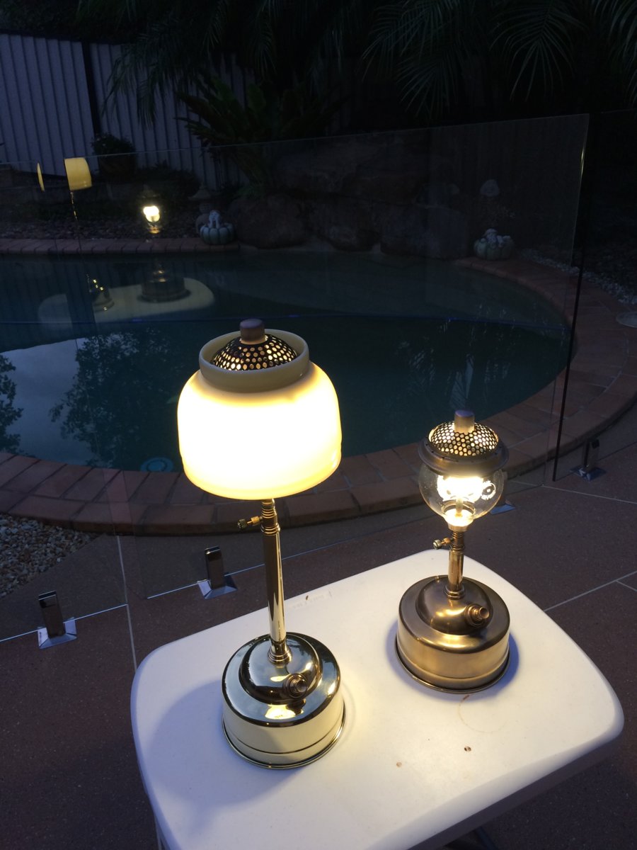

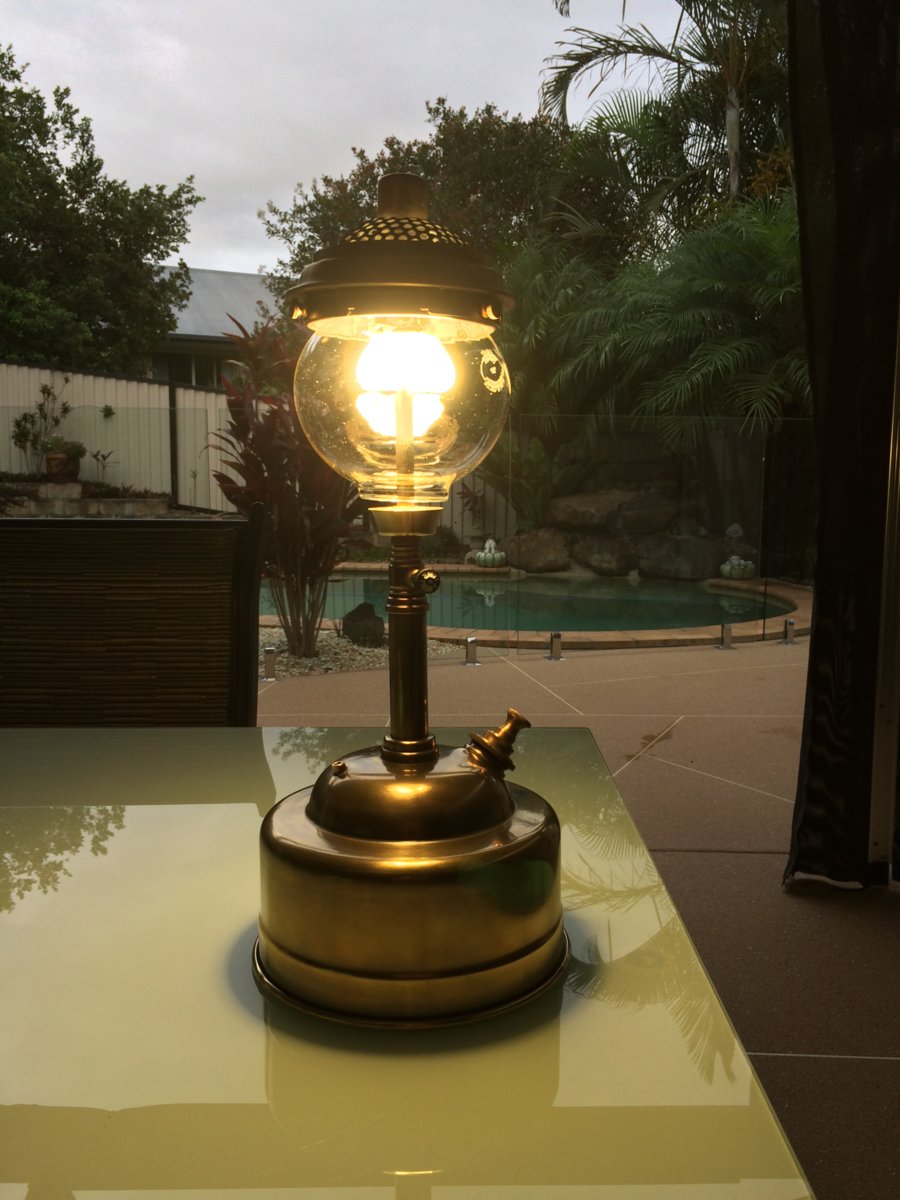

    Advise needed please, tonight i fired up 2 Porkpie Table Lamps, one short stem, the other tall stem both had the same Champagne shades (Original)
    I noticed that one was a lot brighter compared to the other even after 2hrs no change in brightness.
    Both were not flickering, both had no fireball. I quickly turned the dim one on/off to clear the jet, no change. Could this possibly mean the generator is stuffed. Ive cleaned the wire, i can see the light at the end of the hole in the generator.
    Don’t get me wrong it’s still a beautiful light the lamp is giving off but just a lot dimmer from the others. Could it be that one generator is the 606 and the other generator as a 169 could size player part.
    Any ideas ?

    Swap the tops over. Then you will know if it is the burner or the vapouriser.

    Thanks Nils i will try this see if that makes a difference.
    Hi George, not sure what you mean as side by side theses a huge difference in brightness.
    Regards

    If a vaporiser was on its way out could it still burn with no flickering or fireball, and still burn dim ? Or do they all start flickering with a fireball if they are on their way out.
    Also would the 606 burn brighter compared to a 169 due to the vaporiser being a shorter tube with less distance for the kerosene to travel ?
    Regards
    Darren

    Did you swap the fully fitted burners over?
  8. Mackburner
    I suspect the simple truth here is just normal wear. Tilley burners and vaporisers die of old age. They can still look pretty good and give a steady light but I have measured plenty at 80 to 100cp so less than a third of the rated power. These are near 70 year old lamps and will have seen plenty of use so neither will perform as they did in the 1940s. One worse than the other is also normal for old Tilley burners since they are hardly likely to have had exactly the same usage. ::Neil::
