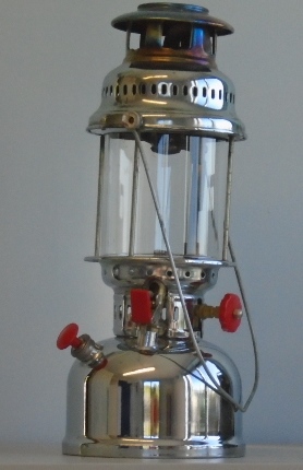

    This lamp has come into my possession. Having looked through the gallery, the closest I can find is an Anchor, but there are no markings on this one to confirm.
    It arrived with a thick layer of dust, but has cleared up nicely. Initial checks shows that it pumps fine and holds its pressure. Just need to check the jet and fit a mantle.......
    The only defect found can be seen in the photo......... it has a slight lean, but if it runs well I will call it character :content:

    I could not leave a lantern looking like the "Leaning Tower of Pisa'.
    I would have to strip it and have a go at straightening it.
    I think it would straighten easily.

    I dunno, David, it has that Italian look to my eyes...
    But it should be easy to straighten by easing the frame base plate screw and just re-aligning the frame on the fount.

    Looks like a rare angle lantern.
    These where used in the earlier days to light around the corner.
    I guess when you tun it around the angle disappears and the lantern looks straight. That is the "looks great, selling" point.

    It's an Anchor

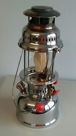

    Time to play at the weekend. Head, cage and burner removed, quick clean, rebuilt - straighter than before, new mantle fitted to a borrowed ceramic burner.

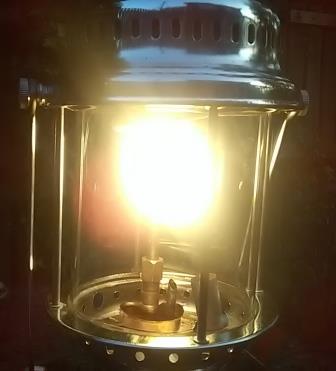

    Fueled, mantle burnt in, pumped and ..........
    Followed by........
    Nice bright burn. :D/:content::content:
