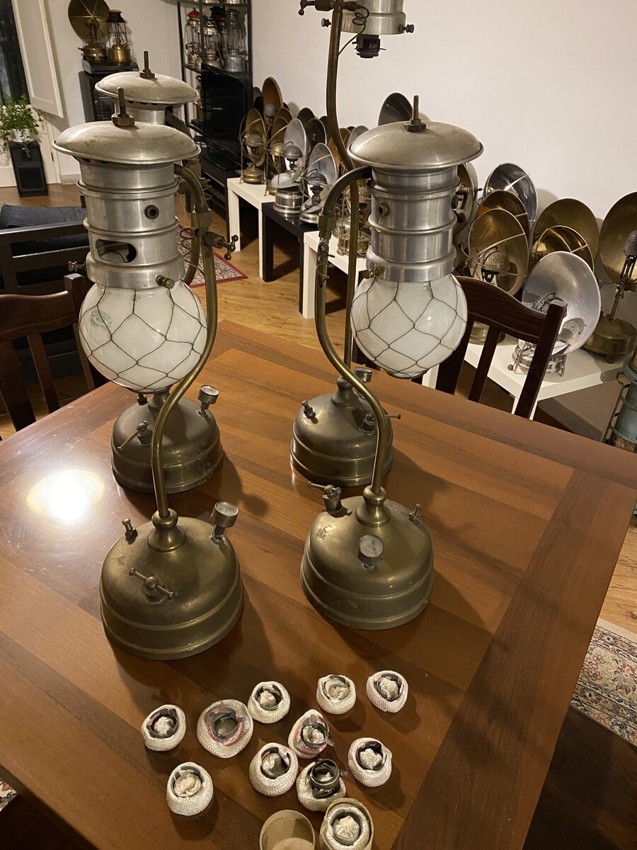

    1E817CBF-BD9A-47BA-8EE5-650907B6FC27.jpeg Hello, I have just acquired a lot of 4 Unic no 6 lamps (for what I know), 2 of them are unfired and complete with their original globes and 2 of them are barely used but unfortunately without globes.
    One of these lamps is way taller than the other three, so I assume this model was produced in different heights.
    I know there is a discussion about the period of these lamps based on tank size, shape and decoration.
    These lamps were brought back from Paris in the early ‘30 by the grand grand father of the person who sold me the lamps. This is a sure information. The original owner used to sell his products at street markets and these lamps were part of the lamps he used to have light during the evening.
    So my speculation is that these smaller and without decorations tanks were contemporary to the embossed decorated ones, maybe just a cheaper version for outside use, while the decorated ones were meant for internal use in the houses. My two cents.
    I just took a picture of them so I will post more later.

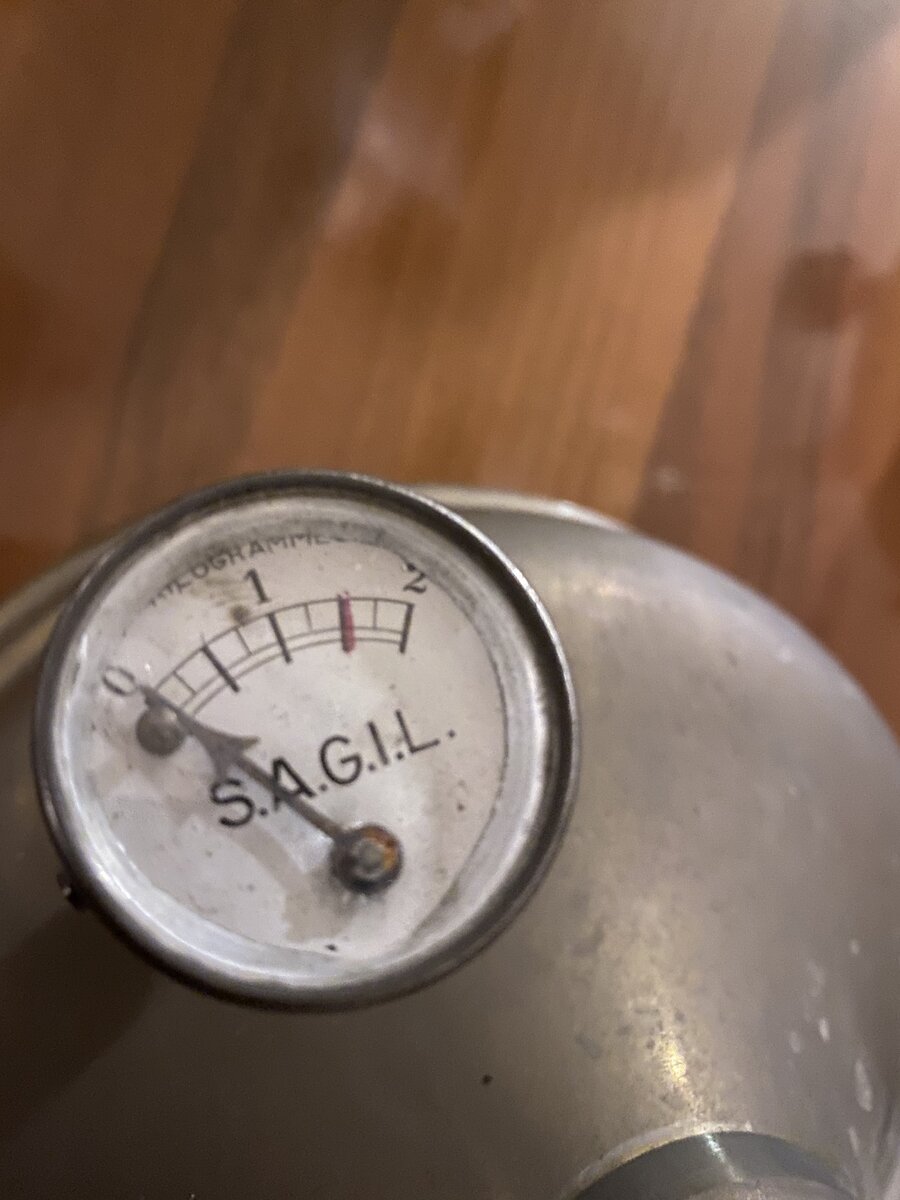

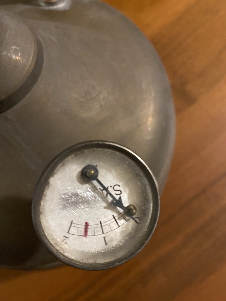

    Oh two of the pressure gauge are branded Providus, I don’t remember the other two, I am not home now so I will check later.
    I know Providus was a distributor of Unic lamps in Italy.

    I had a Providus manometer on a Unic lamp but I thought this was a wrong mounting. Have you the proof of this collaboration ?
    please tell me what postal address is on the Unic manometers
    3 impasse du Moulin Joly is pre 1930/32
    5 rue du Moulin joly is post this date

    unfortunately the manometers are not from Unic so we can't use them to have an idea of the production period
    The very first mention of the society is from 1925, but it could be 1922 (I am still searching for proofs)

    ----Unfortunately the Nicola's manometers are Providus or SAGIL
    and I know nothing about SAGIL. Is this a french society ? I will ask for in the french forum.
    ----On thing puzzles me : The 3 or 5 rue du Moulin Joly is situed in a small building in the Jewish neighborhood
    On the ground floor, we have a restaurant. On the first floor, the Unic Lumière Company and Mr Hinsberger (a metal cutting worker). Then on the second floor, Mr Hinsberger's apartment. The floor space of each floor is 60 m2 !! I don't see how Unic was able to produce enough to export to Italy ?

    @nep036 On the SAGIL manometer, the word KILOGRAMME seems to be write in French ?
    I don't see very well
  15. Fireexit1 United Kingdom
    3,538
    It would appear so to me as well, but in British English that spelling is also permitted, but I guess not relevant here. Chilogrammo is italian and it is intersting that parts of the manometer's faces have been deliberately scratched off. I wonder why ?

    Yes on the SAGIL manometers I can read kilogrammes that should be french, on the Providus ones chilogrammi in Italian.
    Nicola
