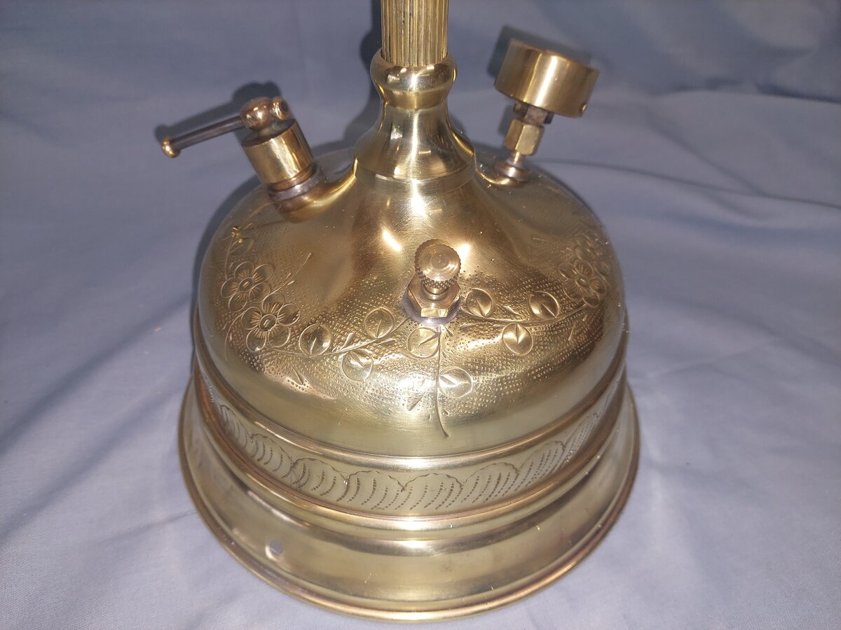

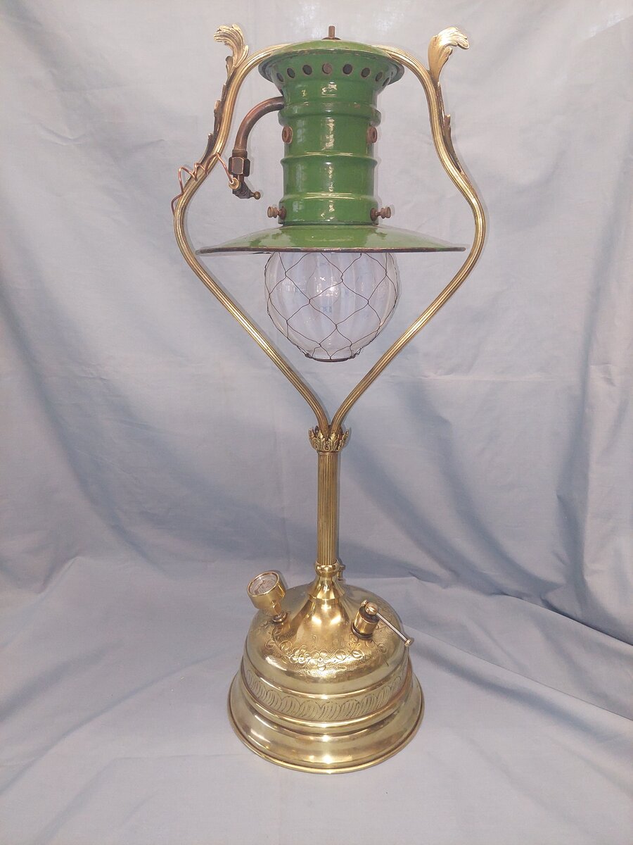

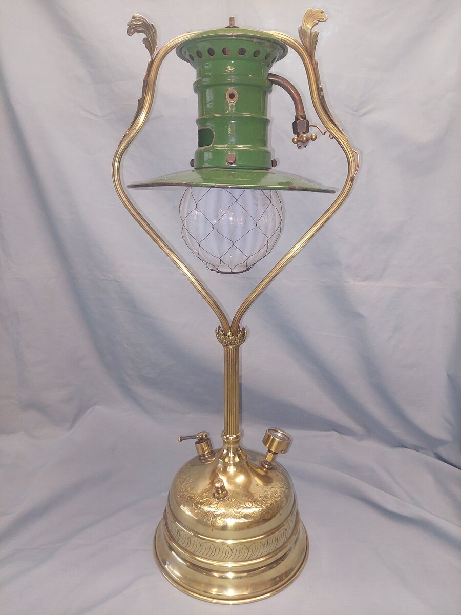

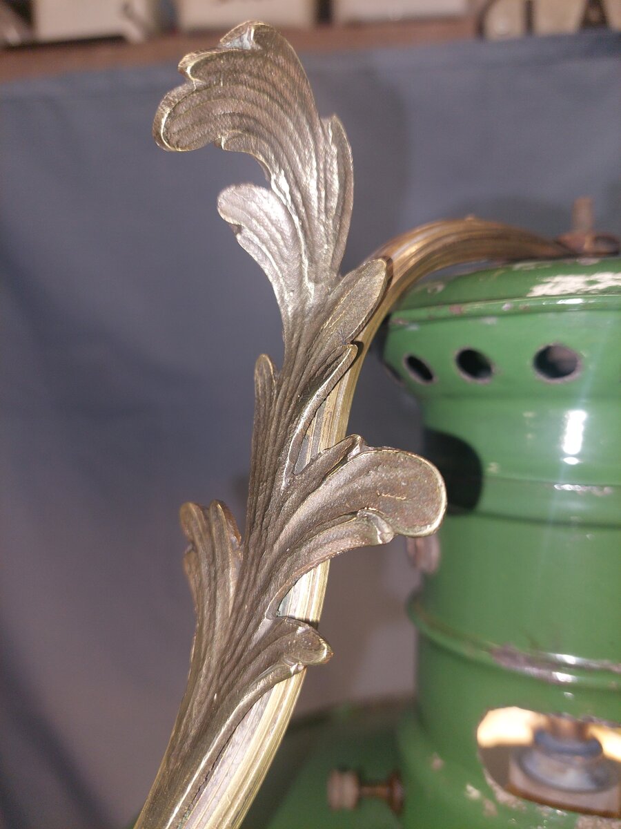

    Here is a nice example of a unic no 7 i believe.

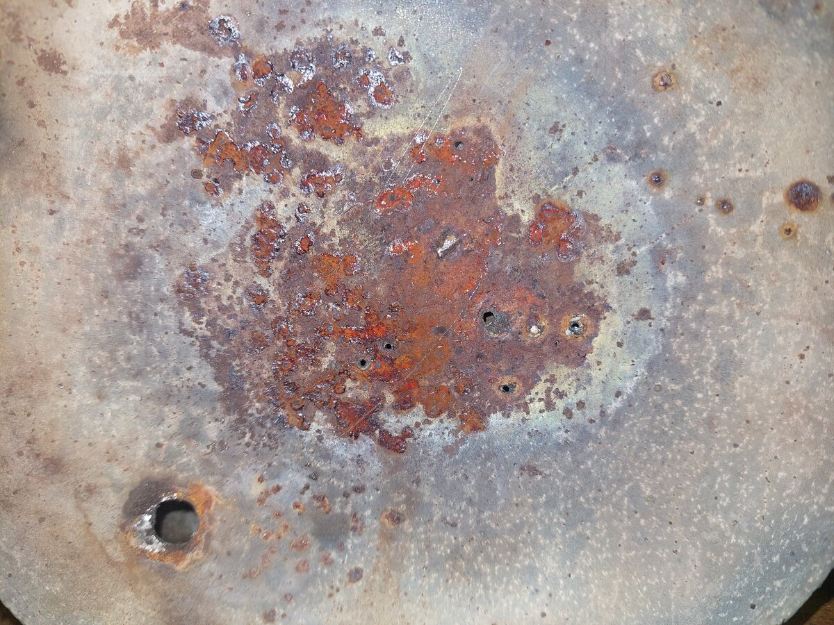

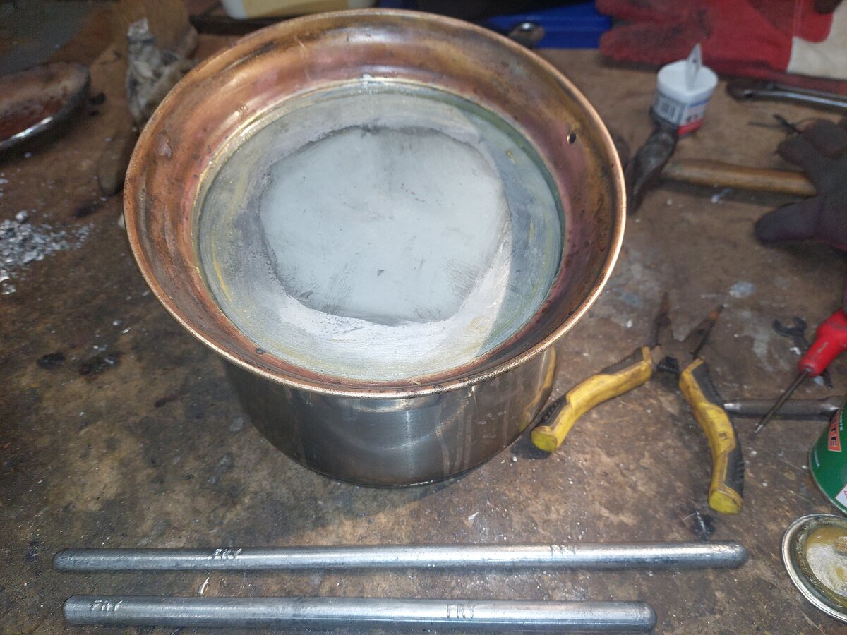

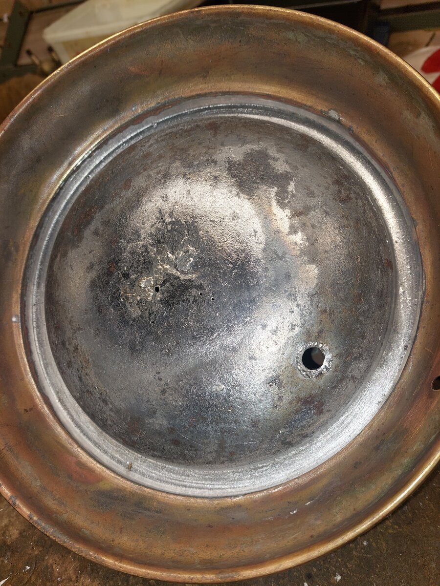

    came to me for fettling as a non runner previously electrified lamp
    the base had been drilled for wiring and the fuel supply pipe had been removed to run the wire to the bulb

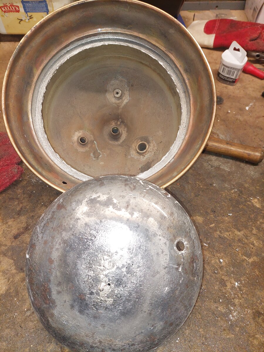

    I decided to remove the baseplate and put a 1mm steel plate in it as it had many rust holes and a couple of small cracks in the tank side above the join.

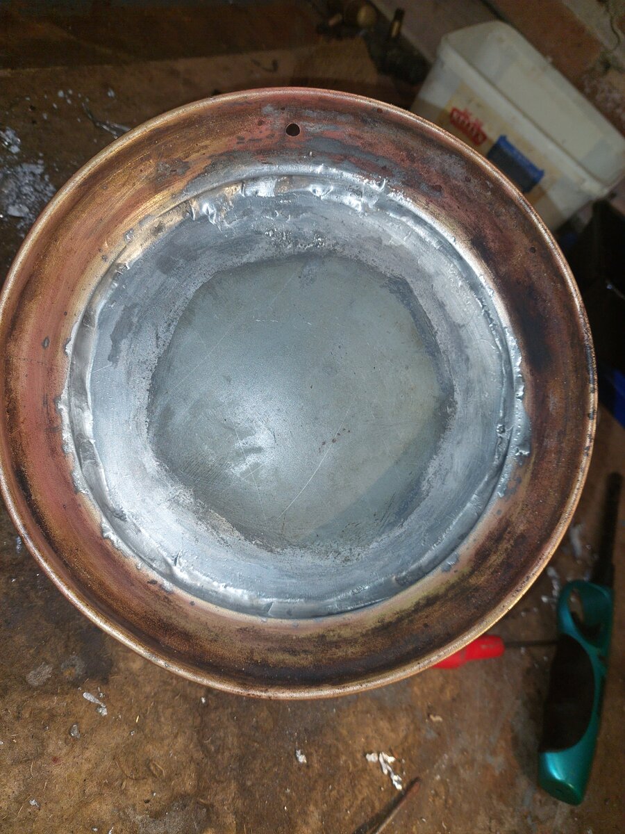

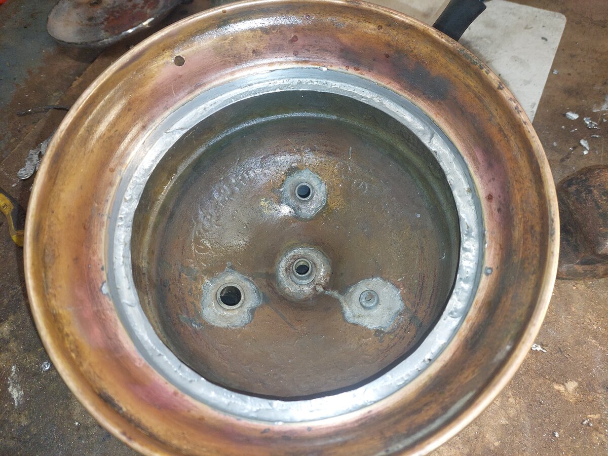

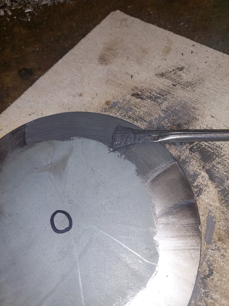

    After tinning the new steel base i soldered the new bottom in
    20231122_105225.jpg 20231122_112934.jpg 20231122_113412.jpg 20231122_132816.jpg
    A new pipe was made to supply the fuel from the tank to the burner tap
    Burner was cleaned and fixed tho it was just clean the filter and a new pricker installing.
    i tested the tank with pressure all seemed well but decided to put a POR15 liner in it to future proof it somewhat from leaks.
    I have only just started using this stuff always soldered any leaks but i still solder leaks and the use a liner on these petrol lamps.
    20240123_134504.jpg 20240123_134516.jpg 20240123_134540.jpg 20240123_140350.jpg 20240123_140356.jpg

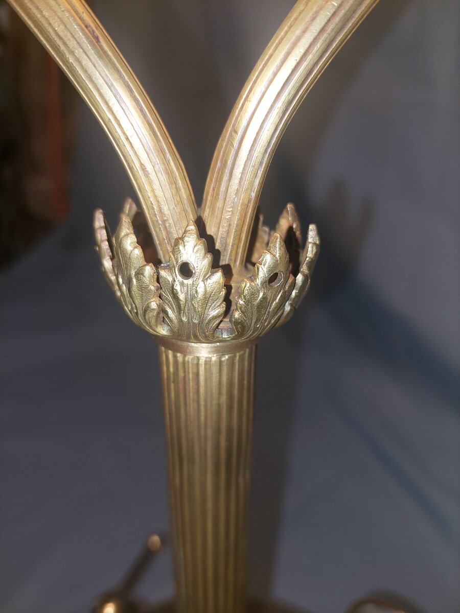

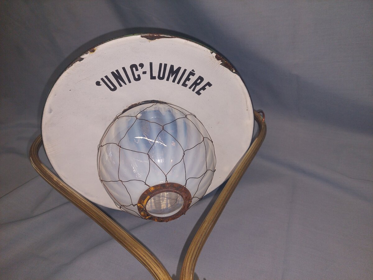

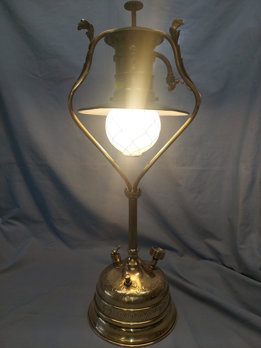

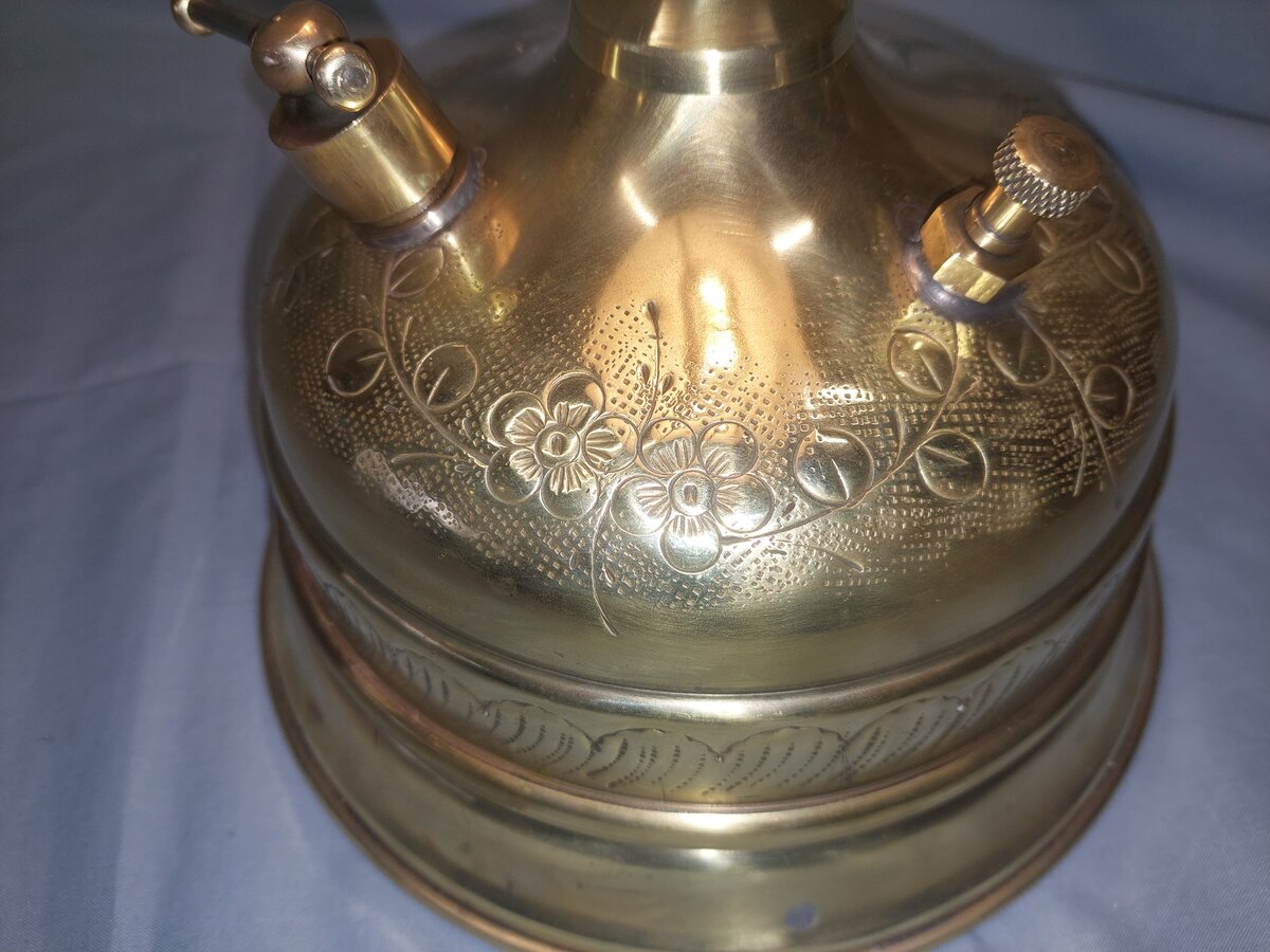

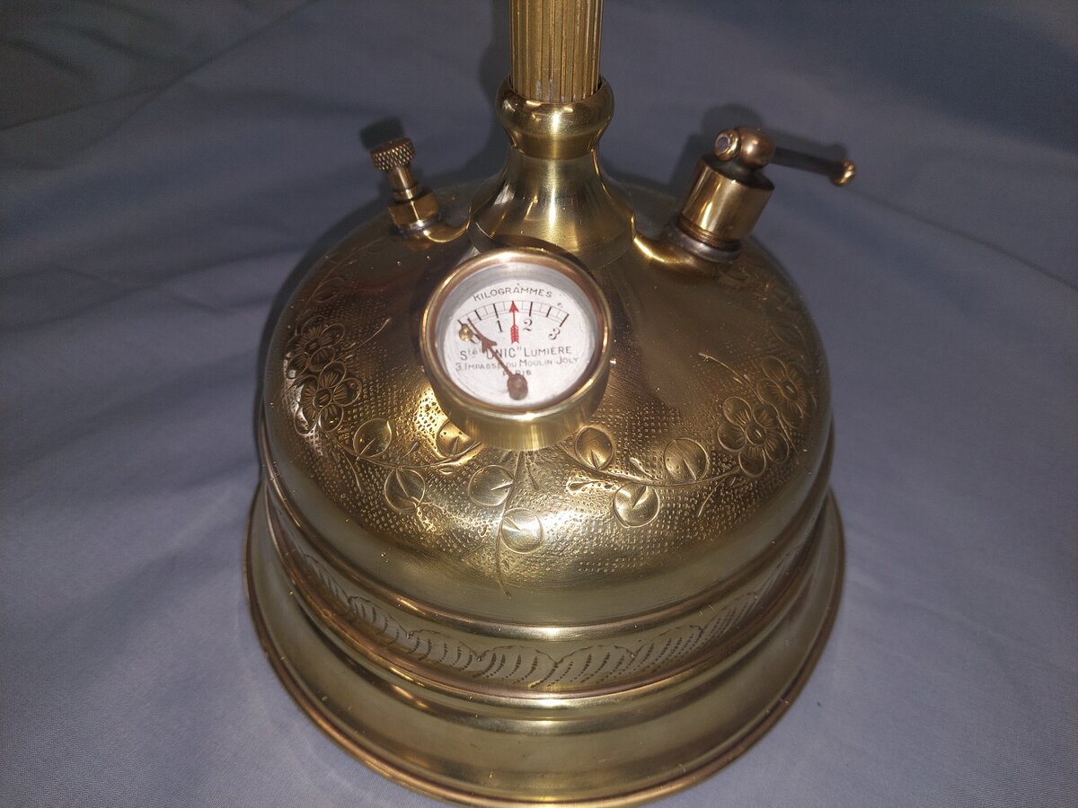

    I really like this lamp nice size lots of nice details
    20240123_140731.jpg 20240123_140720.jpg 20240123_140701.jpg 20240123_134417.jpg 20240123_134409.jpg 20240123_134706.jpg
    cheers pete

  5. presscall
    1,763
    Lancashire, UK
    @pete sav
    Another fettling triumph Pete.
    The fuel pickup pipe would have been soldered in place before the base pan was attached, so there’s a photo missing in the sequence I suppose? You’d then need to ensure that the lower end of the pickup was sufficiently above the base pan plus the eventual thickness of the POR-15.

  7. pete sav
    pete sav Founder Member
    Sep 7, 2010
    1,174
    West yorks

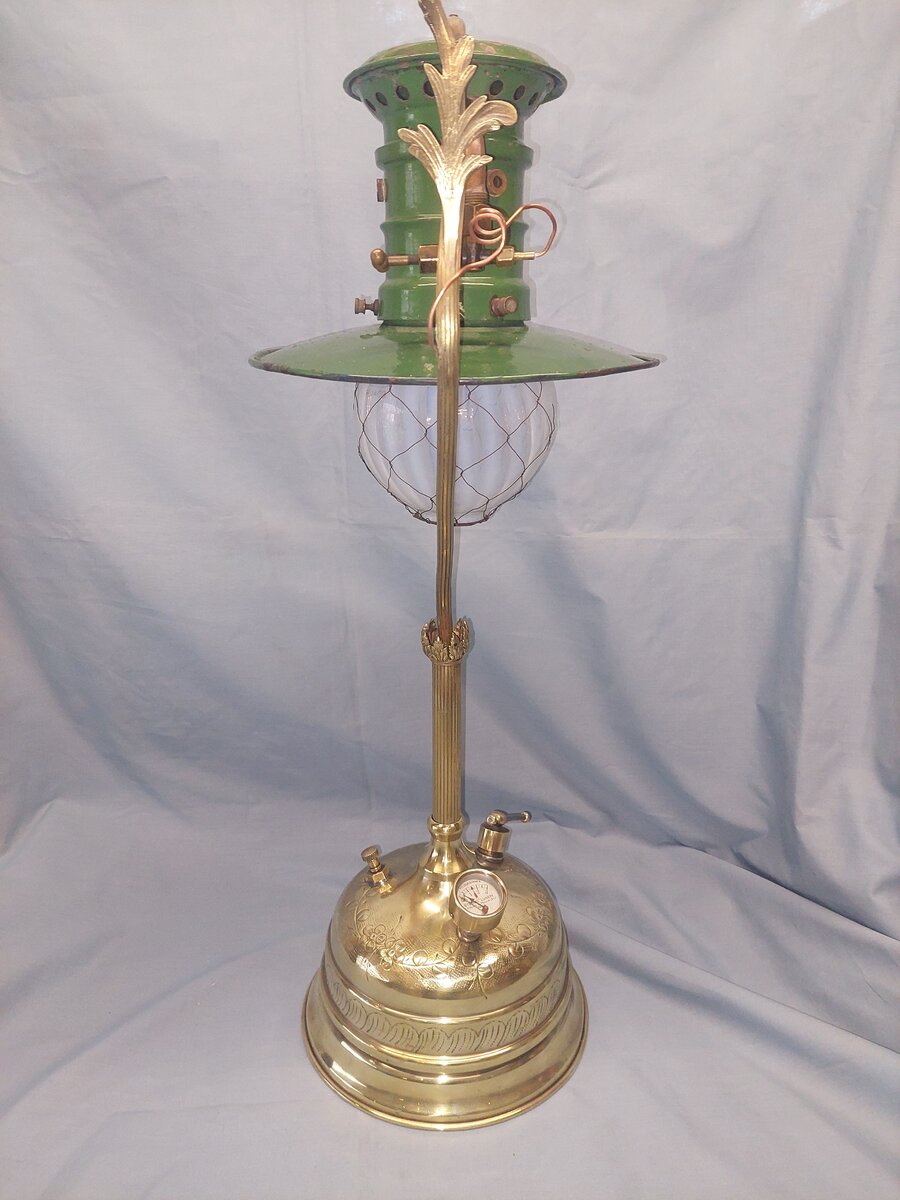

    @presscall
    Hi john the fuel pickup on most if not all the french lamps is different to what we normally see here.
    a 5mm pipe goes from the bottom of the tank into the upright handle bit soldered at the bottom.
    this in turn inside the handle is soldered into 2mm pipe that runs up then thro the Y piece thro the arm to the stopcock ferrule compression joint as in this picture of another arm here
    cheers pete

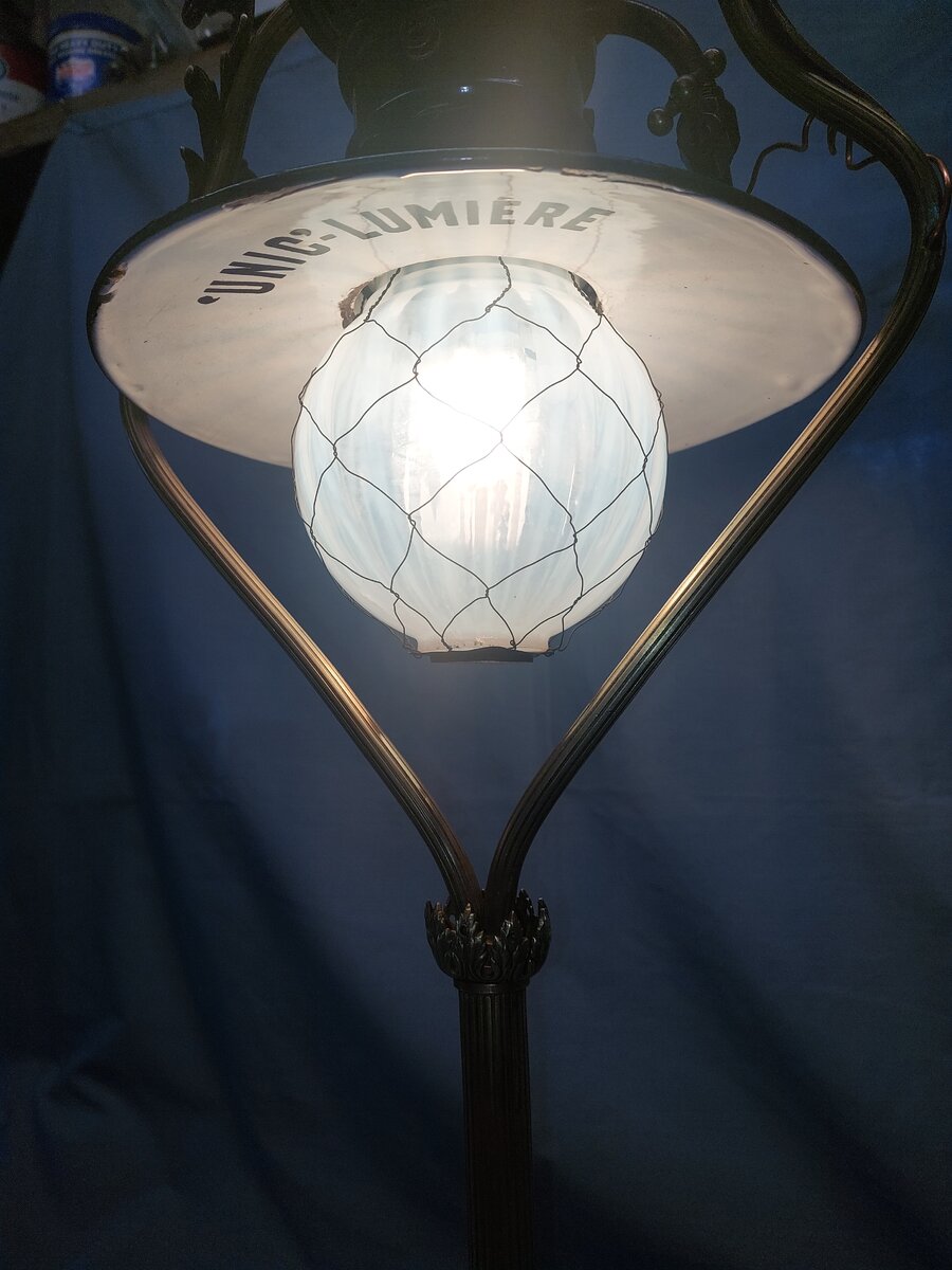

    Thanks lads it is nice to see it running again as its meant to
    Cheers pete
