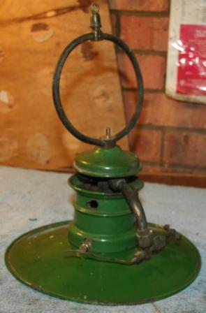

    Hi everyone i am in need of help with this unic lamp not sure what model number it is.
    Also need to find where i can get a glass for it and someone that could make me an air tube and burner.
    john

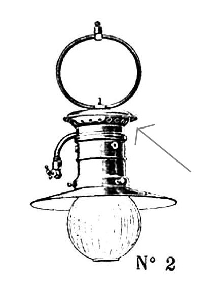

  2. Mackburner
    This is a Hollow wire Unic model 2 lamp with the 400cp burner. This is one of the models listed in the 1953 Haupois flyer but crossed out in 1963. It could therefore be made at any time from the 1930s to the mid 1950s. ::Neil::

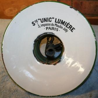

  3. Conny C
    Conny C Sweden Subscriber
    964
    Hi,
    You also need the vent part with holes, you can see on these Unic 9 lamps.
    Neil – according to Michel this Unic Lumiere “3 impasse Moulin Joly” must be before 1930, as the Rue Moulin Joly was opened from being a dead end street (impasse), to a street, in 1930. The G. Haupois we know of was situated on 5, Rue de Moulin-Joly!
    /Conny
  4. Mackburner
    Well that is handy information. It pushes the Unic brand back further than I thought. I supect this means that E Brodier was making and selling Unic product in the 1920s and that it is becoming very possible that Brodier took over from Liotard Aine after 1922 and before 1930. We are beginning to see the progression here. ::Neil::

  7. Michel
    Michel Subscriber
    Jan 26, 2011
    1,429
    56 France
    I am gently working at that project
  8. JEFF JOHNSON
    16,877
    Hello Michel, that's good news! :thumbup:
  9. Michel
    Michel Subscriber
    Jan 26, 2011
    1,429
    56 France
    Damned
    I could have looked and guessed this earlier : All my Unic embossed tank lamps have a manometer with "3, impasse du Moulin Joly". Therefore, they are pre1930.
    whilst my Unic 9 is marked "5, rue du Moulin Joly" or have no marking.
    Please guys, have a look at your lamp
    karli ; you have what i think to be a first (in fact a couple) model of unic 9
    tell me if i am right
    this don't help us in finding the date of the take over of Unic by G Haupois but i am quite sure all those embossed tanks are Brodier's production.

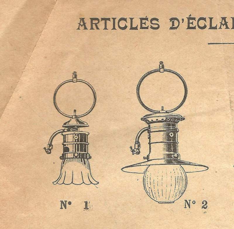

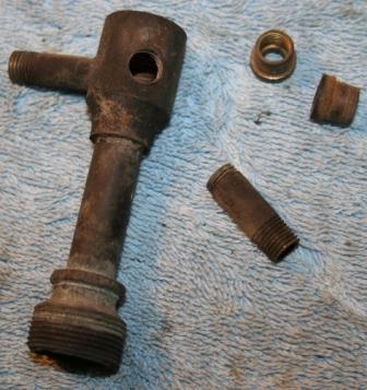

    Sorry Conny but you are wrong
    i discovered this morning that the n°1 burner has not the enameled ventilator on the top, therefore this burner is almost complet
  14. Conny C
    964
    Michel,
    As Neil did I saw this as a number 2 Unic hollow wire lamp. Obviously we were wrong, and as you now show us and claim this to be a Unic number 1 lamp, I could only agree with you.
    If the numbering also follow a timeline this ought to be one of the first lamps made of the Unic brand.
    /Conny
  15. Mackburner
    Oops. Only one out but it seems we were indeed wrong. You have to assume that number one is indeed early in the production. ::Neil::
