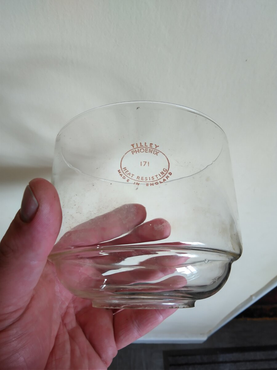

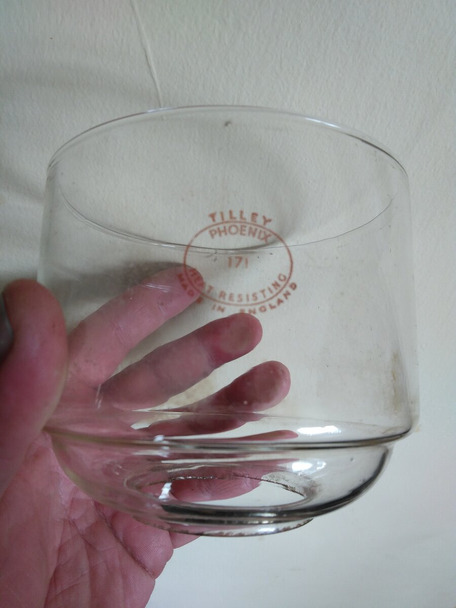

    Anyone ever seen a red stamped/etched tilley 171 glass? I personally have never seen a red one before. IMG_20210607_185031.jpg IMG_20210607_184949.jpg

    That is an older and longer 171 glass and they are not so common now and I do not recall if I have seen a red stamp before.
    11,057
    That’s a very good old Tilley 171. Phoenix made glass for different lantern brands including Aladdin (Australia).
    Edit: Phoenix made glasses for Buflam, Bialaddin, Handi and Petromax… maybe more.

    I think I have two red stamped Phoenix Tilley glasses.
    A 182 globe on a pl53 and a deep dish 171 on a pork pie lantern.
    I have always assumed Phoenix to have supplied Tilley for a short while in the 1940's based on these two and nothing else.
    As I type this I am pretty sure the veritas branded glass in my 350 is also Phoenix but I would have to check that.

    Cool I have never seen a red stamped globe before, keep it safe.
