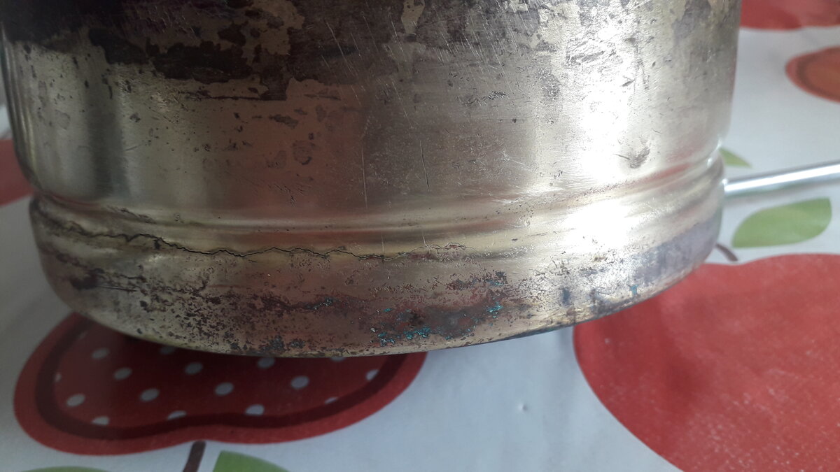

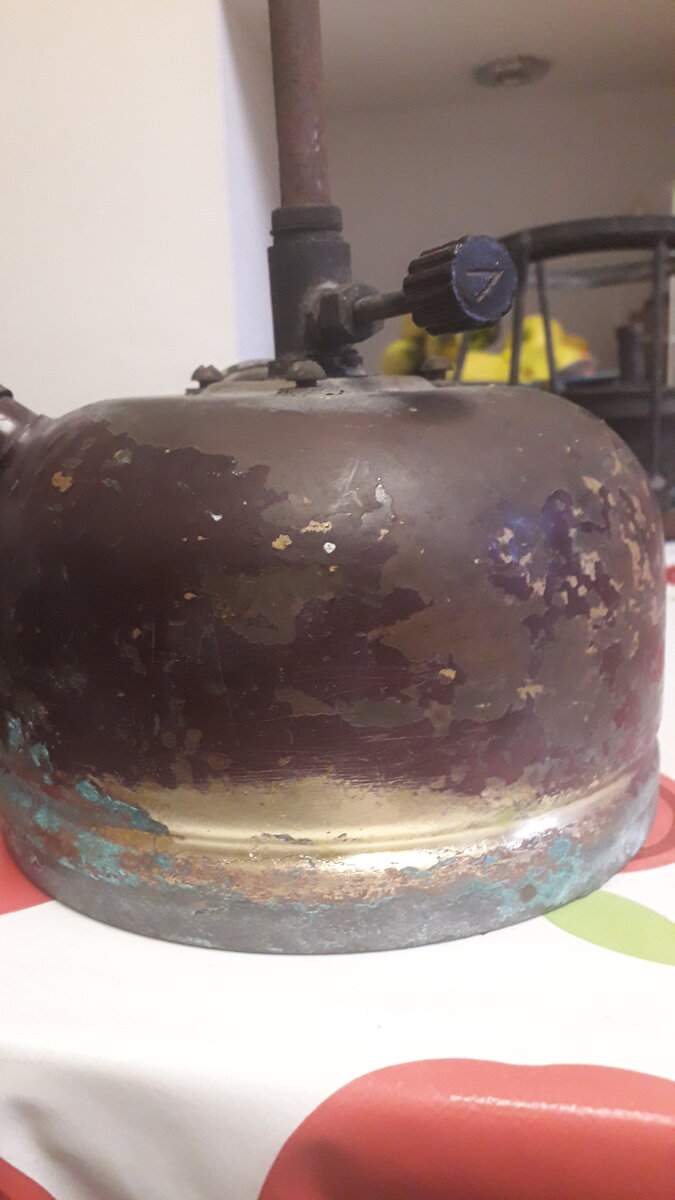

    I've recently acquired a Vapalux 300x, but the fount has a crank. I plan on doing a repair on it to enable me to do a full restoration on it.
    I guess this is just one of those things that well all end up dealing with at some time or another. I'll keep you posted

    That’s a doozy of a crack, quite bizarre.
    Usually cracks, stress cracks, run vertically up through the fount’s wall.
    Good luck with this one, please keep us posted on this one.

    It certainly is and most unusual for an early VAPALUX of any persuasion.
    @Gareth Shepherd ; have you formulated a plan of attack ?

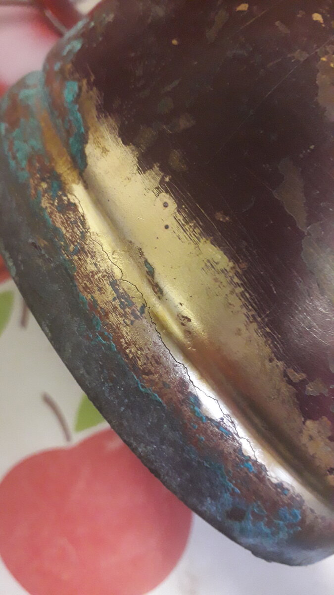

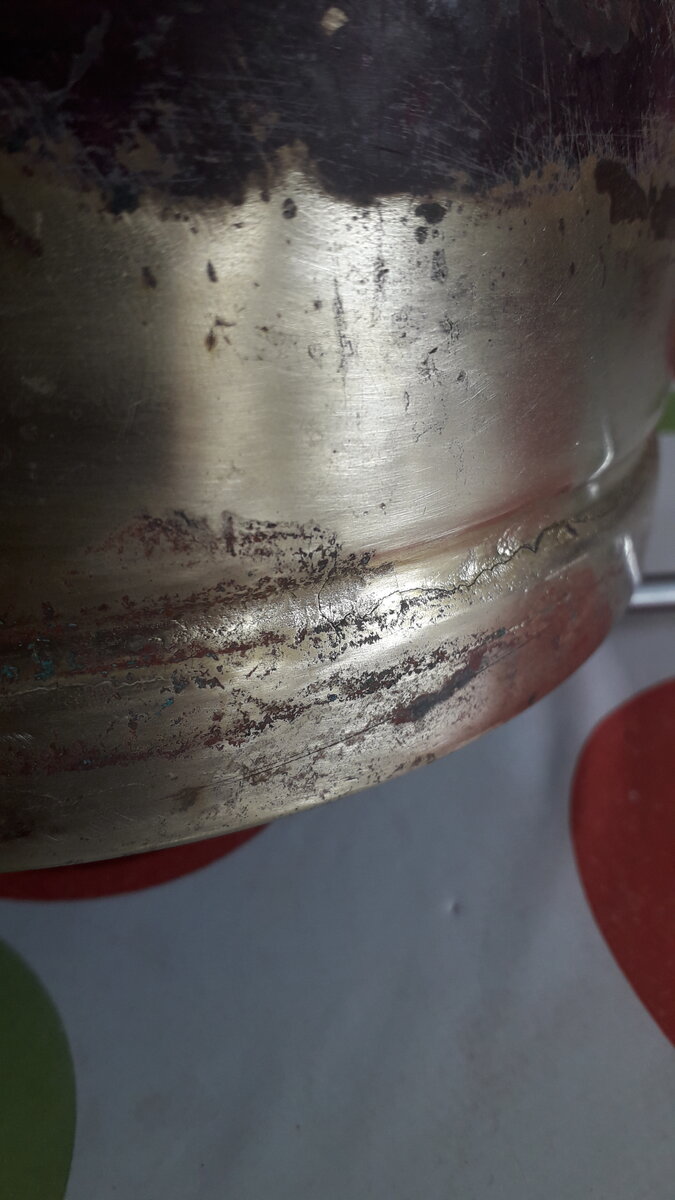

    I've had a morning stripping the paint off the fount. Here are the results...
    That's the same crack from beginning to end. It only leaks air from one side of the first picture.
    So now I've seen the damage, the plan of attack is that similar to the link that @JEFF JOHNSON provided.
    Create a little groove along the crack, fill with solder and finish flush.
    I'll keep you posted, wish me luck

    That's definitely the way to go. Good luck.
