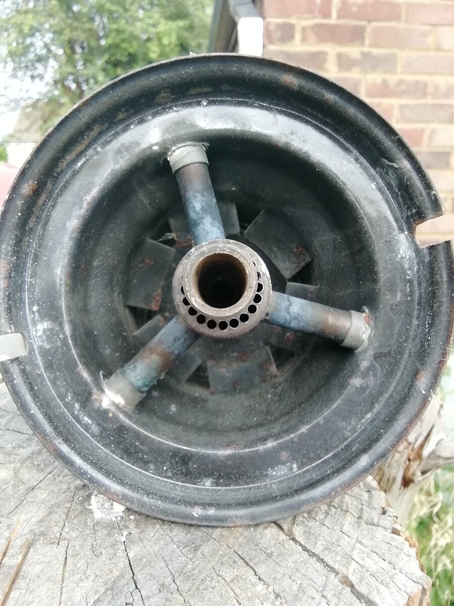

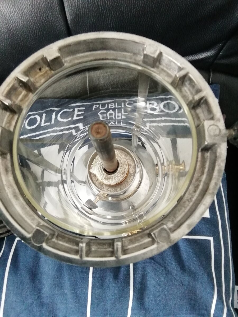

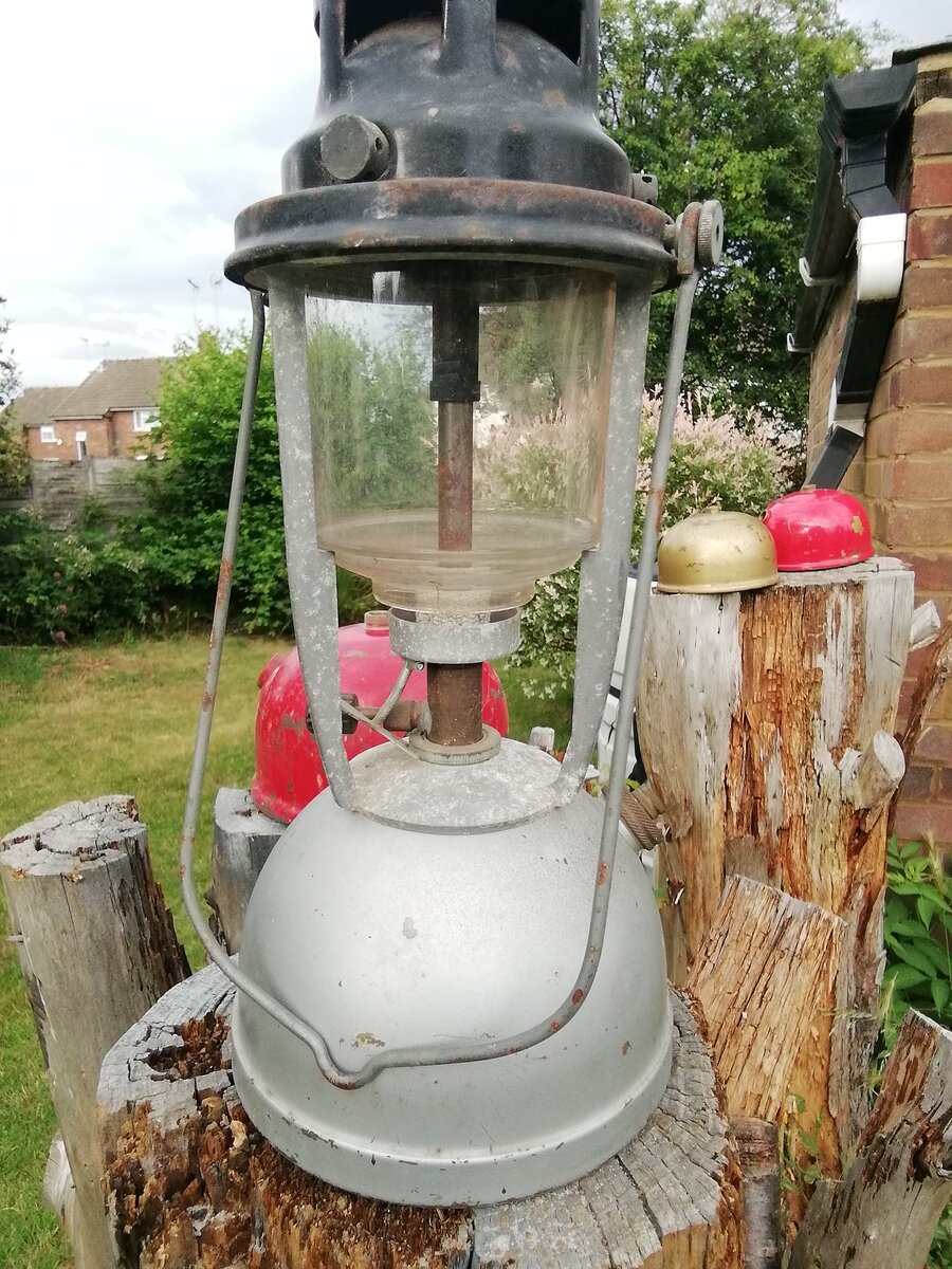

    I received this lamp probably about a year ago now .
    The seller told me that a old man had had it for a very long time and it was rediscovered in the loft of the mans house after the water tank leaked and everything had to be removed for the repairs ,so the lamp received a little water damage.

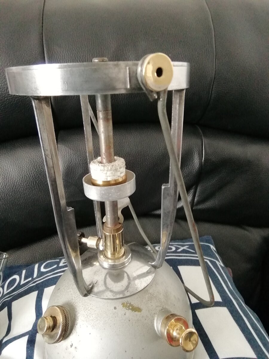

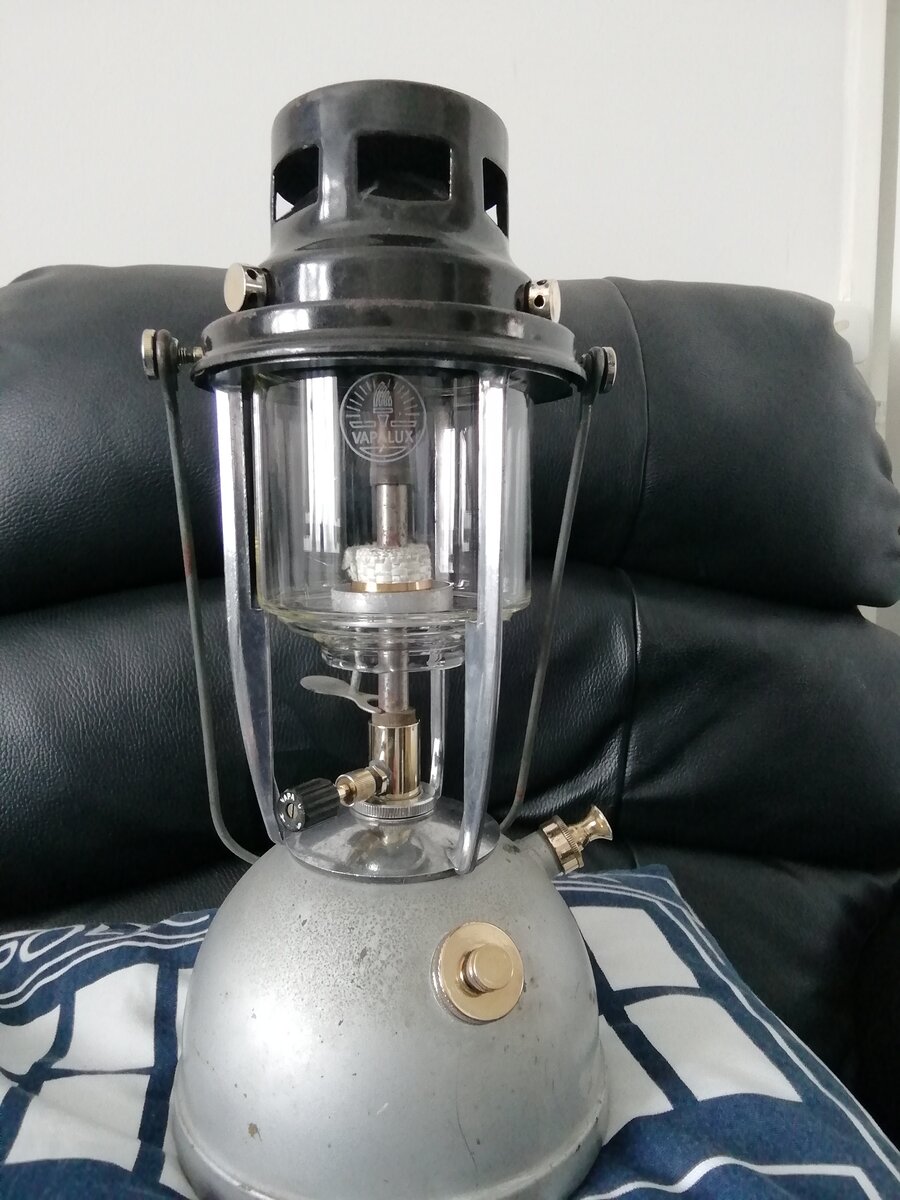

    I used my rotary tool with the brass brushes to remove the dazz from the frame ,I then used some polishing compound with the rotary tool and a buffing mop ,there are still a few blemishes but I'm happy with the results .

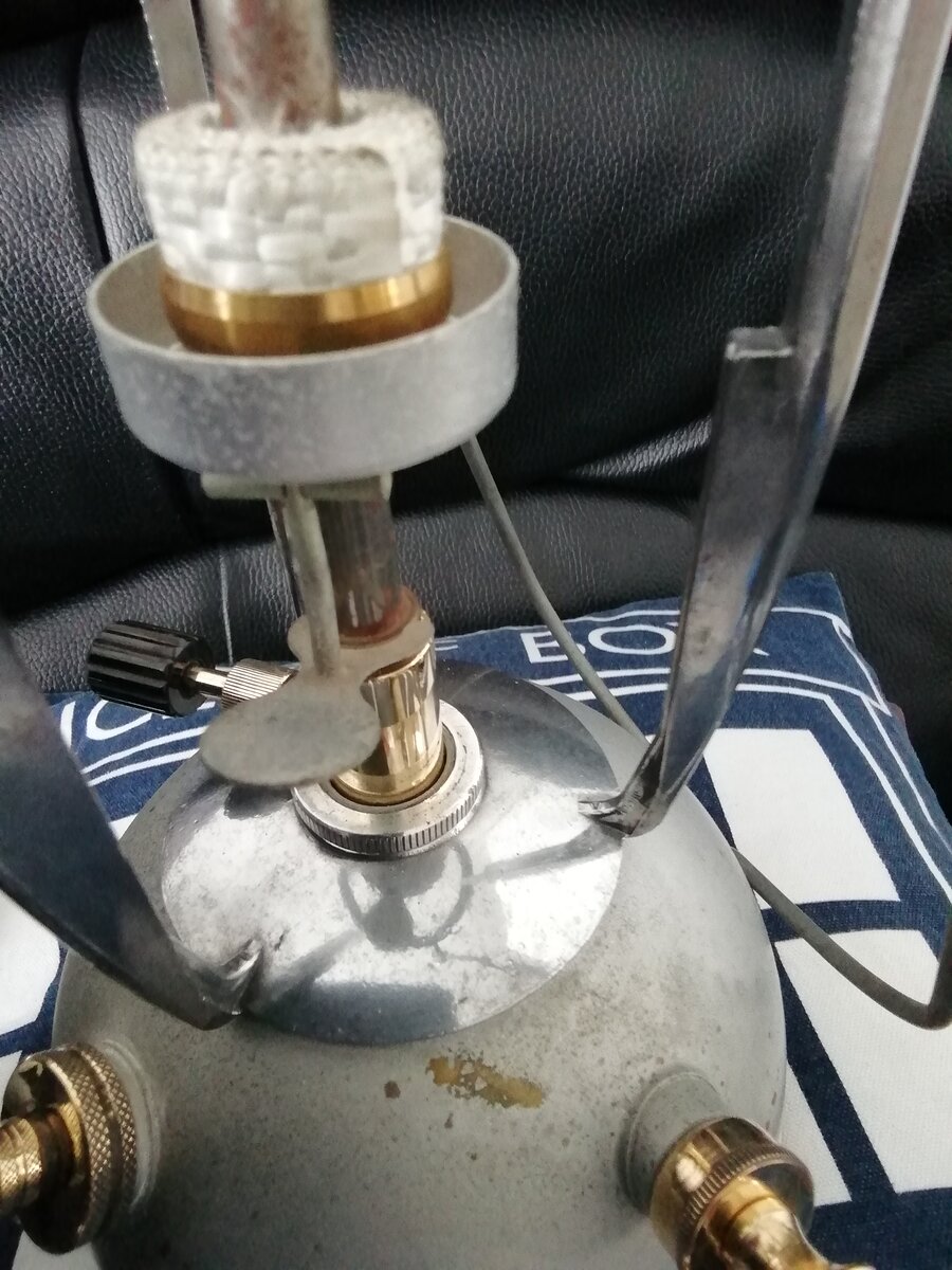

    The filler cap ,pump and control cock all had paint missing so I gave those a gentle going with the brass brush as I didn't want a full on shine to the brass.

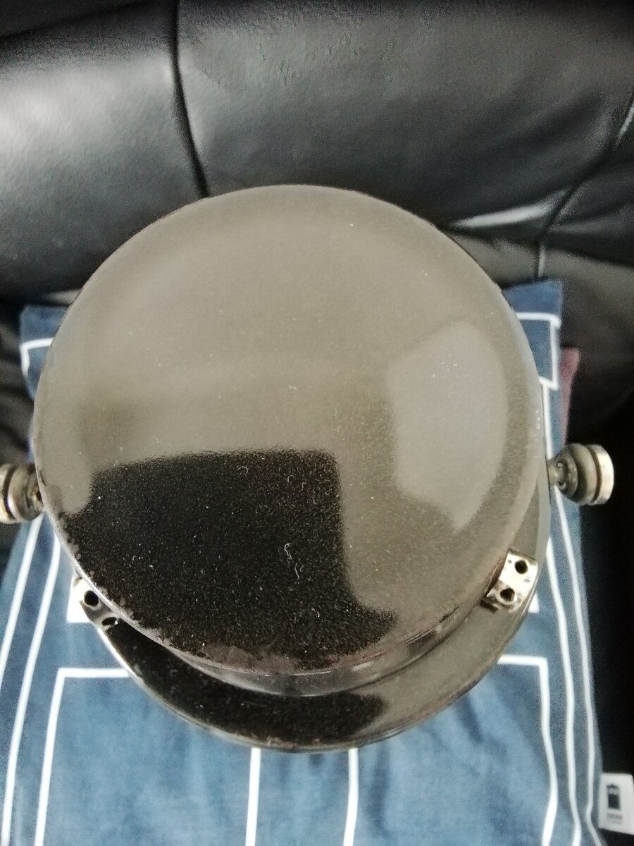

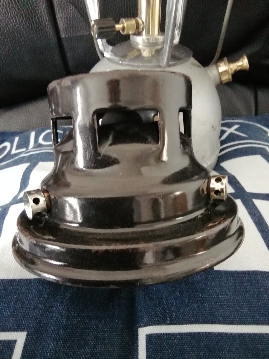

    The hood was in very good condition and a little brasso and elbow grease worked great on that .
    I replaced the pre heater wick with a new wick but neglected to polish the alloy heater cup, oops .
    The tank got a warm soapy water bath and a gentle wipe over with a sponge to get the dust and oil off it then had a soaking with some turtle Wax and gently worked into the paint .

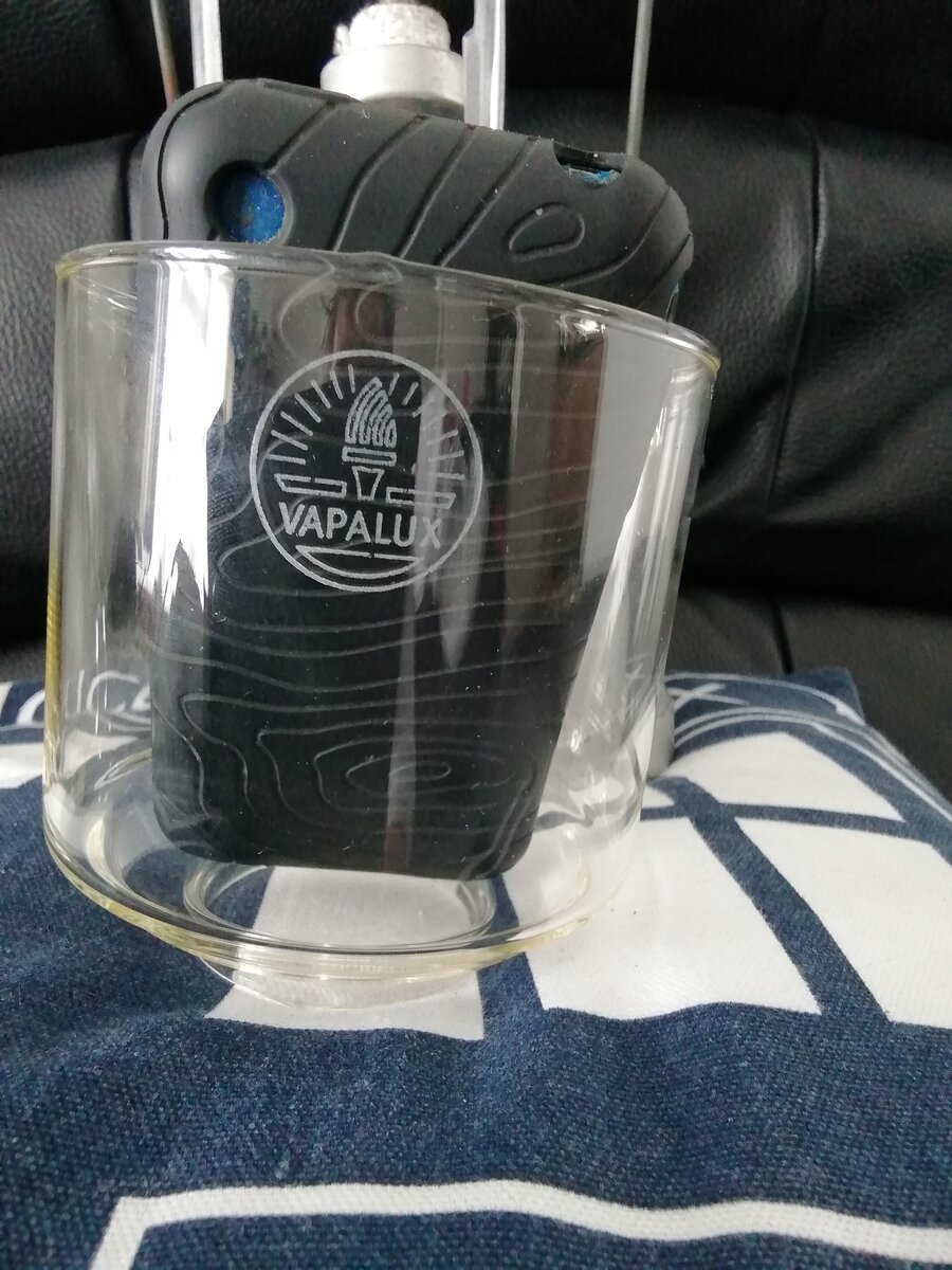

    The glass is clear as a bell once all the dust was washed off and the bialaddin logo is very clear .
    Here are some before and after shots .
