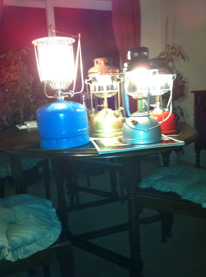

    Anyway - here's my collection. This taken last year during one of the frequent power cuts we have! Very useful to have a stock of pressure lamps. Plus a couple of Trangia cookers, one of which is 40 years old, and both of which are running on gas. And a 15 year old MSR Whisperlite Internationale which runs on Aspen.
    With the exception of the Gaz lamp, all of them were un-fired when I acquired them over the years, even the gold Trangia, which I got 15 years ago! The red one came from a Civil Defense store in Stirling which was closing, about 20 years back. The Vapalux was bought a couple of years ago on the Bay.
