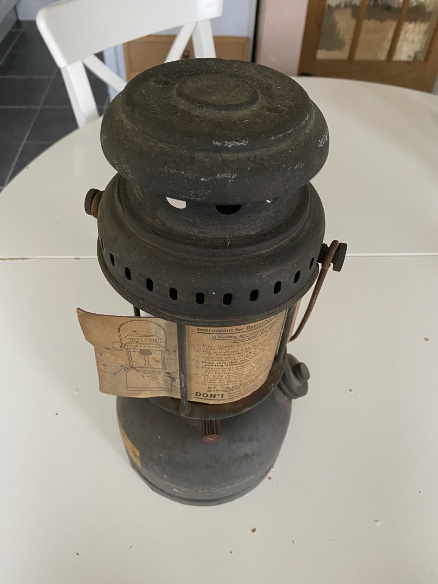

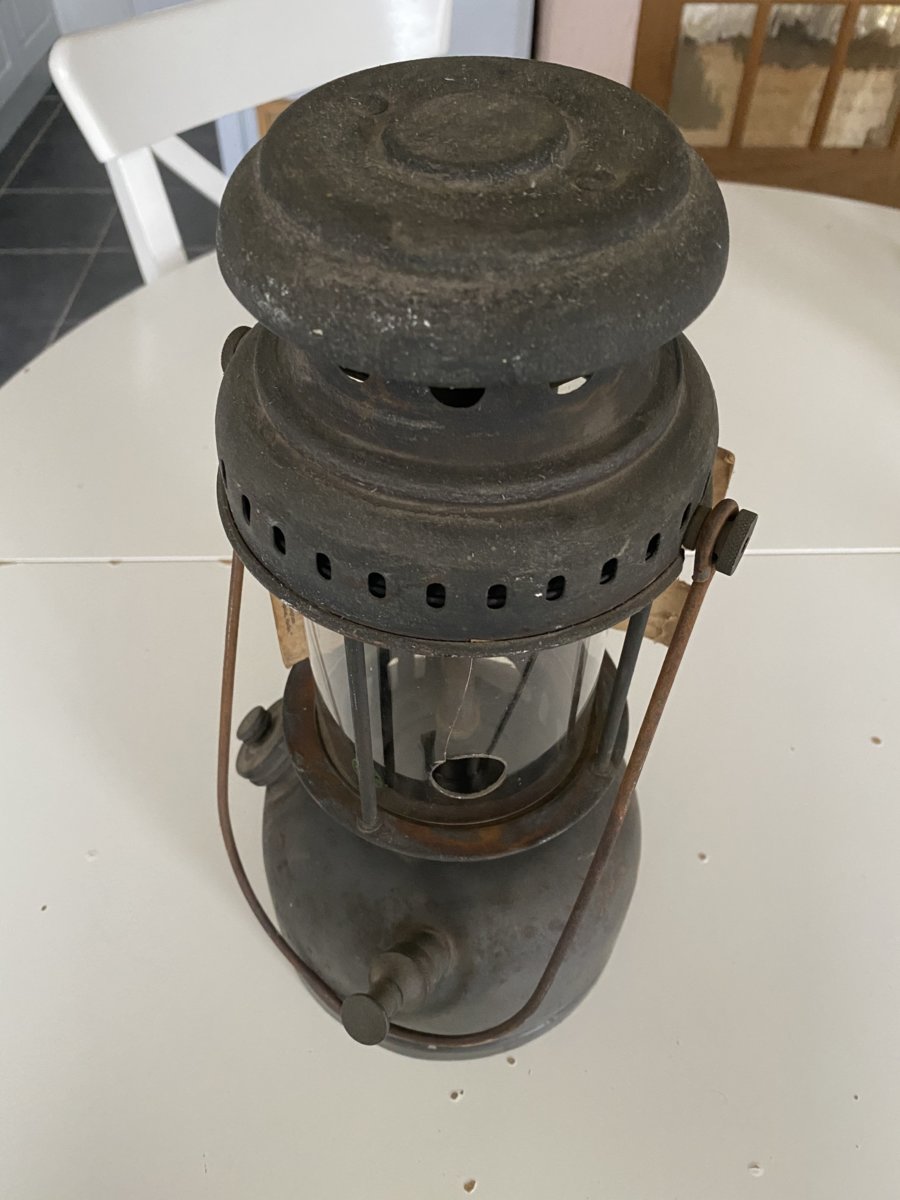

    As per the title I would just like to know more about the lamp I have. I have no idea about these lamps, the one I have has been gathering dust under my stairs for well over 20+ years. I acquired it when a local authority stores was having a clear out. Looking on the threads there are several different E41’s but don’t know which mine is. The only reason I know what make and model it is, is the operating instruction sheet. It looks as though it has original grey paint on it but some of it looks brass and was thinking of polishing it. Would that be detrimental to it?

  2. Mackburner
    Well it's an E41 for sure but there are more than several variations. A few years back at Newark we identified 14 variations and there could be more. They are perhaps not as common as the pile of 30 plus we assembled at Newark might suggest but they are out there and much sought after. They all date from about 1940 to 1944 ish and W&B just assembled with what parts were at hand. I never did list all the variations because a lot were just different colours and top cap shapes. It is enough to call it an E41 and I wouldn't worry about which one. ::Neil::

    Thanks Neil
    On the top (sorry don’t know the correct name) I can just make out the initials AM and what looks like a crown if that makes any difference.
    Would it cause an problems cleaning it up and polishing it, I’m a little wary about doing anything to it that might reduce its value in the long term ?

  4. paul m
    paul m Subscriber
    764
    lancashire. UK
    Nice original lamp, AM is Air Ministry, war time, take care of the glass, should do harm polishing it, will probably increase the value ...
  5. Mackburner
    That Air Ministry crown is sometimes found on those brass tops. Comes on the 300 models as well. Cleaning and polishing won't hurt the value but if you use the lamp the brass hood will just go black again in time. ::Neil::
