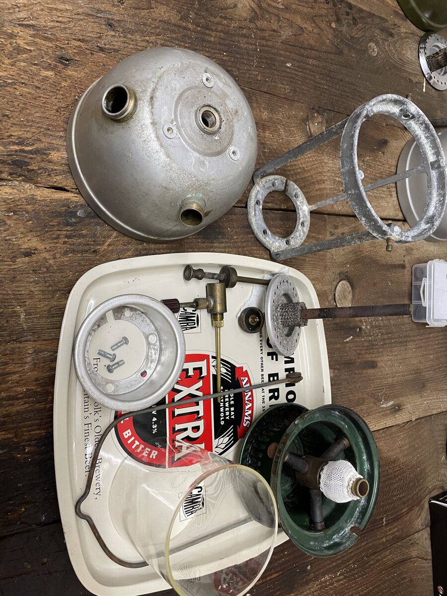

    Still a work in progress.

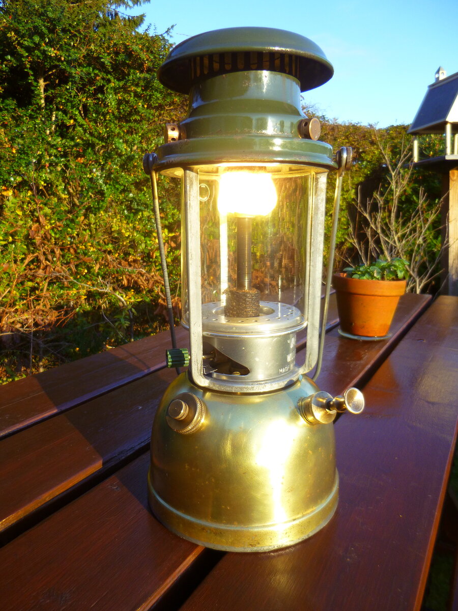

    Thanks, I'm impressed with the light output and I hope to return it to Army green at a later date.

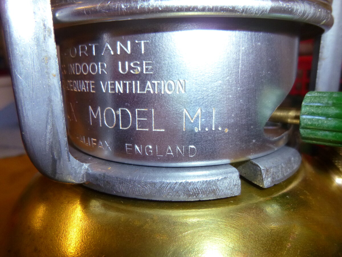

    What year is it?
  7. mauld United Kingdom
    Dec 12, 2021
    51
    Edinburgh
    No Year, Just MODEL M.1.

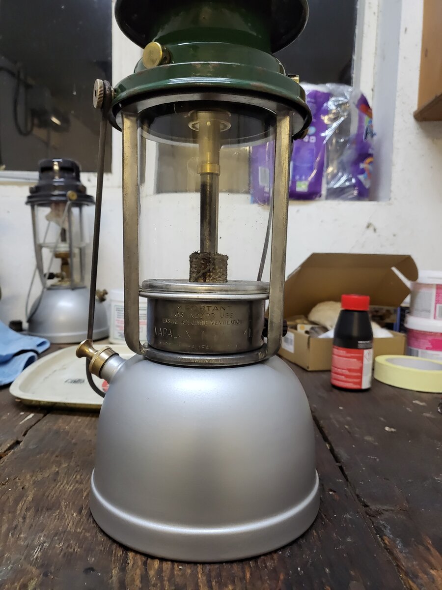

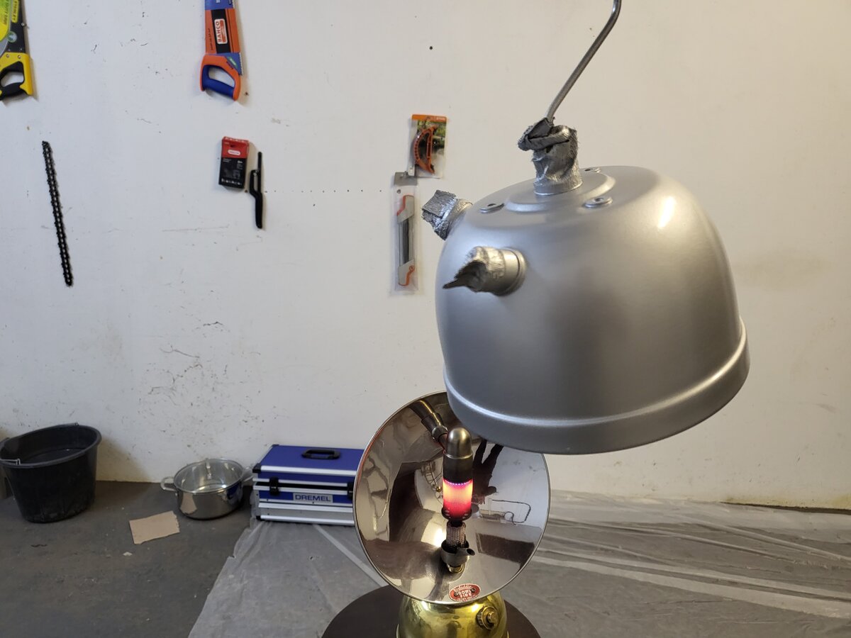

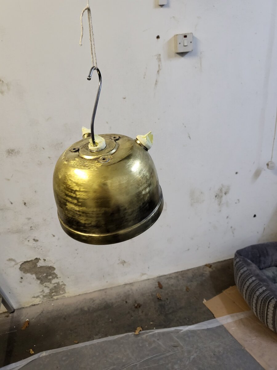

    I rubbed an M1 down in the Autumn. Back to brass and used Hammerite 5084785 Metal Paint: Smooth Silver. It is a good match for the silver fonts. I used Hycote XUK435 Petrol Resistant Lacquer Spray. I believe all M1s were silver.
    This is before
    Couple of during:
    and nearly finished (collar and glass not cleaned yet): but you can see the silver came out well to its original state.
