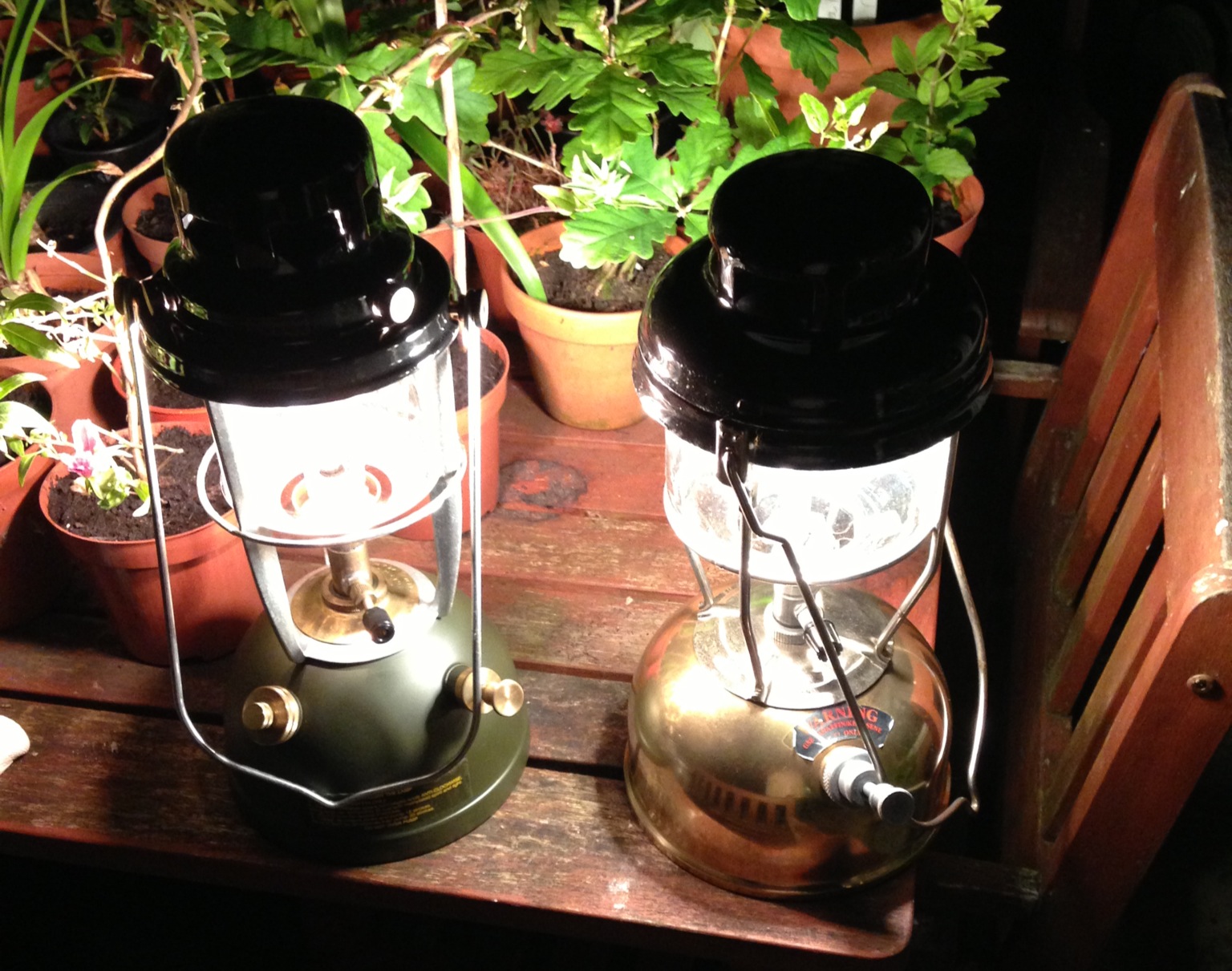

    I'm pretty pleased! The Vapalux gives a good account of itself against my Tilley 500 series. The light from the Vapalux is slightly yellow/pink compared to the Tilley's greenish tinge.
    I like the Vapalux and will be on the lookout for more...

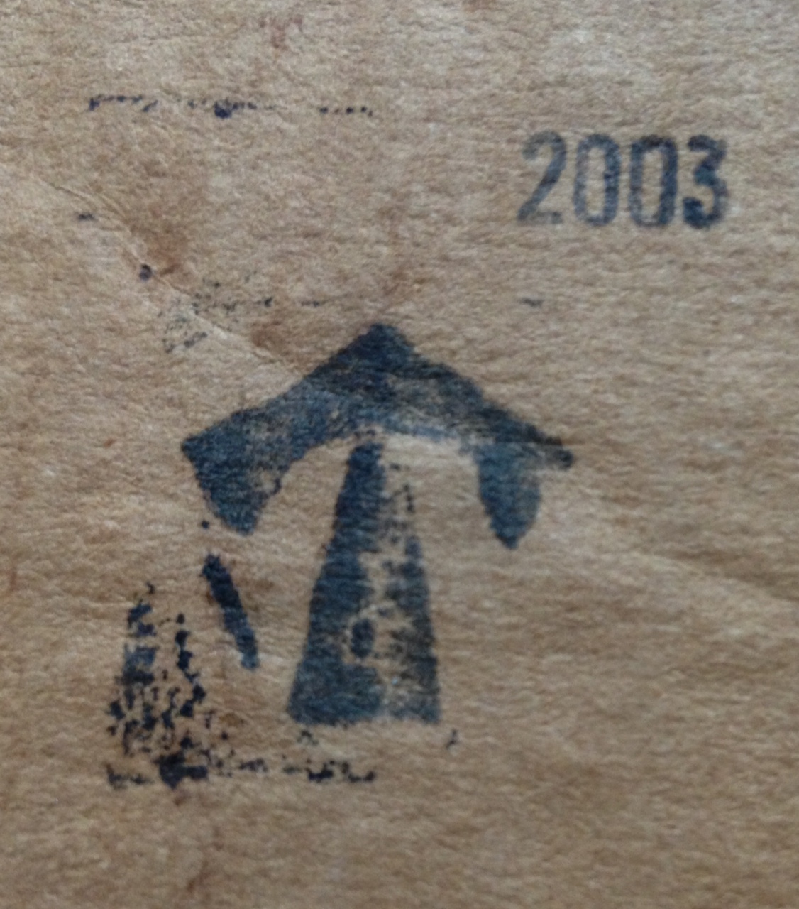

    It seems to be a military one and of a quit resent manufacture.
    If you look at the collar a bow the tank you will probably see the manufacturing date.

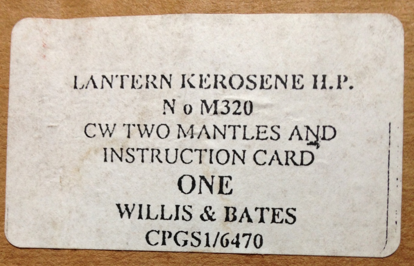

    Yes, the date of manufacture is 2003 and it was obviously made for the military, with the olive green colour scheme and pheon (broad arrow) markings.

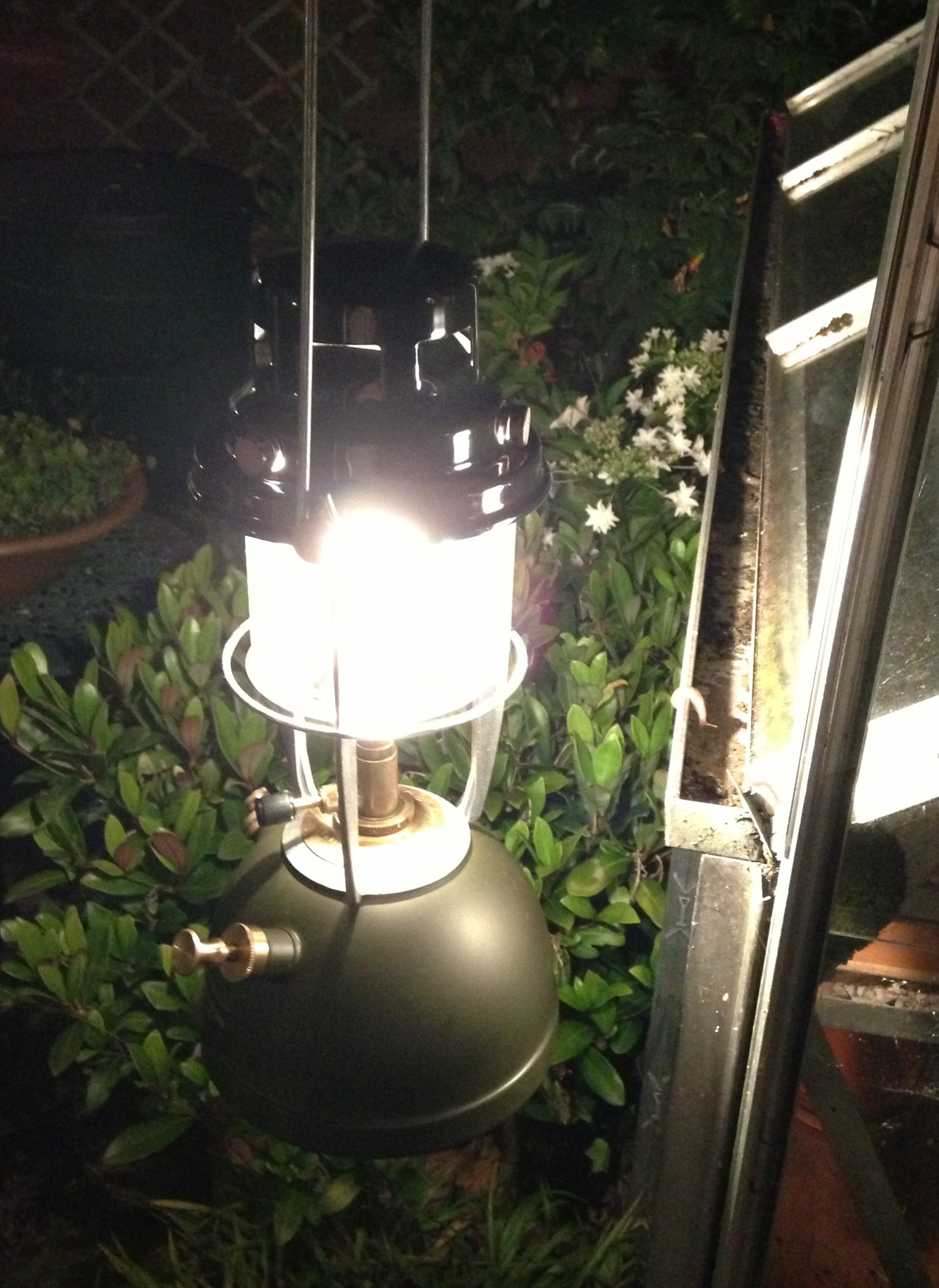

    I discovered tonight that if you follow the Vapalux mantle fitting instructions and unscrew the spigot first, it's possible carefully to thread the spigot through a Tilley Happy Mantle, replace the spigot then slip the metal ring round the burner without too much difficulty. However I think the Happy Mantle weave is a bit coarser than the proper Vapalux one and it's not so evenly incandescent all the way round.

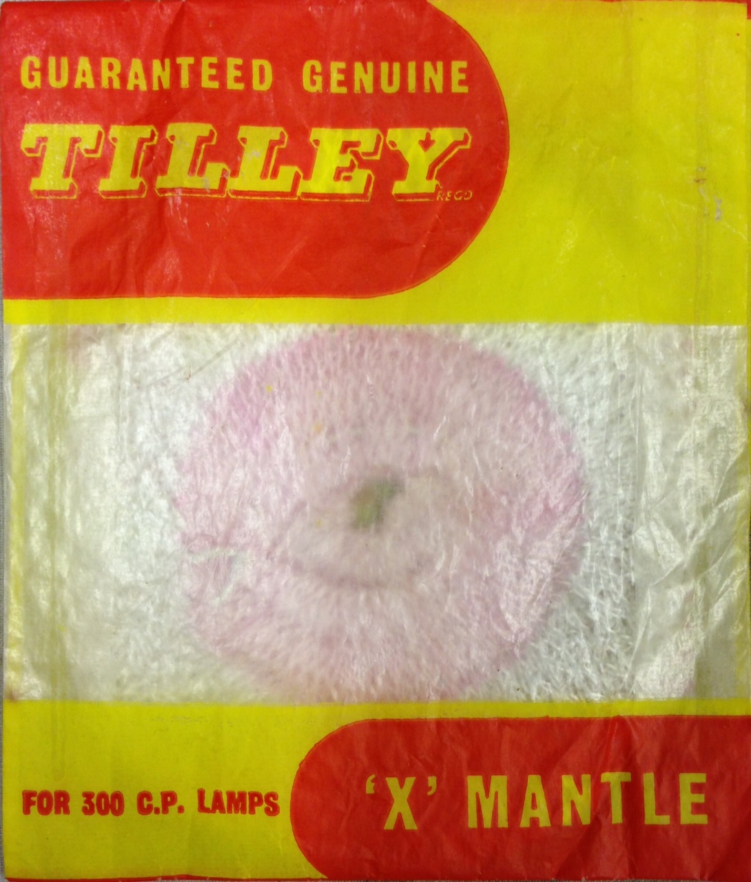

    Thanks for the advice. I'm probably not classed as an 'advanced user' and haven't tried tying my own mantles, but I have experimented with numerous different types of Tilley mantle with differing results. Most types work okay, but the best in terms of brightness are some old stock Tilley X mantles shown in the second photo. I have come to the conclusion that, all other things being equal, a pressure lamp's light output performance depends largely on the mantle.
    Whilst the Vapalux puts out a perfectly good bright light when fitted with a Happy Mantle, there is a small patch on the mantle that's not fully lit. To be honest, that mantle was old stock and the metal ring had gone a bit rusty (as they do) and some of the rust had got onto the fabric. I also think I stretched the fabric during fitting. Never mind, it's good enough for now till the proper Vapalux ones arrive. And yes, I've noticed that the light has got brighter since the lamp was lit about 20 minutes ago.

    1405289621-Vapalux_with_happy_mantle.JPG 1405289638-Tilley_X_mantle_yellow-red.JPG
