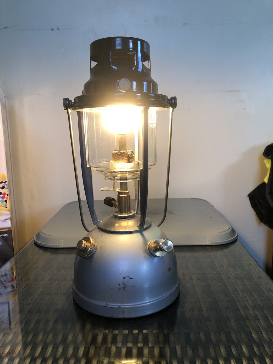

I’m looking for some guidance regarding an M320 I have which won’t stay lit. I have replaced all the seals and there doesn’t appear to be any leaks that I can detect and the lamp fires up ok but despite giving it 30 pumps it won’t stay lit for any more than 3 or 4 minutes. As this is only the second lamp I have worked on I don’t have the experience or confidence to say for definite what the issue might be although I would suspect the vaporiser may be at fault.
How does it not stay lit: does it peter out? Does the lamp light up again after pumping? Are you sure you have an airtight lamp? A definite check on leaks is dunking the pressured tank in water. Also, make sure the needle is fully down when operating the lamp.
Hi, yes it starts pulsing after a couple of minutes and then if left will just go out. If you start to pump it does light up again but only stays bright for a short time. I have checked and can’t find any leaks and the needle is fully down. It may be that I need to start the process all over again as maybe I have missed something
Hi @stuartc , Have you tried more pressure?... 30 pumps is ok for the start up but you need to get the lamp up to working pressure..
Ok I can try that thanks, but would it be normal for the pressure of 30 pumps to only last such a short time
Fine looking 320 there! Have you checked the filler cap washer? One of mine did that when I first started. They can let a lot of pressure out with a dodgy seal. That washer can let pressure out without making a paraffin mess.
It is all good advice, Stuart. Drain out the fuel and do a 'dunk test', then you can rule out a leak? One thing at a time an you'll get it sorted
Thank you @Johnny19 I can certainly have another look at the filler but as you point out there was no paraffin leak visible
Except it sounds as if you have an air leak from the tank somewhere. Do a dunk test as has been suggested. Or, if you prefer, pressure up the lantern and paint soapy water onto the various unions - filler cap, pressure release and jet cleaner washers...
Hi David, definitely losing pressure somewhere so tomorrow will do a dunk and hopefully get to the bottom of it. Thanks to everyone for their help and I’ll let you know how it goes
Yes ... pressure test ...but you may find that the culprit could be the NR Valve in the bottom of the pump tube . needs to be sorted ... get your sturdy screwdriver out ... check it out... take it apart ,, be careful ...grit inside or sticking with a substance clean maybe ? .... bit of light grease on the thread seal with a new washer ,, check all the washers and the fuel cap seals ... these lamps are solid .. I have a couple of them and usually the NRV is the little blighter responsible followed by the fuel cap seals . good luck
Hi folks, just a quick update and a big thanks for all the help. Did a dunk test this morning and the air release washer turned out to be the culprit . One replacement washer later and the lamp is all good. Thanks again
no I managed to keep it in one piece thankfully. The help offered on here is fantastic and I'm sure it encourages others like myself who are complete novices to persevere and continue with a great hobby / pastime / obsession (delete as appropriate!!)
It's helped me out a lot too, over the last couple of years. Again thats a nice 320 You have there. I love the hoods on them.
