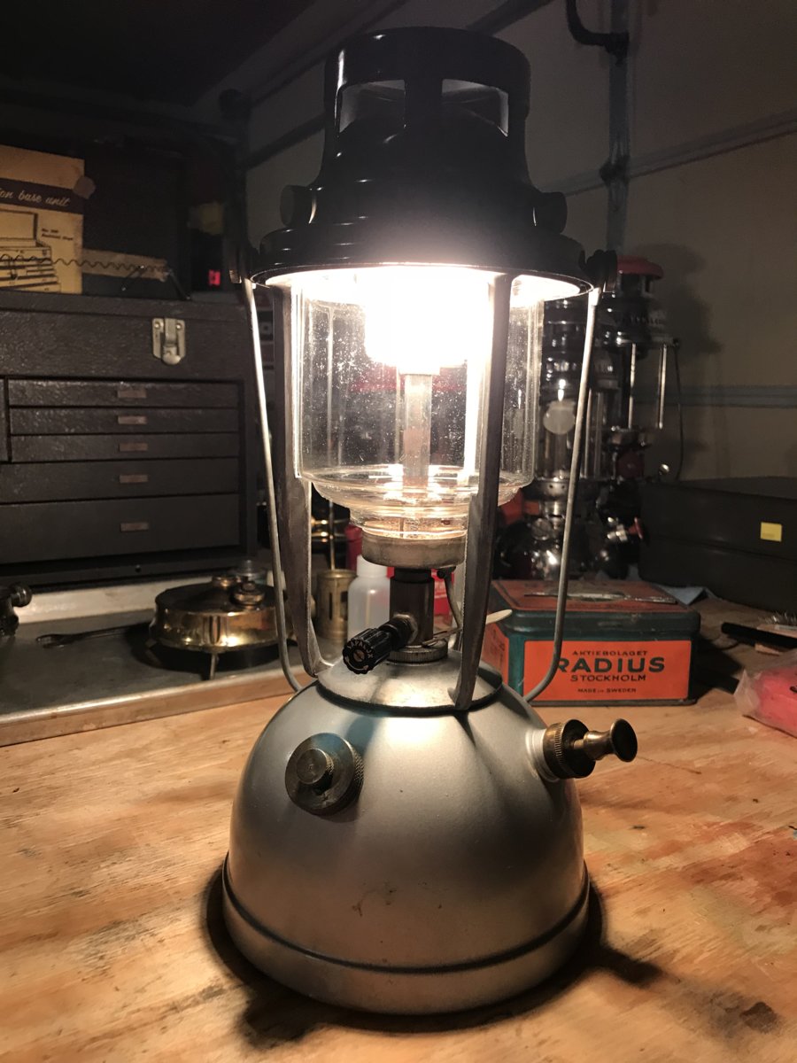

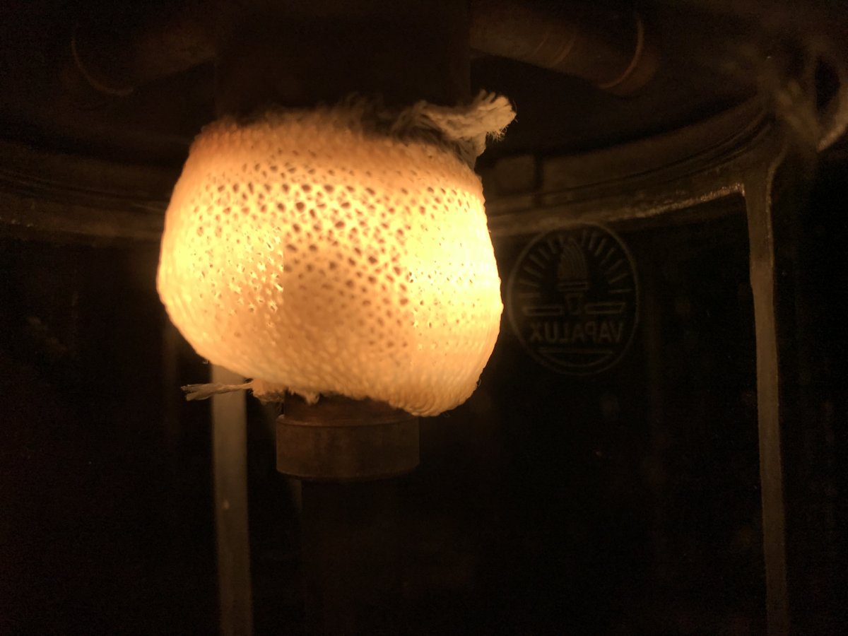

    Hi Guys,
    To date I have not been too successful in obtaining a nicely shapen mantle on my Vapalux 320. I have looked through the forums somewhat but have not been able to put a finger on my issue. The mantles seem to operate perfectly and give great light output, only the shape appears to be odd. I am using mantles obtained from BC. Am I doing something wrong?
    Any advice would be appreciated...
    Best Regards,
    Scott

    Well, I tried out your method tonight David...worked out perfectly...Trevor can stand down for now =; :)
    Thank you for the advice, much appreciated
