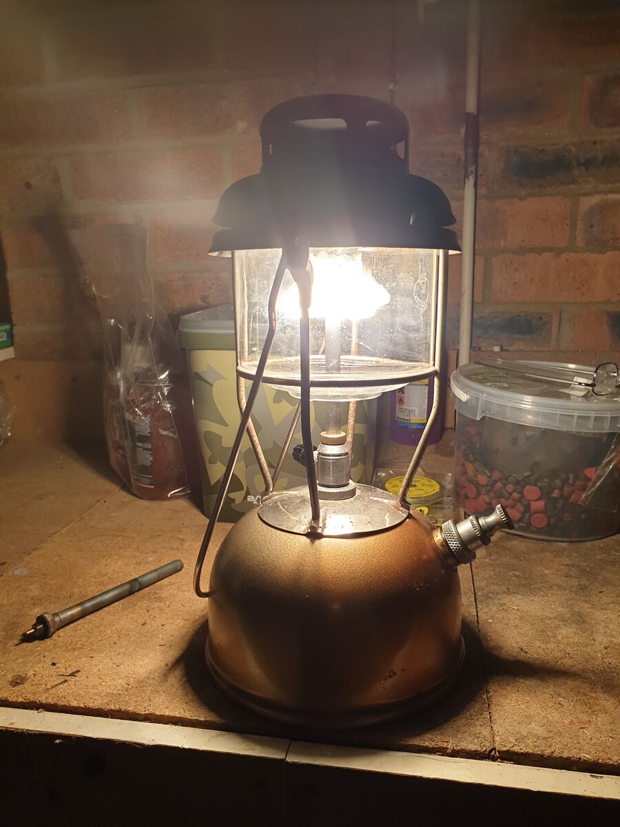

    I bought my Tilley lamp (X246B) before Christmas and had a problem with it burning outside the mantle. I did manage to solve this by heating and quenching the vapriser but having done so I figured I ought to get a spare just in case. I duly ordered a new vaporiser from Tilley.
    The new vaporiser turned up very quickly but, when I first tried it, the light was orange and the corona outside the mantle was worse than even when had I first bought the lamp. I fired off an email to Tilley and was thrilled that they immediately sent out another new vaporiser. I was less thrilled when this had the same issue. Long story short, I discussed the issue with the lovely ladies at Tilley, and pointed out that the needle was a couple of mm longer than the old, working one, and eventually got another vaporiser that does work. So, 8 weeks, plus several phone calls, later the problem has been resolved and I have a working vaporiser. All good then...
    However, in the mean time I also ordered a Korean vaporiser as I wasn't sure if I would ever get a working one from Tilley. This Korean vaporiser turned up today (about 6 weeks after ordering) and out of the packet it just works, first time. No trimming of the needle required.
    My conclusion is that the service from Tilley is wonderful but the product (in the case of the vaporiser) lets them down. The product from Korea (in my very limited sample of 1) is excellent and even comes with a spare needle and jet. So, it pains me to say it but, when I need another vaporiser, I'll be buying from Korea.
    Anyway, the obligatory photo of the brilliant white light...
    Cheers,
    /Phil.
