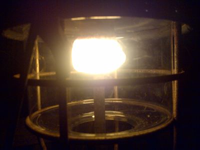

    I am slowly coming to the conclusion that Tilley Vaporisers might be saved.
    It is true that a pricker wire fitted or not makes a difference to the mixture. It seems to me less about whether there is proper "tip" that can reach through the jet - rather just the presence of the wire.
    I have one where the tip is burned away to nothing and it still leans the mixture. It burns much better with it than without.
    I bought a new Tilley vapouriser recently. Red & White box but 5" version. 606. The threaded bush to mate control cock is steel and the tube looks as if it is pressed in. It works but also runs rich so far. No leaks yet.
    My old vapouriser (assumed original from 1964 - date of mfg of lamp) has been peened to close up the jet. It was > 0.2mm before now about it is 0.18mm at guess.
    It is running pretty well if a bit weak - without a pricker wire.
    More testing required + maybe some pics to come.
    I lit it 30mins ago and I am watching results. Sorry for hurried post but I do think these might be saved - at least once.

    I have just shut it down. Light was too feeble. The mantle only partly illuminated and that was running at more pressure than I would like.
    It was not tank bending pressure but it was leaking from places that had never leaked before.
    Next I want to try bigger jet hole - it should need less pressure but may need a pricker wire fitted. It was not running too badly when set up like this last night, but I had to try narrowing the jet further, in case of better. Seems I have gone too far tonight.
    Peening is just a matter of a metal drift held squarely across the outside of the jet orifice - tap it and the metal from the outside is pushed inward and outward. The jet hole gets smaller. Hold it perfectly square or the gas will exit sideways - no good!
    Check result with the pricker wire. OK or NOK?? - If not ding it again. :content:
    Opening up is easy - work through a bigger pricker wire - but again keep the jet hole square and symmetrical.
    I am using the old Vapouriser as a test donkey - it was NBG anyway. If I find the right zone for the jet hole I might apply what I learn to the new one.
    I have resisted the temptation to fit the new Vap' pricker wire because it might be wrecked if it tries to pass a jet hole which is too small.
    The new vaporiser and pricker - out of the box - run rich at moderate tank pressure with fuel tap fully open. It gives a nice white light - ideal mixture - if fuel tap is backed off slightly. But as my fuel valve is missing any reduction in the mixture is caused by the pricker blocking the jet - I am not happy with that - tip will burn away eventually.
    I am looking for good mixture at moderate tank pressure and fuel tap wide open - with pricker safely retracted.

    Thanks to generous donation of some 0.16mm acupuncture needles by member Bjorn I have had the chance to experiment some more.
    I closed up the jet of the old vapouriser until the 0.16mm pricker was a perfect fit. It burned very well, without a pricker. At normal tank pressure the light was bright and very white, no trace of the yellow it had before.
    Unfortunately it did not last long like that. Over 30 minutes or so I think the jet opened up again as the light became progressively more yellow.
    The problem I am quite sure is that it is difficult to close the jet by peening from the top when there is nothing on the underside to absorb the impact. The top of the vapouriser has dished inward. I think the jet hole closure was probably only the creation of a small burr around the top which slowly burned away.
    Now looking for a rod which will pass the pricker guides and act as back stop. This should enable more material to be moved so it might last a bit longer next time. By experiment 1.8mm seems to be the required diameter, a drill blank of that size passes the lower guides. A pity it is too short to do the job.
