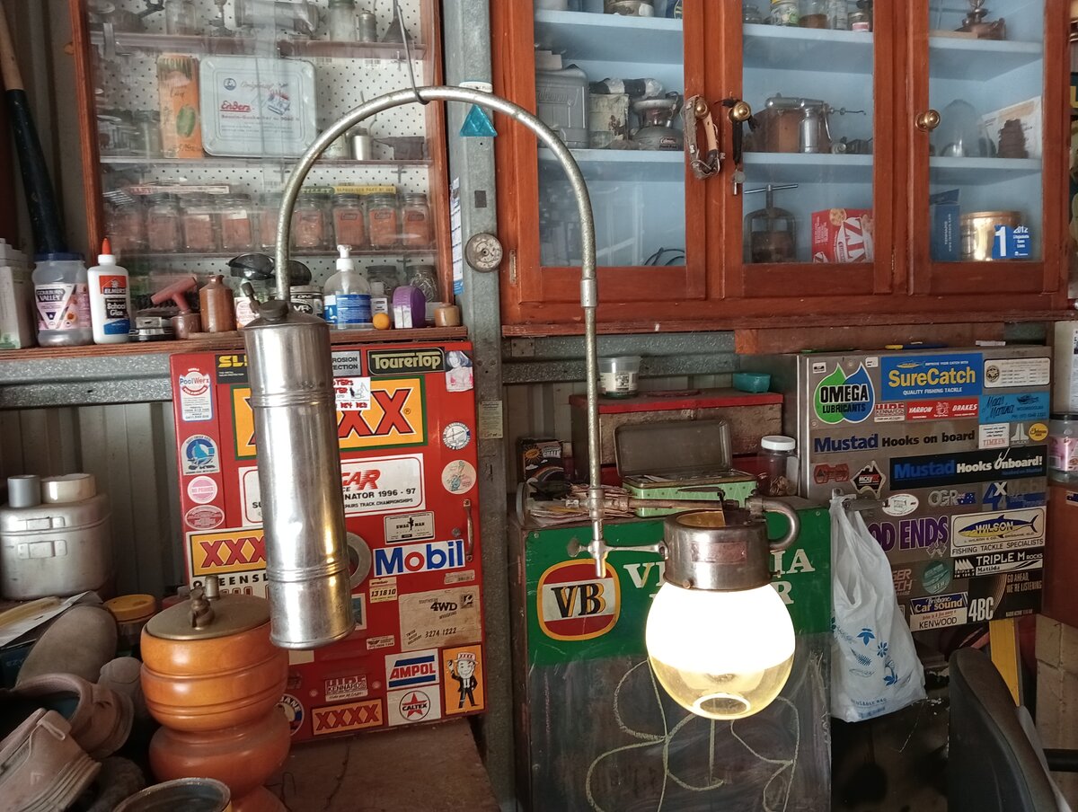

    IMG20240414163319.jpg I have had a part off this model lamp for 20 years just sitting around not knowing what it fitted.
    So on it went with a nice shade just for @Jean J and it fired asap as well. IMG20240414160925.jpg

  5. Fireexit1 United Kingdom
    3,538
    Never heard of Aerogen gas - fascinating ! - what fuel is it actually running on ?

  7. Henry Plews
    3,073
    Very good, I like the green tinted shade with flowers and I notice the address on the plate on the burner housing is different to the one on the advertising flyer.

  10. MYN
    It could be petrol vapour-air mixture:-
    Aerogen petrol air safety gas for country houses : for lighting, heating, cooking ... : Watts, Fincham & Co. : Free Download, Borrow, and Streaming : Internet Archive

  12. Erik Leger
    Erik Leger Germany Subscriber
    507
    I wrote an article for de-Wikipedia about that type of miniature gasworks.
    Aerogengas – Wikipedia
    alternative names are Luftgas ("air-gas") or Benoidgas
    The papers the article is based on are:
    Aerogengas: aus dem "Journal für Gasbeleuchtung" 1901 - gefunden von WWW.COLAG.DE
    Luftgas - gefunden von WWW.COLAG.DE - Continental Licht
    As nobody translated these yet, they are all German. Google translate will help (a little at least).

  15. Marko57
    Marko57 Australia Subscriber
    Jul 30, 2022
    204
    Brisbane Australia
    I fired her up on Shellite, in the old days it would of be Gasoline,Petrol.

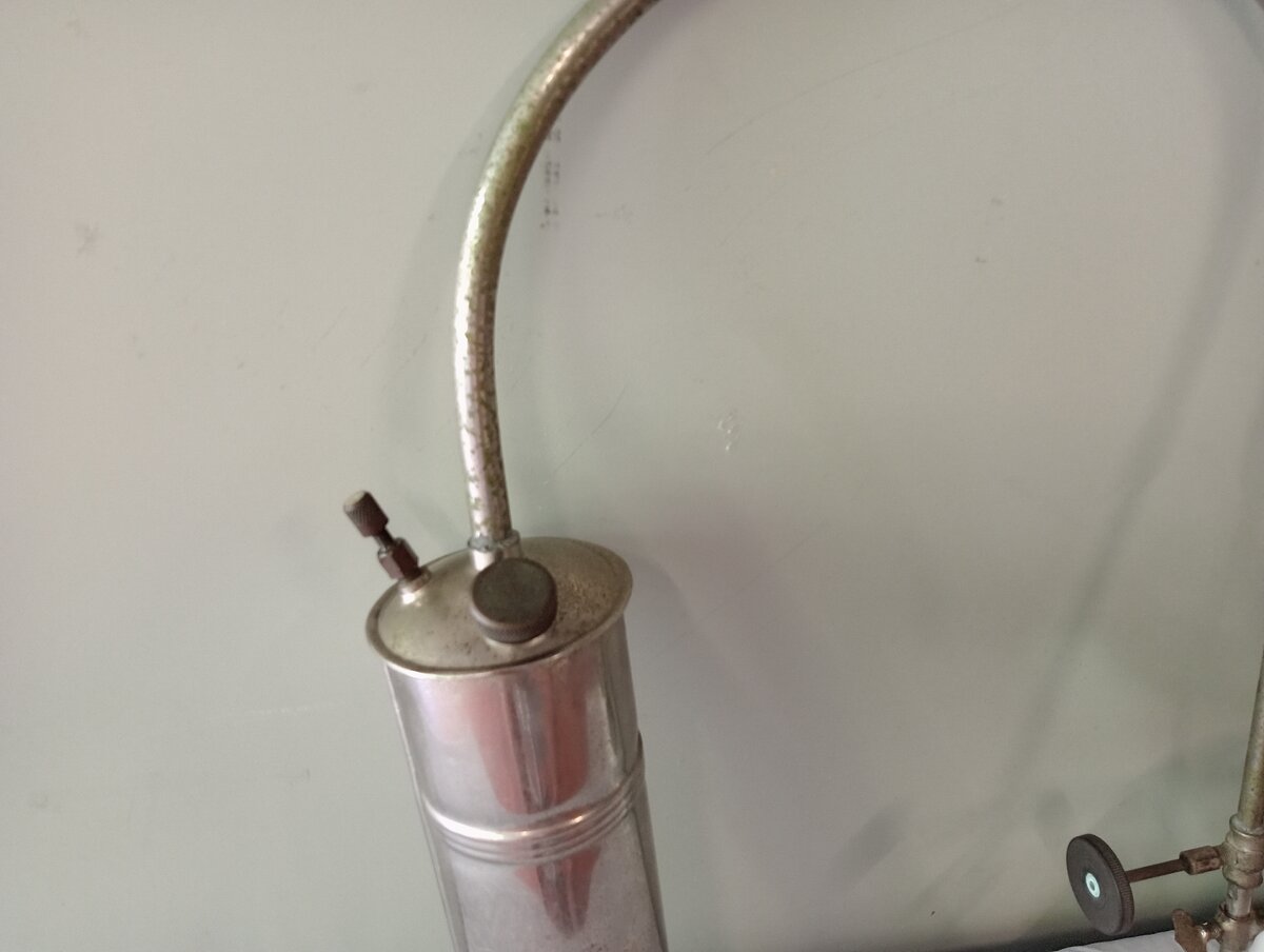

  17. Fireexit1 United Kingdom
    3,538
    Thanks Marko - But just for clarity - can I ask if it is a pressure lantern with a vapoursiser ? or does it do something clever to create vapour out of the tank ? - is the longer bit coming out of the top of the tank a schrader valve or similar ?
