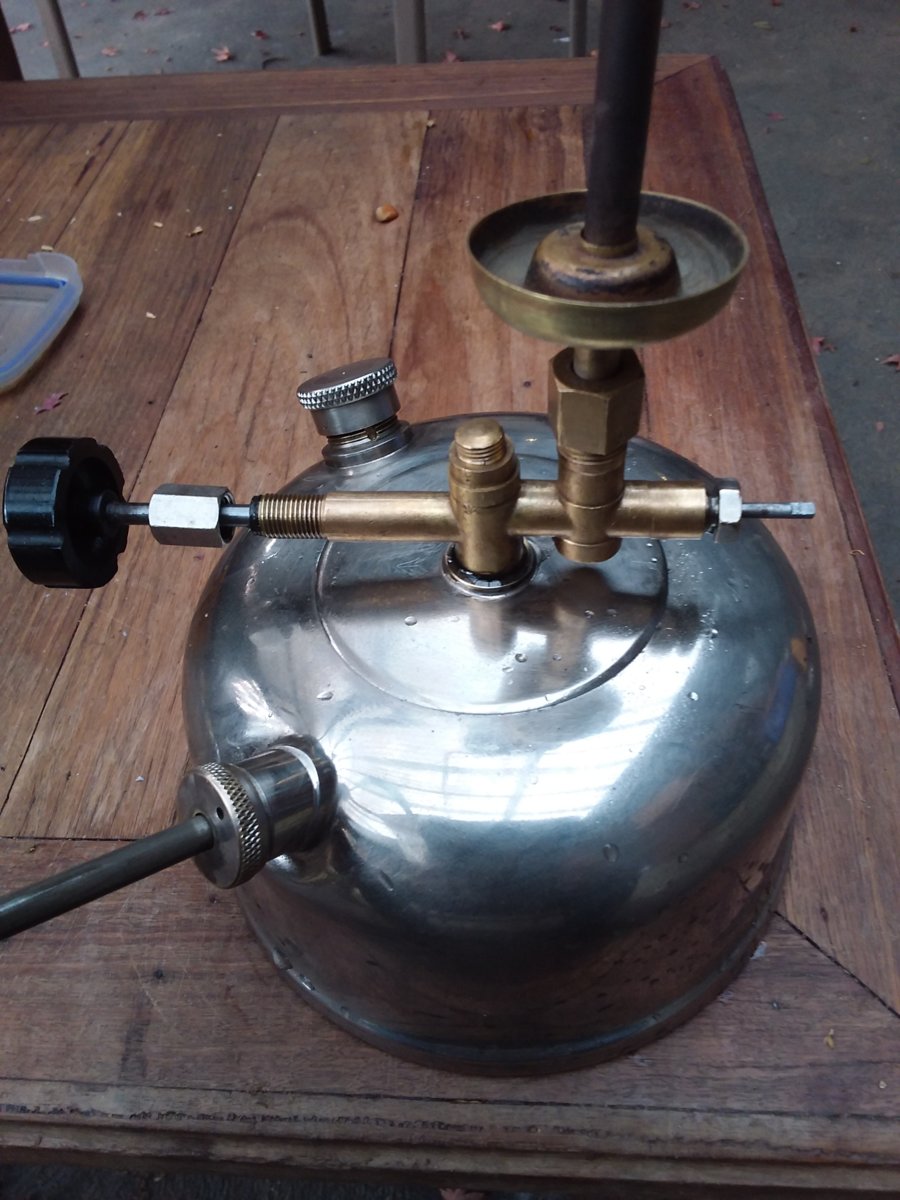

    15880337448758820830618719562207.jpg The o ring seems to work where the fuel valve meets the fount, however, there seems to be fuel/air escaping from the gland nut on the fuel control knob
  23. Tony Press
    11,105
    @Damien
    That "gland nut" (I think you are referring to the "packing nut") should have graphite packing inside. After getting it in place and tightening it, if it leaks, tighten it 1/4 of a turn and see whether that stops the leak. Turn a bit more, if it still leaks. If it gets really tight and leaks, you will need to add more, or replace, the graphite. You can also use high temperature PTFE plumbers' gas tape if you've got no graphite.
    The problem with O-rings in places where a flat washer is usually used, is that they can distort under pressure. Use them to test, but go to the original kind of washer for long term use (IMHO).
  24. Damien Australia
    Apr 8, 2020
    136
    NSW
    Cheers Tony.

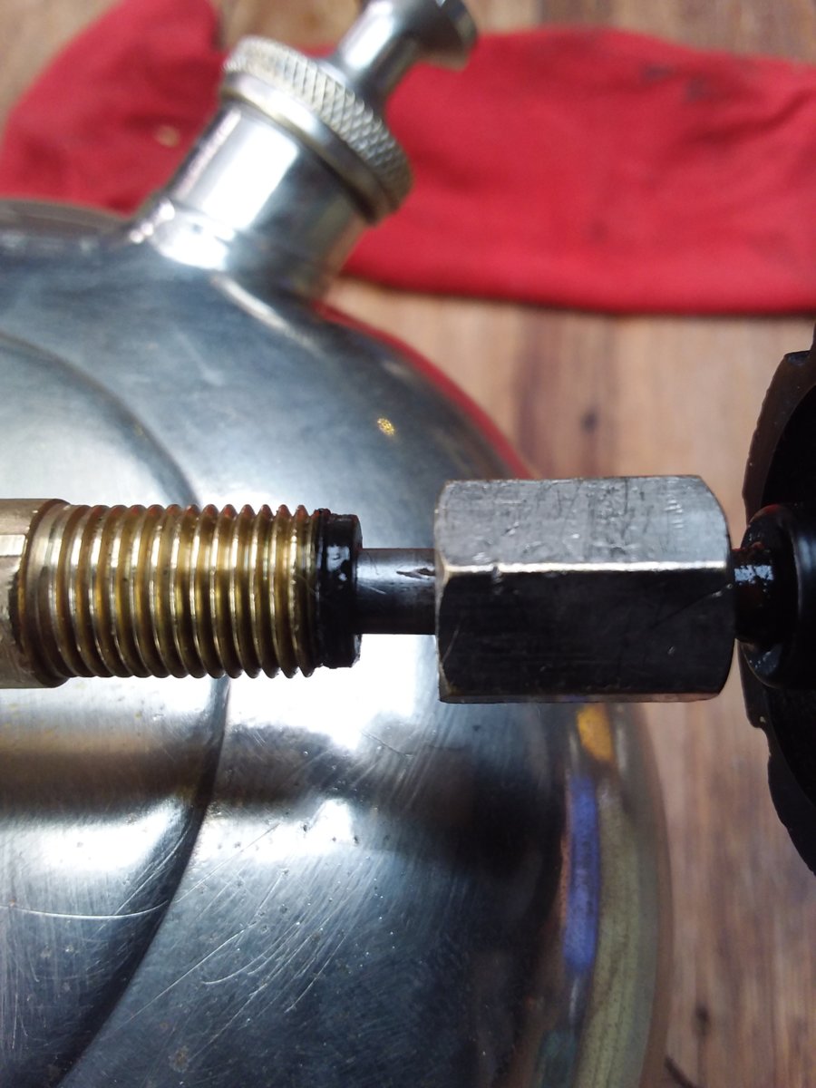

    Theres also the nut near the o ring in the photo on the bottom of the vapouriser tube, and the nut that holds the pricker rod...... are all these, and more, potential leak points for air/ fuel? 20200428_105856.jpg 20200428_105856.jpg 20200428_105757.jpg

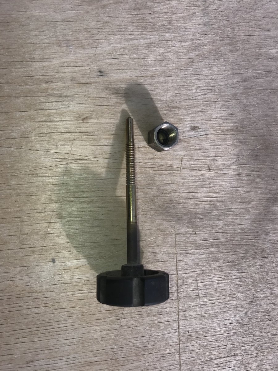

    Is this the nut and thread that's meant to have graphite packing? All I've got on the male end is some sort of gasket cum o ring type washer...... which doesn't want to come off! It certainly leaks fuel through this thread, and if I keep tightening it, the fuel control knob itself gets very hard to turn. 20200428_113149.jpg
  26. Tony Press
    11,105
    @Damien
    Unscrew the control spindle all the way out and look in the parking nut.
    By the way, the one I pulled off just then had a useless hard rubber washer of sorts (obviously past it’s use by date) rather than graphite. Tilley use that system.

    And thanks Tony. The nut in question has NO packing of any kind, just the odd looking rubber grommet/washer thingy on the end of the male thread. BTW, is this grommet thingy an original part? It seems not to be by how you're describing it.
