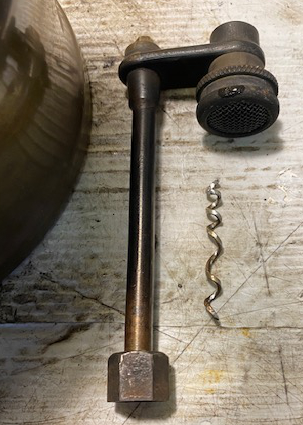

    I'm getting a new pricker for my nice Veritas, but just want to check the packer that came out of it.
    Does this look right? The spiral thing?

    Hmm..
    Perhaps a former owner experienced black mantle disease and found that it helped in the same way as some of the Coleman lanterns have in theirs?
    great picture :thumbup:

    Well I'll be getting a new pricker for it, we'll know then.

    Perhaps it was pulsing and that was their idea to improve fuel flow through the vapouriser. On my Hipolito 502, had to wrap the pricker in bronze wool to stop it from pulsing, runs fine now. Just a thought:-k

    I think that's a distinct possibility... :thumbup:
