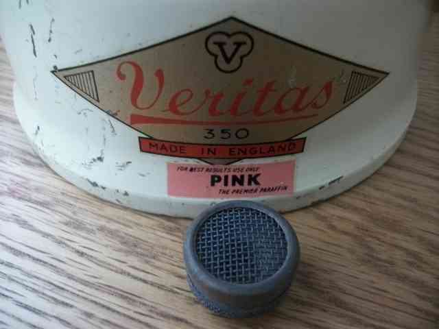

  4. David Shouksmith
    No idea about the first two questions - sorry.
    The Veritas 350 has a brass burner nozzle with an inset metal gauze:-
    Hope that helps...
    16,875

    Hi All,
    Thanks to everyone for their welcome messages etc. and replies. Also to David for his Pictures now I know what the burner should look like. Very helpful.

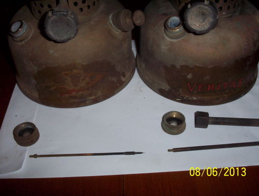

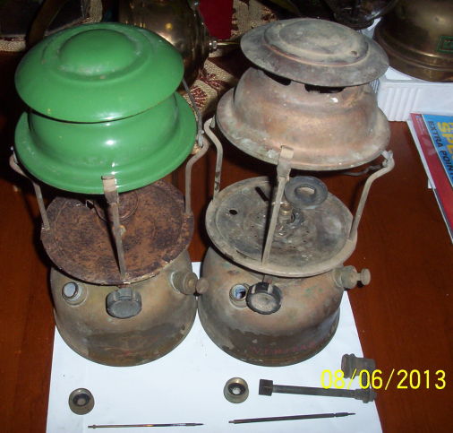

    Hi Richard hope this is useful, there is a difference in the lengths probably due to size of cam raiser blocks ( prick wire broken off in older model tip)
    Found what I think will make good 0.15mm pricker wire in 1 strand of 7 strand C/L model aircraft control cable.
    Does anyone know where to find a drill to make the hole for this.
    1370698181-Veritas_002_opt.jpg 1370698200-Veritas_001_opt.jpg 1370698218-Veritas_006_opt.jpg

    Hi Graham,
    Thanks for that info.
    I examined the end of the pricker wire holder with a strong magnifier. The steel wire is held in place in the brass by crimping the brass around it.
    The smallest drill bit I have is 1mm, I think I will be able to crimp it enough to hold the wire in place.
    I have obtained some Dental root canal files that have a very fine diameter, and have smoothed the files teeth off one of them by carefully rounding them off on a sharpening stone so that it now fits through the jet.
    Drill bits smaller than 1mm should be available from engineering supplies stores. P&N or Suttons here in Australia should have them. Although using something that fine would be an interesting exercise.
    Regards
    Richard
