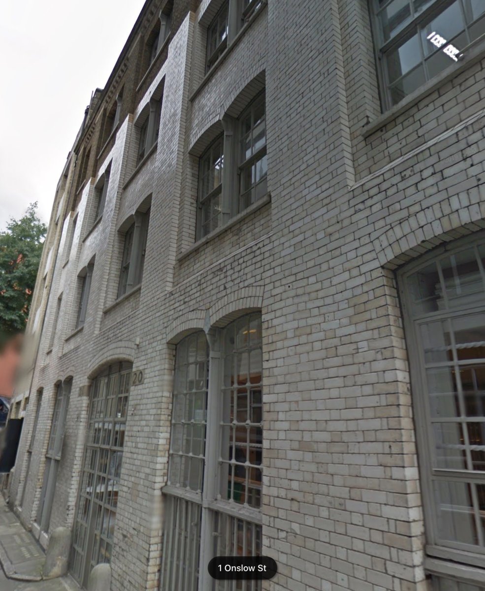

    Looks like the Farringdon road buildings suffered the same fate as well. I gather the red fronted ones are 83, 85 and 87. To the right is 91 and 93 and to the left is 79. Onslow street is around the back and I think that would have been the same building so is also missing.
    A real shame as it would appear the buildings next door are the originals and much better looking.

    The evidence is building (excuse the pun) that the buildings used for mantle manufacture or storage were knocked down in the UK due to contamination hysteria.
    I suppose asbestos would have been used too.

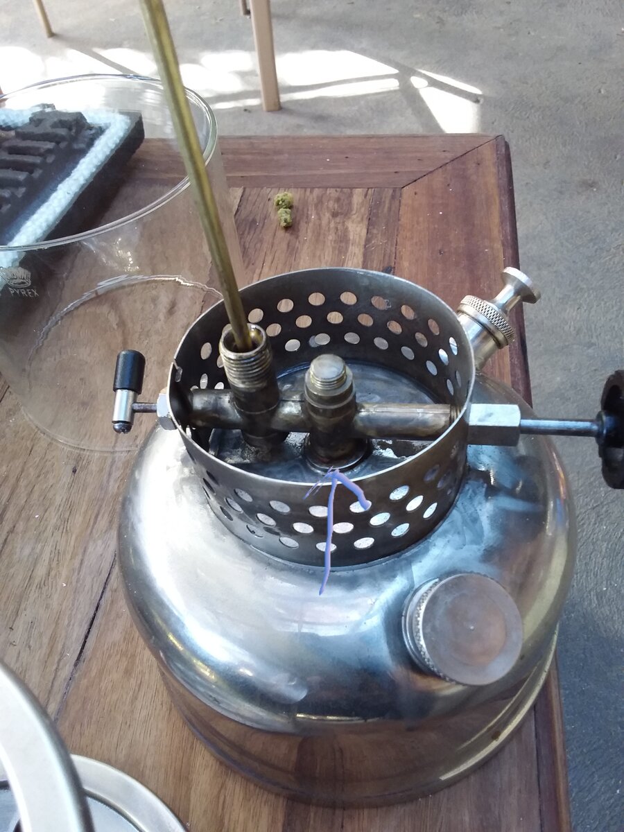

    20200610_124503.jpg Will a Viton washer work where I've put the arrow? The bunsen test revealed blue flame, but very little... too lean? Maybe a leak or three?

    It would seal but better is a lead one.
    Any rubber washer tends to deform, so being part of the "holding it all together" I would use a lead one.
  20. Henry Plews
    3,068
    I'm sure the original was a fibre washer but yes, a Viton one will do.

    Thread seal tape ???
