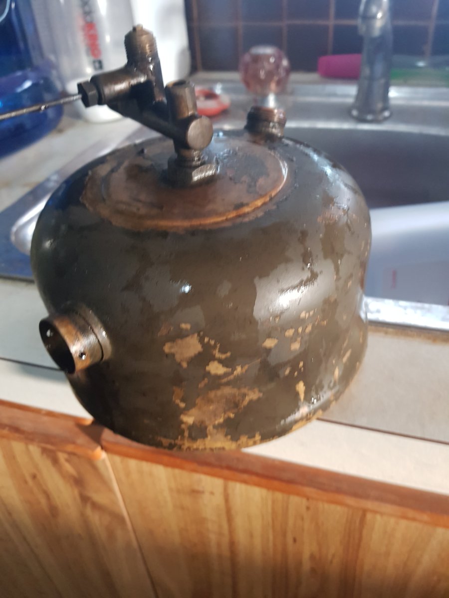

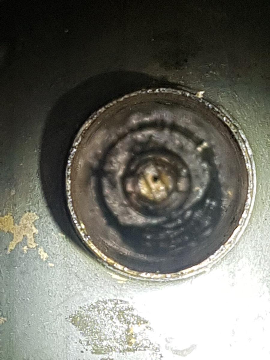

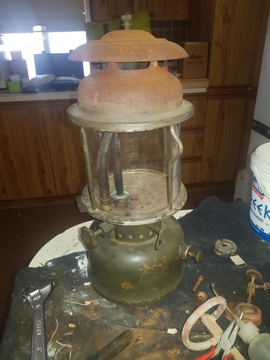

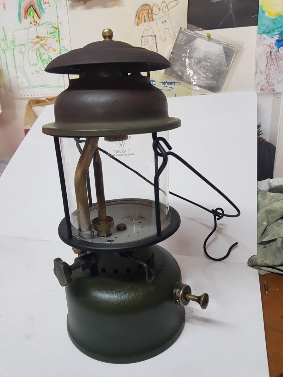

    Hi fellas, this is my newly fettled Dutch Army issued Veritas P350.
    20200222_121537.jpg What an educational project it has been. Its petrol, (shellite, coleman fuel) not kero that is sometimes stenciled on the tank., confusingly it has a meth bowl/ preheater just like a kero lantern but as other fellas have discussed it preheats the vaporisor let it burn out then light the latern and hay presto ignition with no great flre ups.
    It has an AGM NRV similar to coleman

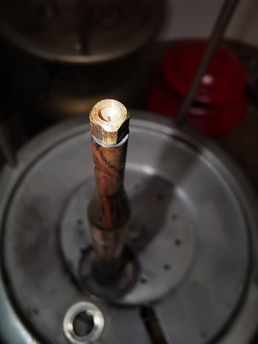

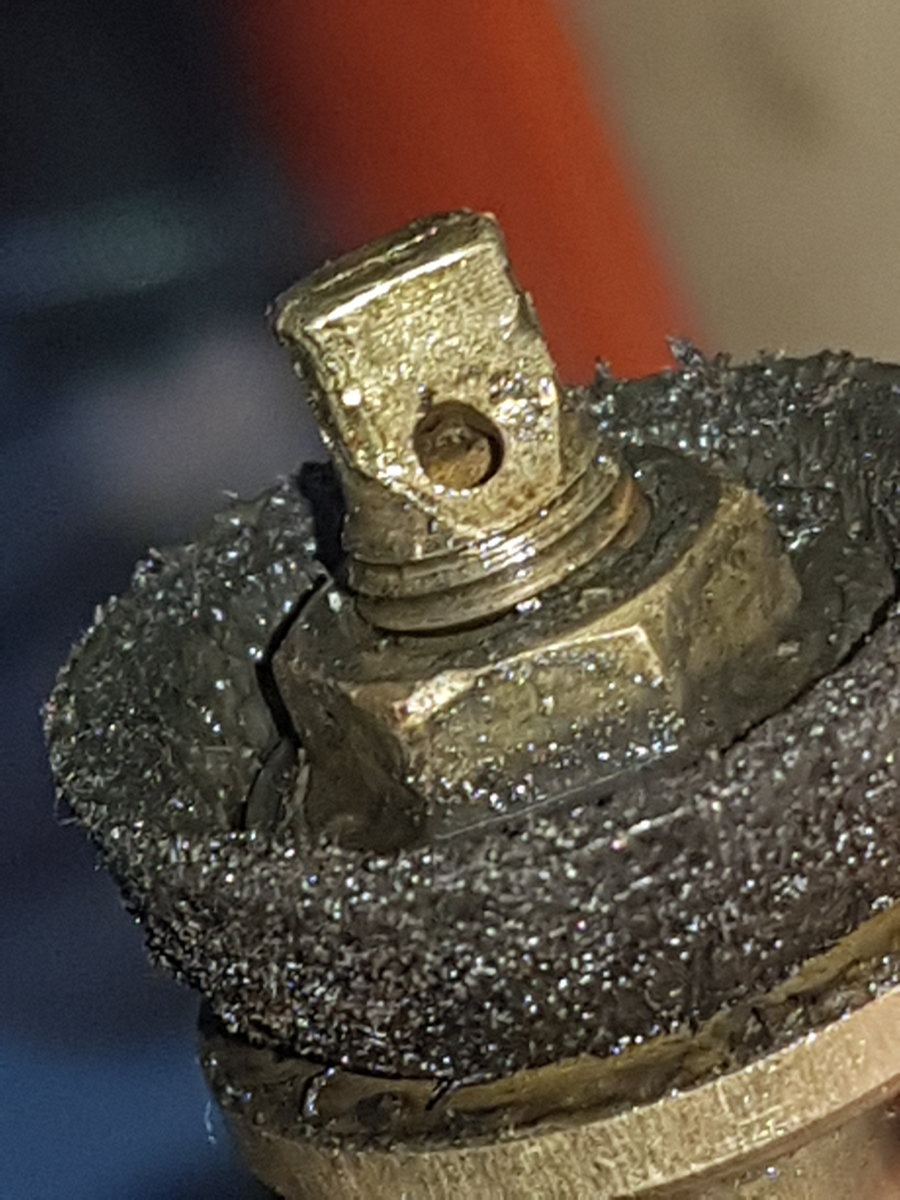

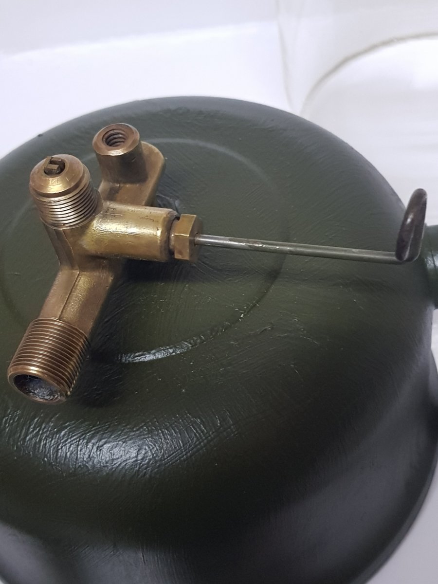

    The vaporiser is /looks very similar to the tilley needle, the needle base is not fixed into the ecentric block, it sits ontop,
    20200302_083033.jpg the spring the brass spacer and the brass restricter act as the spring tention when to raise and lower the pricker, i replaced what i usumed was aspestos with brass,

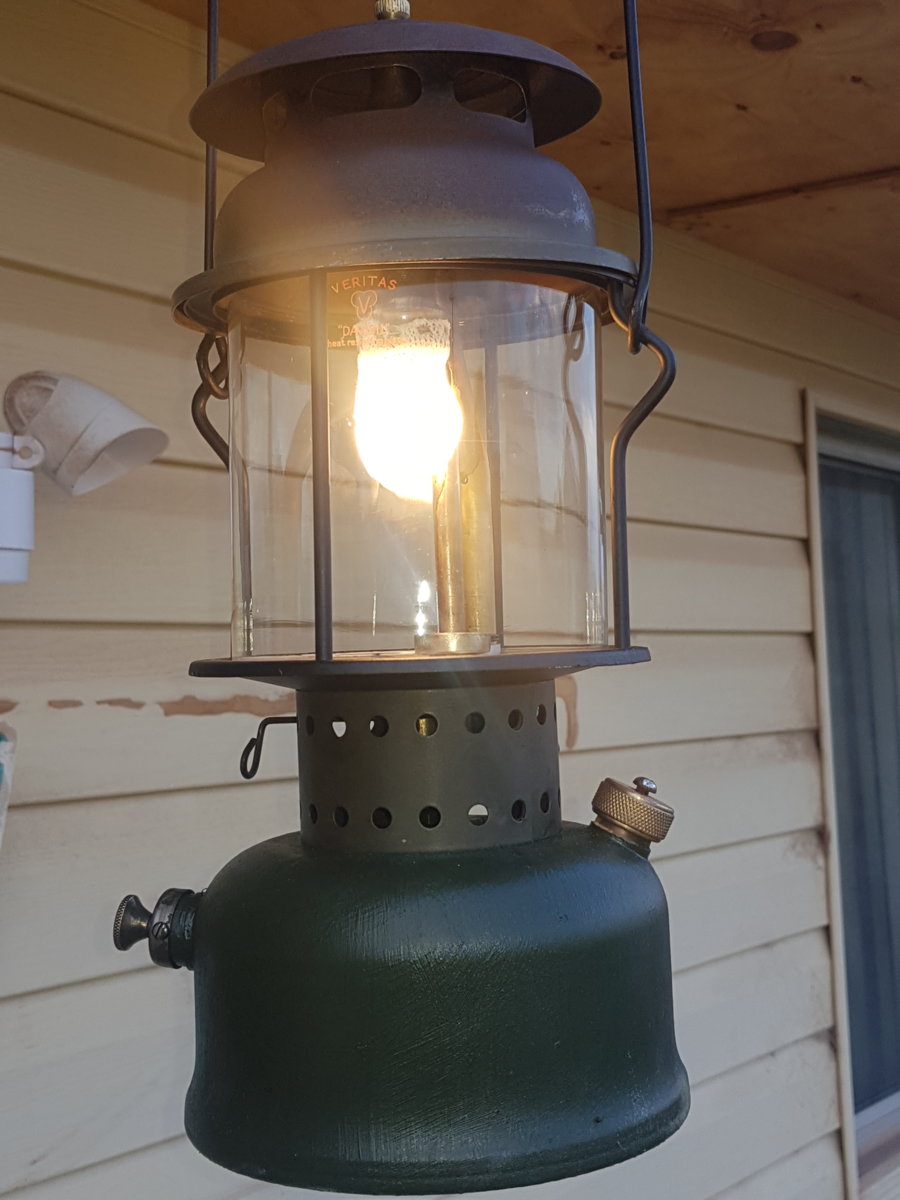

    I stripped the paint of the tank etch primed and repainted by hand brush, i had the colour made up as close as possible at the paint shop,

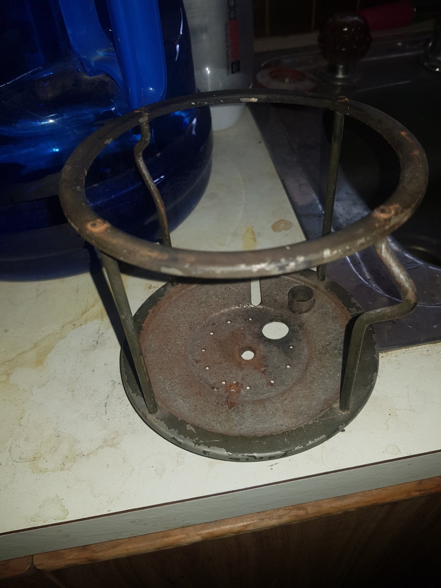

    Blast and painted the burner frame in hi temp spray pak, left the hood as original condition and colour, the collar and fuel knob are original condition. 20200302_082953.jpg
    It cleaned up well,
    Looks good, and now the money shot
    Very cool,
    Hope you all enjoy the fettle

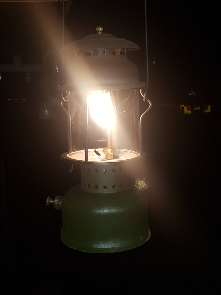

  4. Darryl Durdin
    1,652
    Full effect

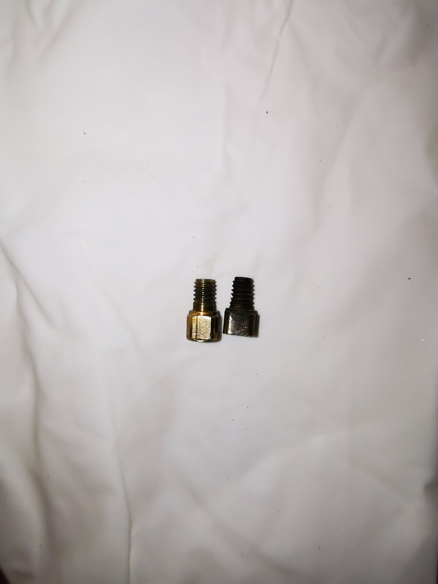

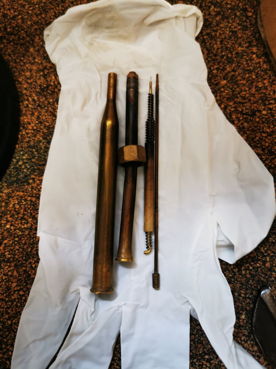

    @AussiePete i believe that the P350 uses different jet that Veritas 350, se my post about search for jet to my P350.
    Great jobb @Darryl Durdin!

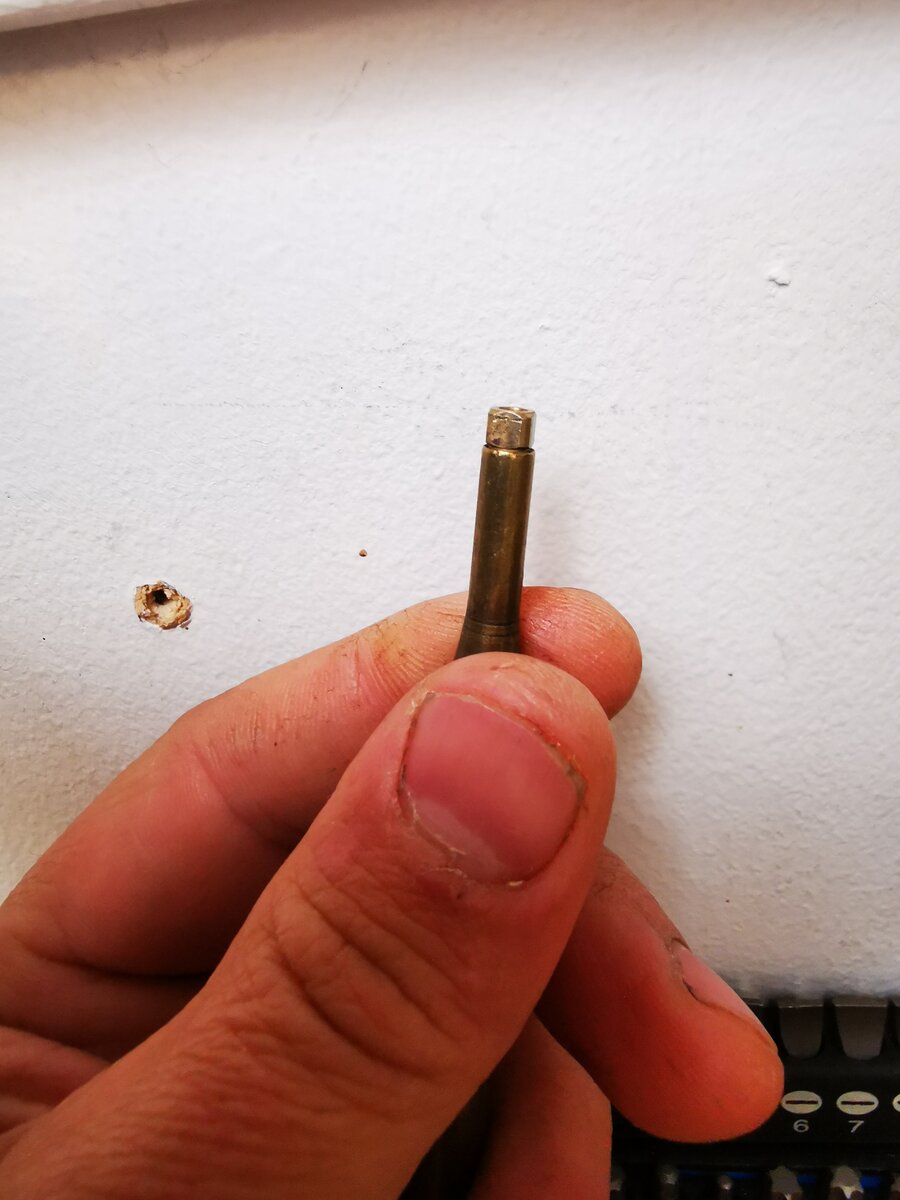

    Did you find a replacement for the jet? Or you have an idea where to start looking? I have now a P350 without jet and the needle is broken.
    Cheers,
    Francisc
  20. AussiePete
    @Carpedien1982
    A modified Austramax jet will fit the Veritas 350 and run very successfully. I have used a number of modified Austramax jet’s on the Veritas 350.
    The P350 is a different animal, the Dutch army had the P350. The P350’s jet is physically smaller than the 350 and it’s designed to operate with petrol, not kerosene.
    I haven’t a P350 in my stable, I wish I did so I cannot comment on a replacement for the P350.
    Keep them burning
  21. Francisc Masec Netherlands
    Jul 16, 2019
    195
    Sweden
    @AussiePete @Darrren yesterday i found a replacement for a P350 in the Coleman 200A jet. Now i need to find a longer generator/vaporizer for the cleaning needle.
