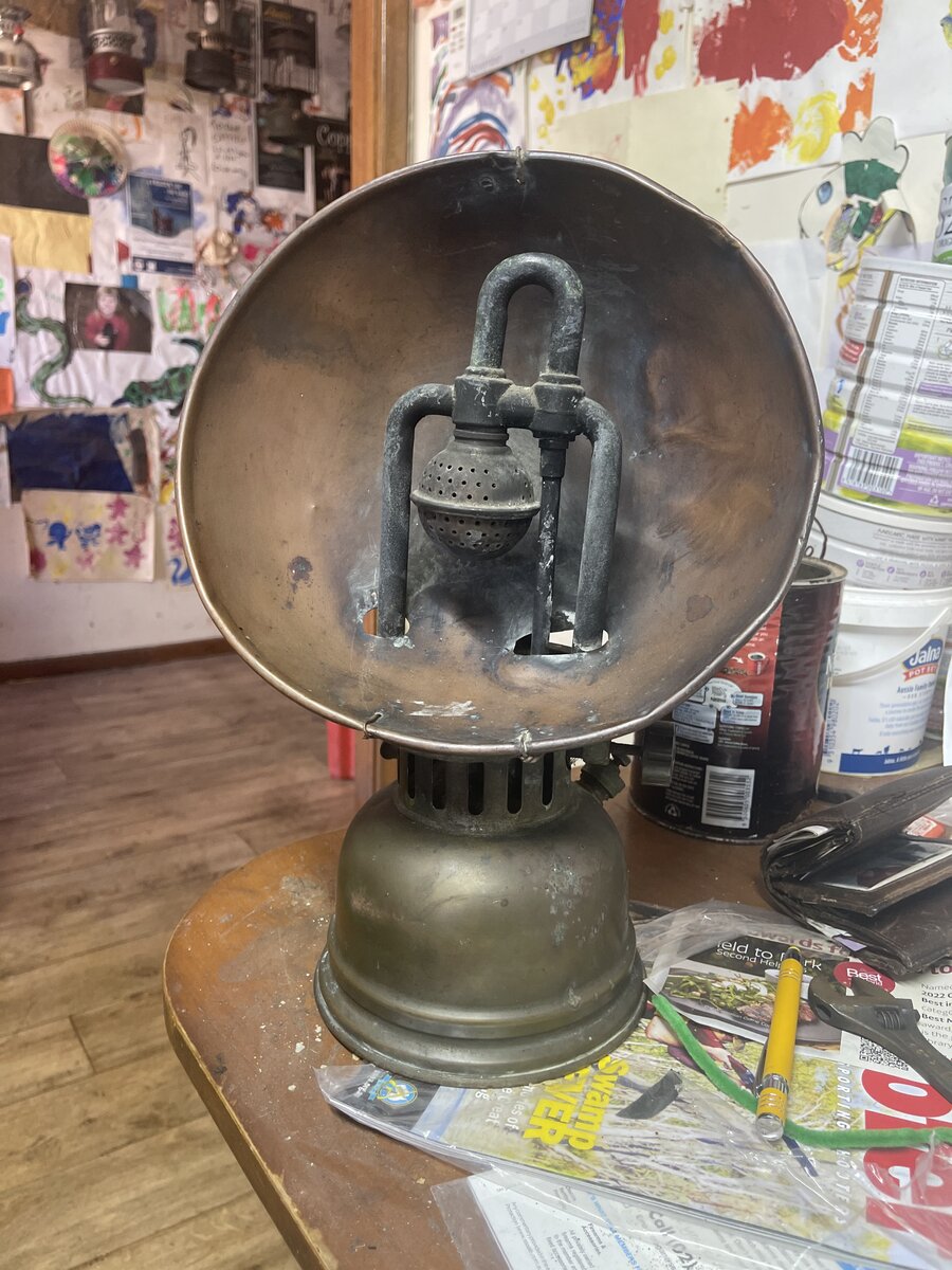

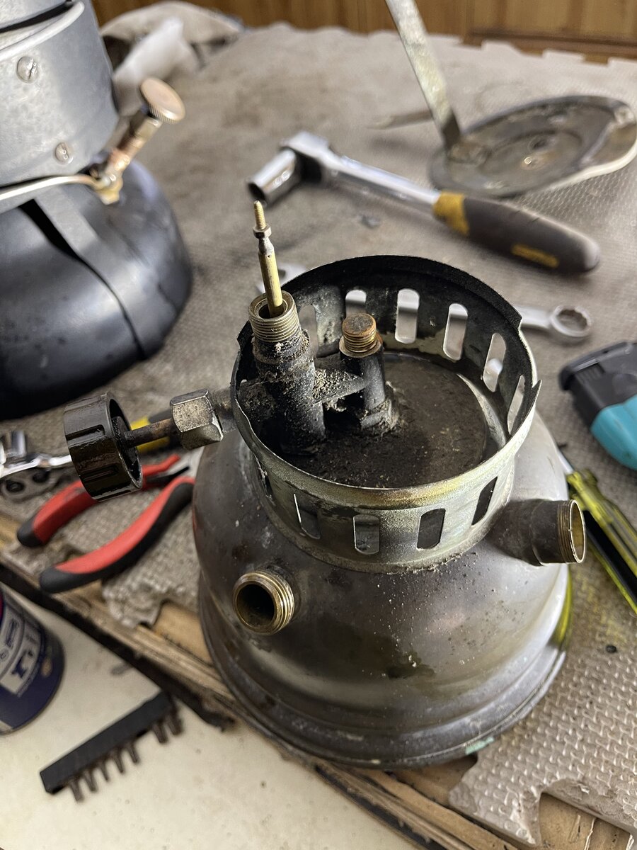

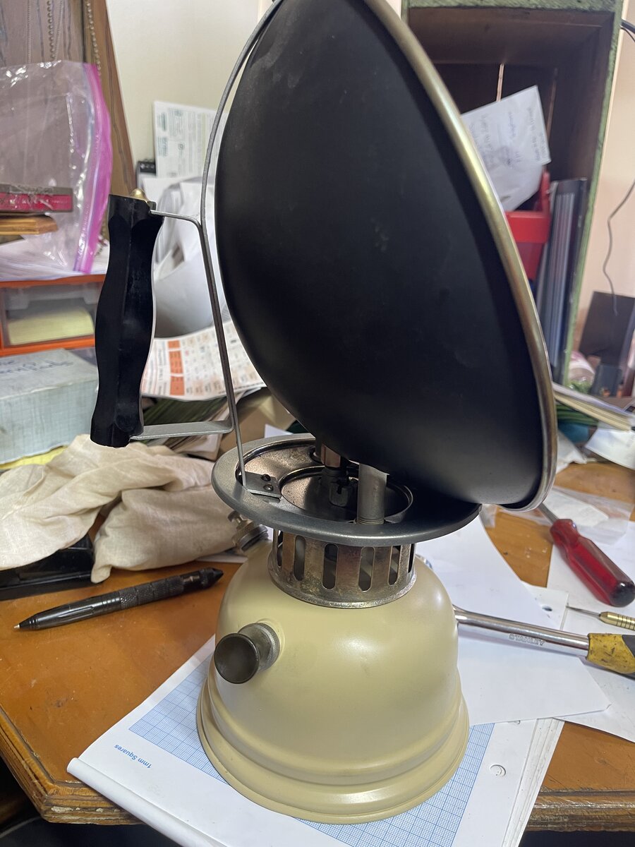

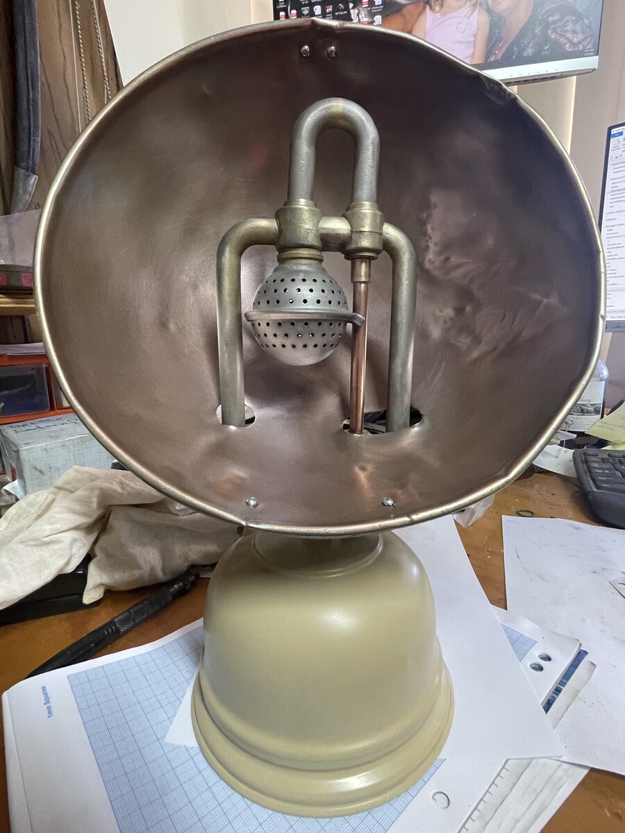

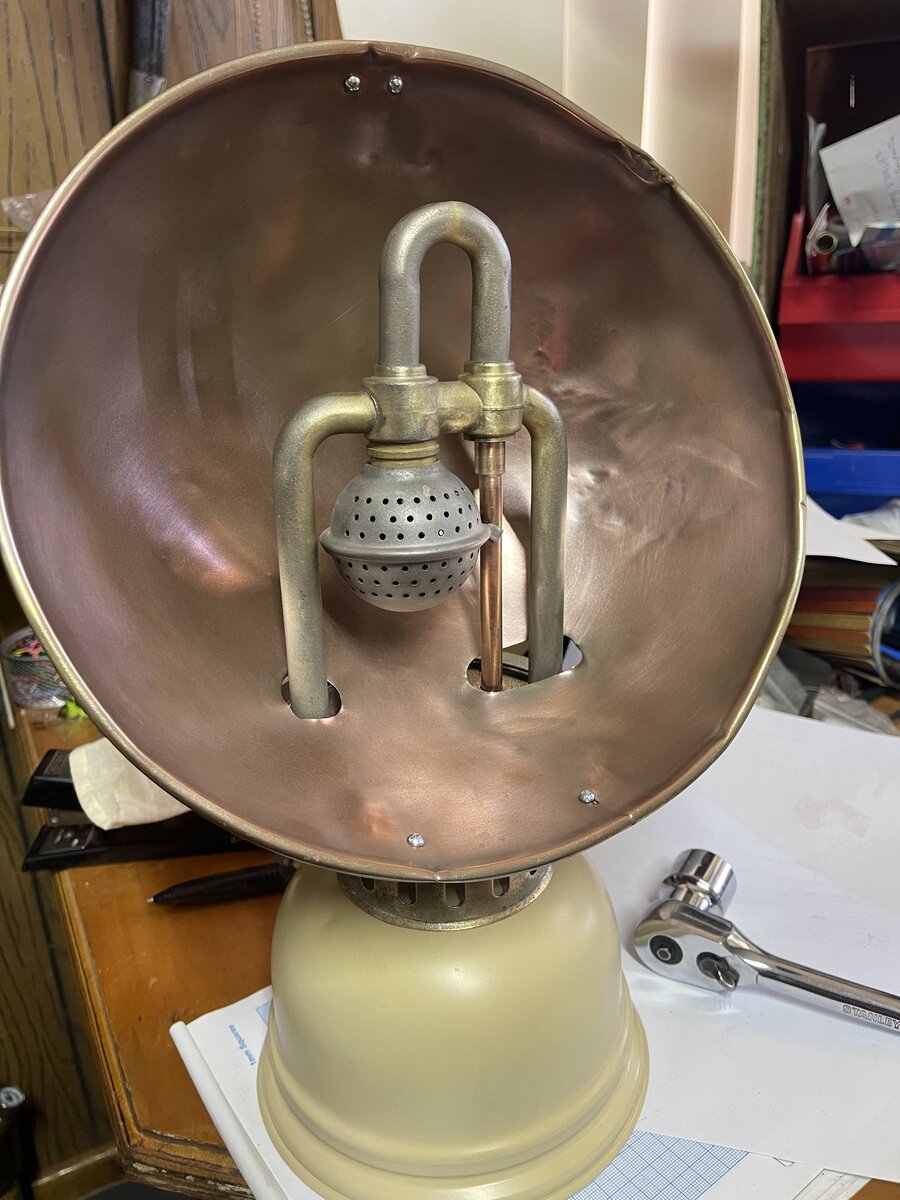

    Hi Fellas I have restored the Fireball close to its original look.
    Thank you to @Mackburner Neil for the link to the Thermidor 303 it was very helpful,
    The heater was a simple restoration just a matter of a good clean and paint.
    it fired up first time, I’m missing the grill guard and a meth bowl. It is preheated I used a Tilley torch to get it started,
    original condition.

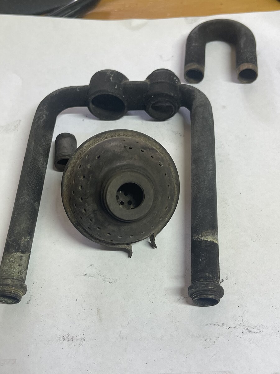

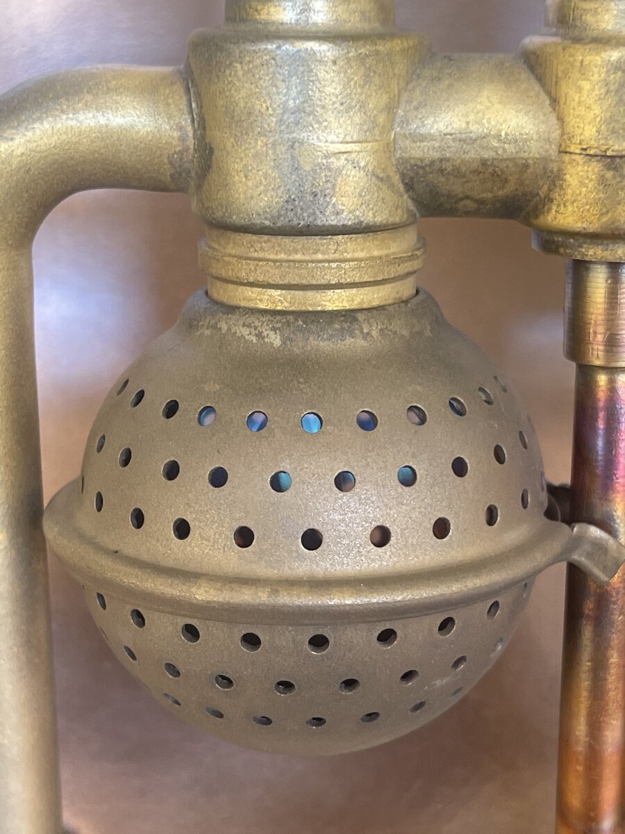

    The fireball is made of steel, two parts, it has a one piece burner cap perforated mesh. The air tubes are plated brass.
    The vaporiser is brass, the reflector is copper it has a painted black back.
    F5E4F24F-0DD5-404F-89FC-C449CDC262FA.jpeg 1BE8D86E-F164-406A-B1E9-861EFFD9A7D8.jpeg BA6A6338-0FBE-4089-8CEE-E1C66205F436.jpeg E7028215-B2D6-4CDA-B67F-0E922F60C28E.jpeg

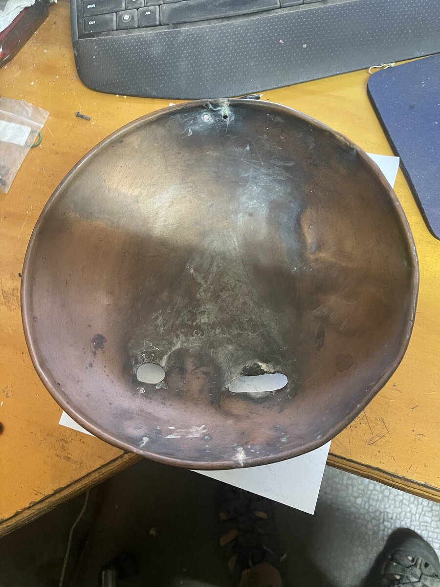

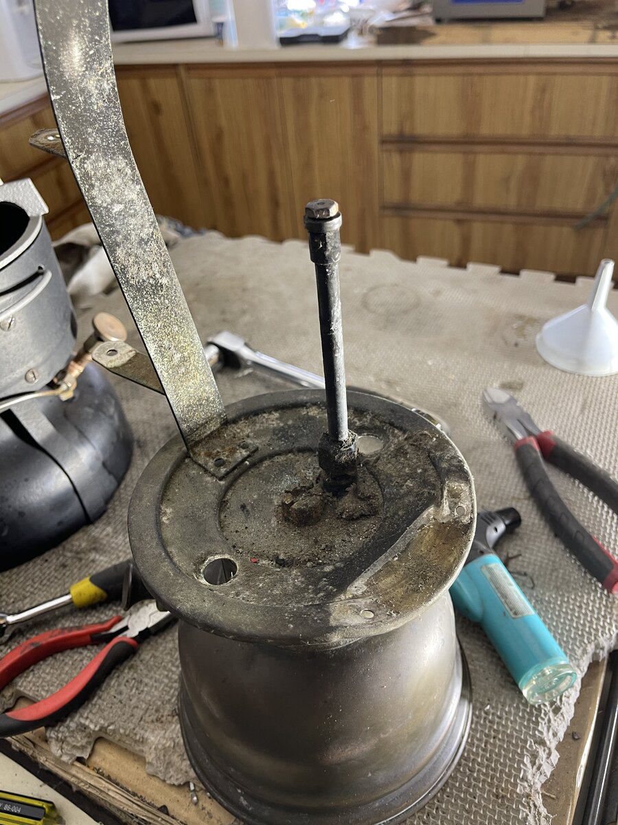

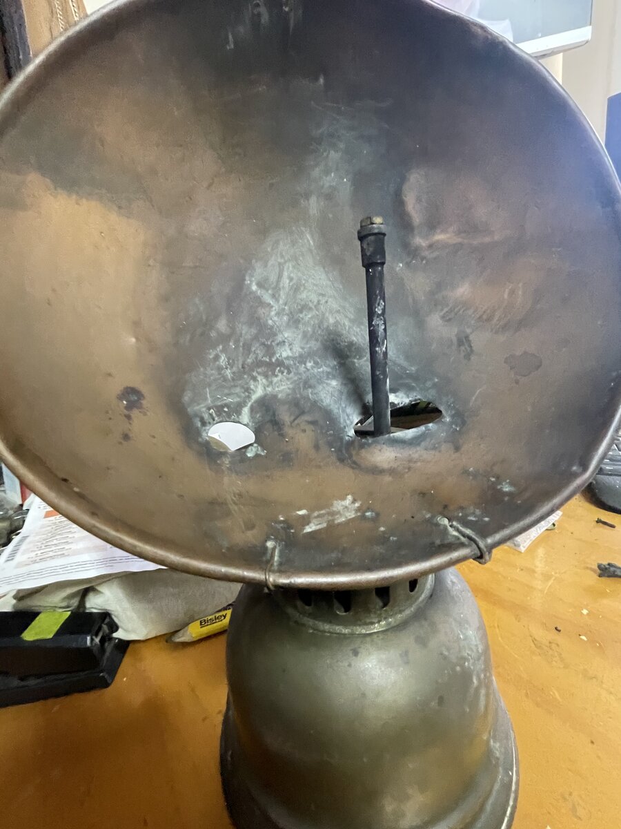

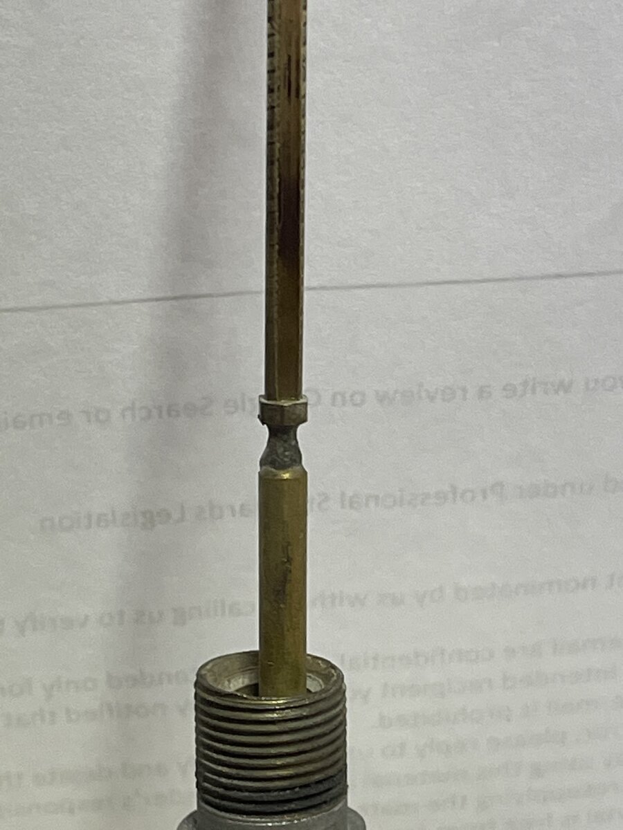

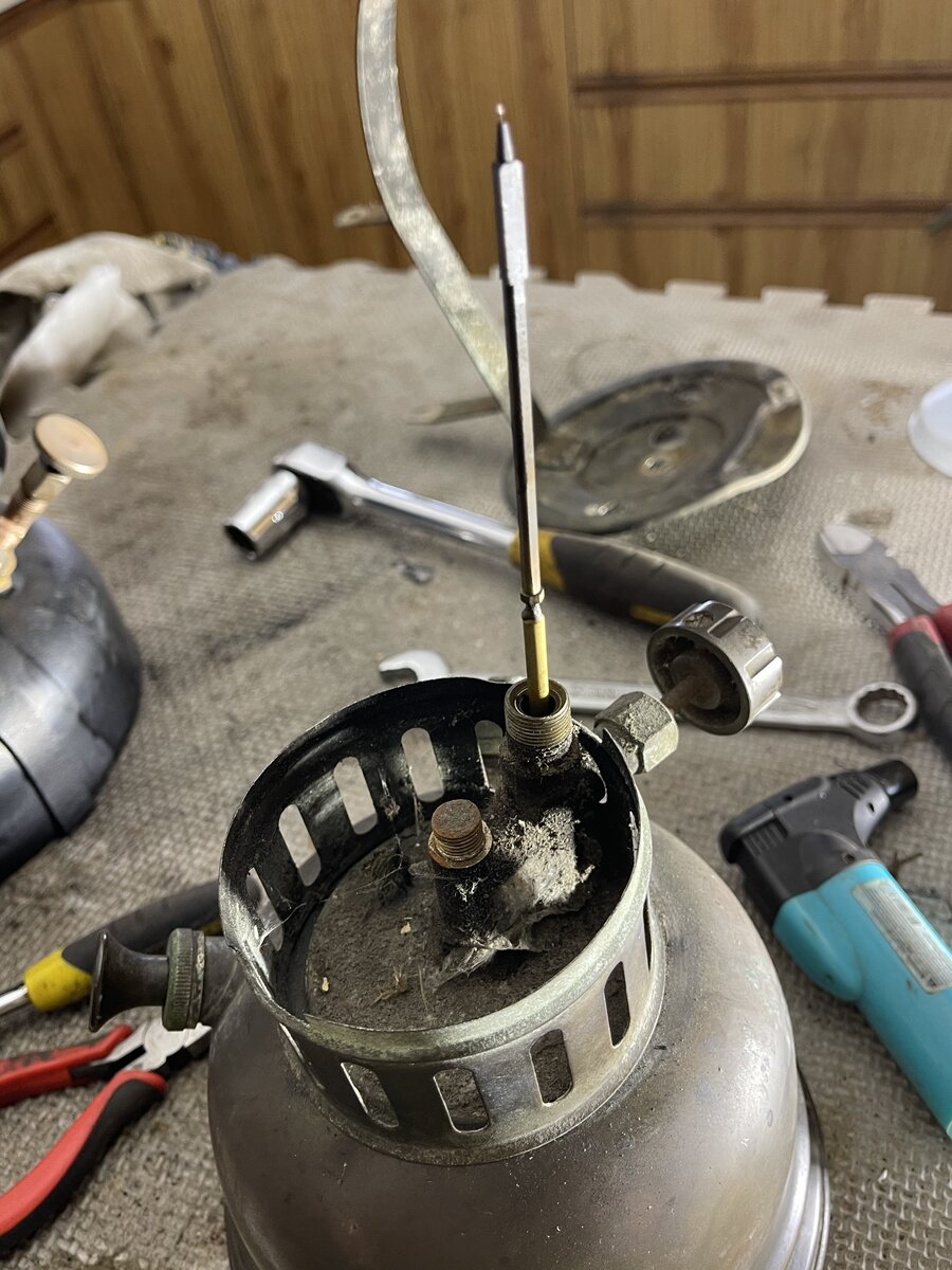

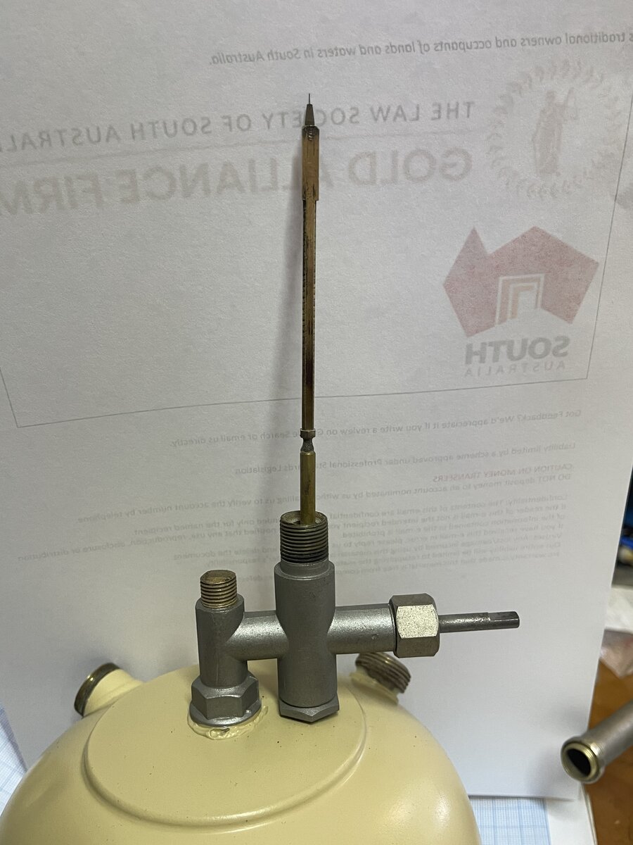

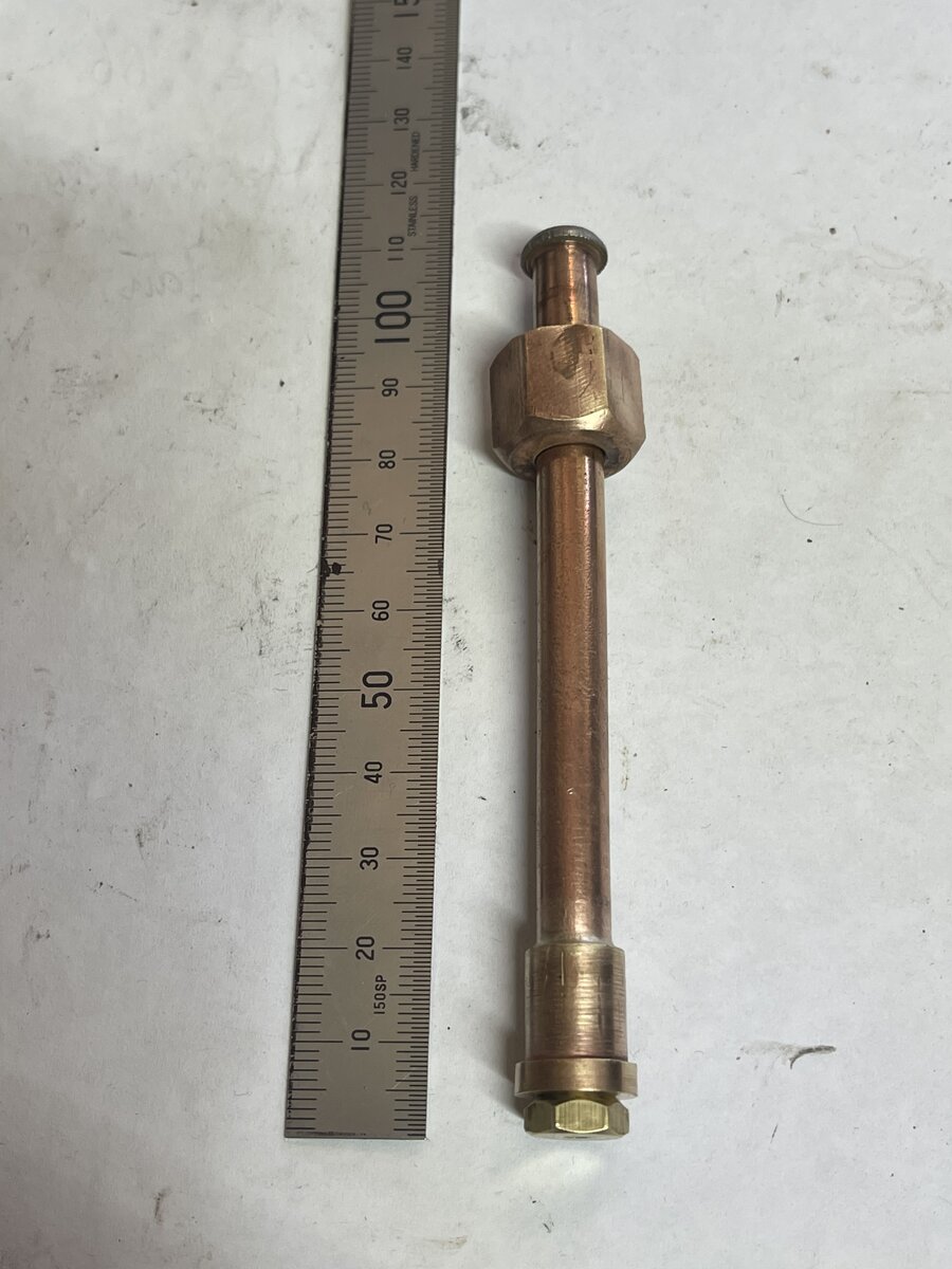

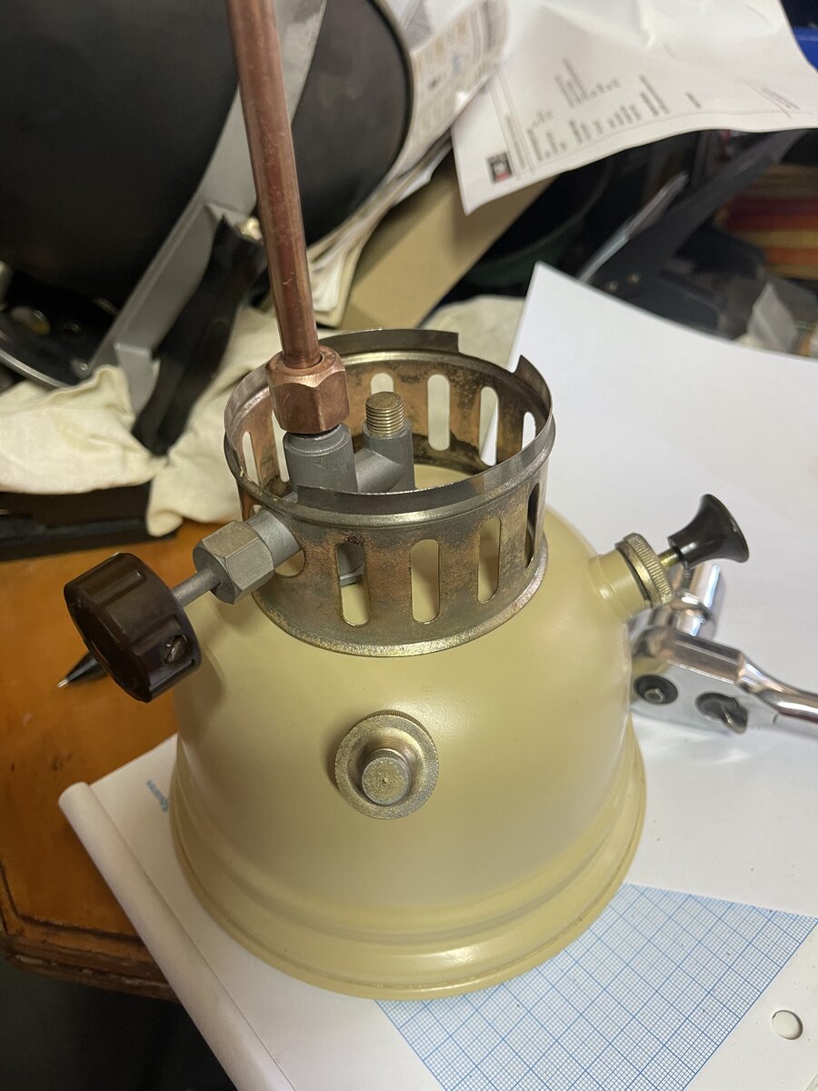

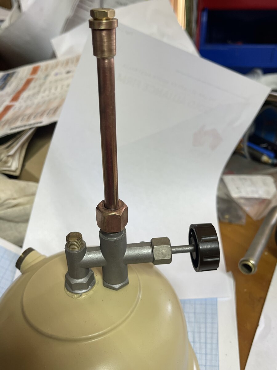

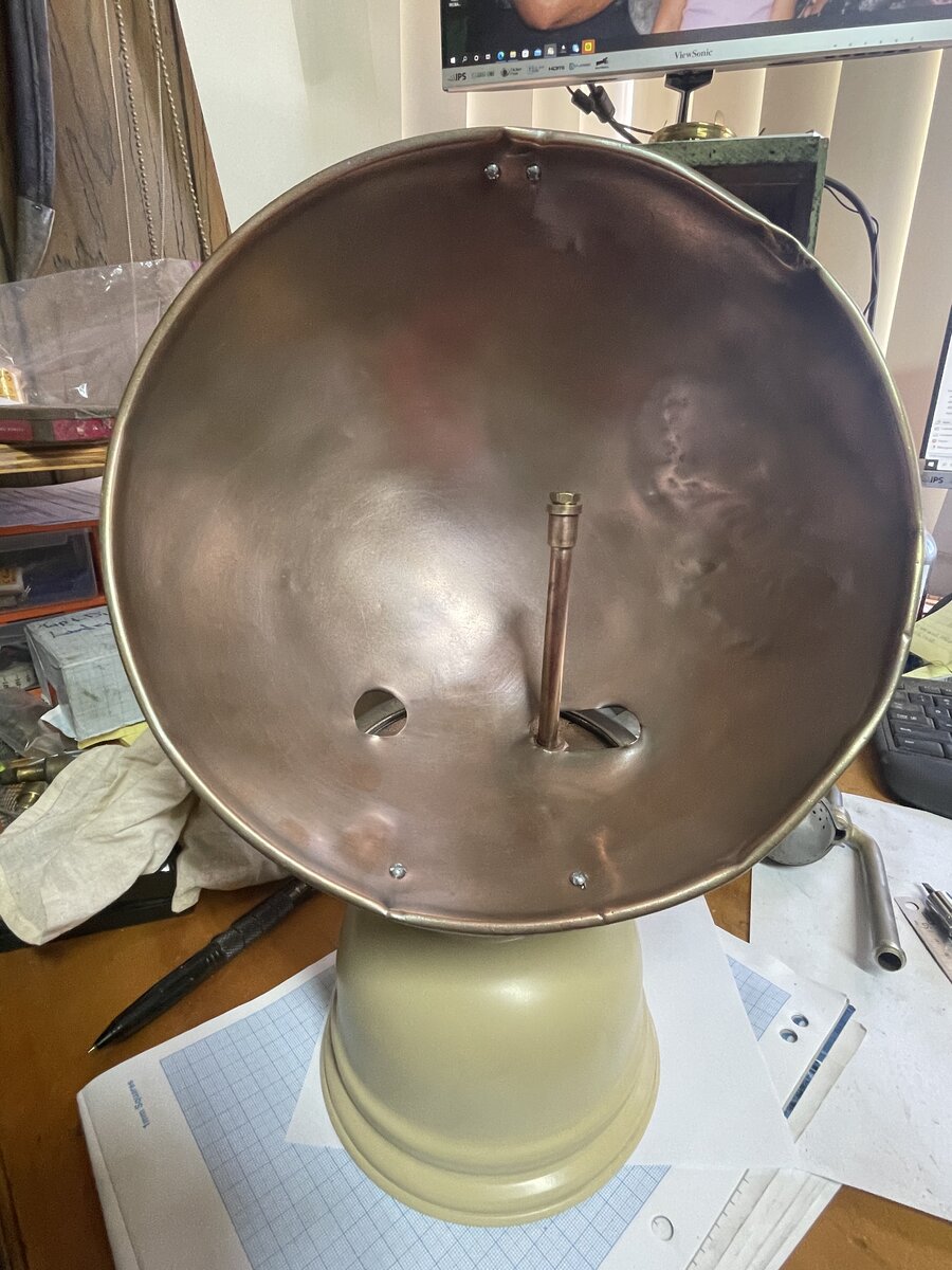

    Once the reflector is removed it looks like a normal lantern. I removed the vaporiser tube to see if the pricker needle was in good condition and it was.
    2853B4B3-9AF4-4A06-8069-A9DEA99F4505.jpeg 6B79CB22-0C9C-4427-9B63-2E3B8008EA70.jpeg A310D141-6C99-4C73-ABF0-AEF3048CCF66.jpeg FF00963B-BF63-4EBD-B576-0B2A12C982DC.jpeg

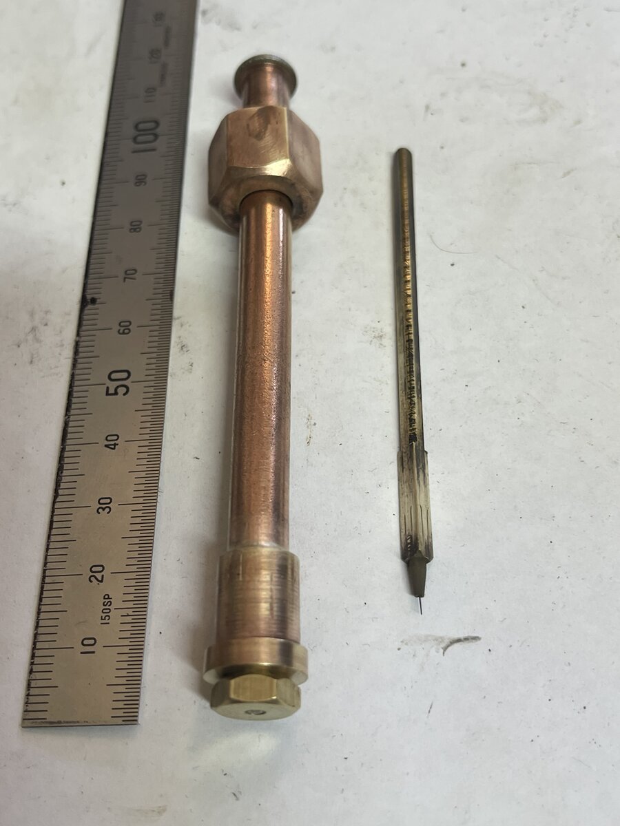

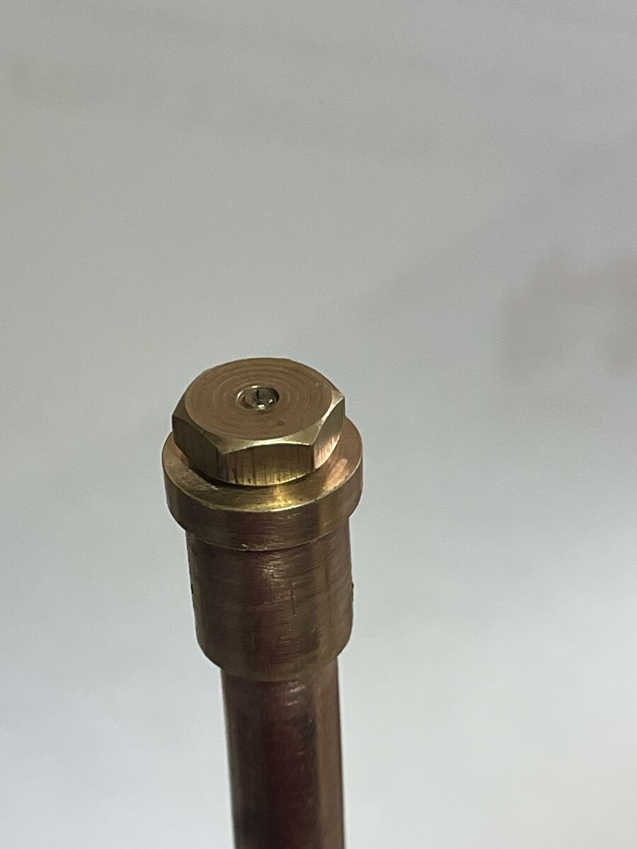

    the pricker rod comes in two parts and can be adjusted if need be, I removed the needle for safe keeping.This is the vaporiser setup once I had cleaned it up.
    FF21B24F-6706-4612-B971-5AA6FE82FFA4.jpeg 01A0DCEB-0226-4429-8159-CD56AF8E94EE.jpeg E4628B06-33DF-4B4A-9D27-62F26B3F1B02.jpeg 7FB9BCFA-FC0C-44FB-8019-057875E00DCD.jpeg D9D49A8D-E737-4EAD-9AEE-5361A99D691D.jpeg 891D32CD-6A98-4478-9277-F5A38DFF78AA.jpeg AE2C6961-6E14-4721-A46D-6D6C0D70B522.jpeg
    the jet size is small maybe1.5 of a mm ? I used the wire of handi kero pet to clear the jet.
    I didn’t remove or pull apart the fuel valve or pick up as it all was in working order I cleaned it up and used ultra high temperature paint.
    I cleaned up parts either in an ultrasonic bath or with my need blaster.

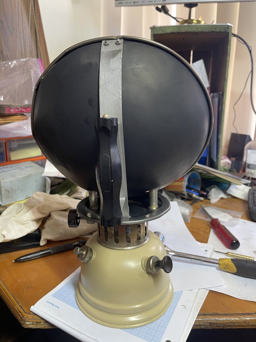

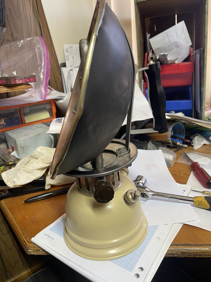

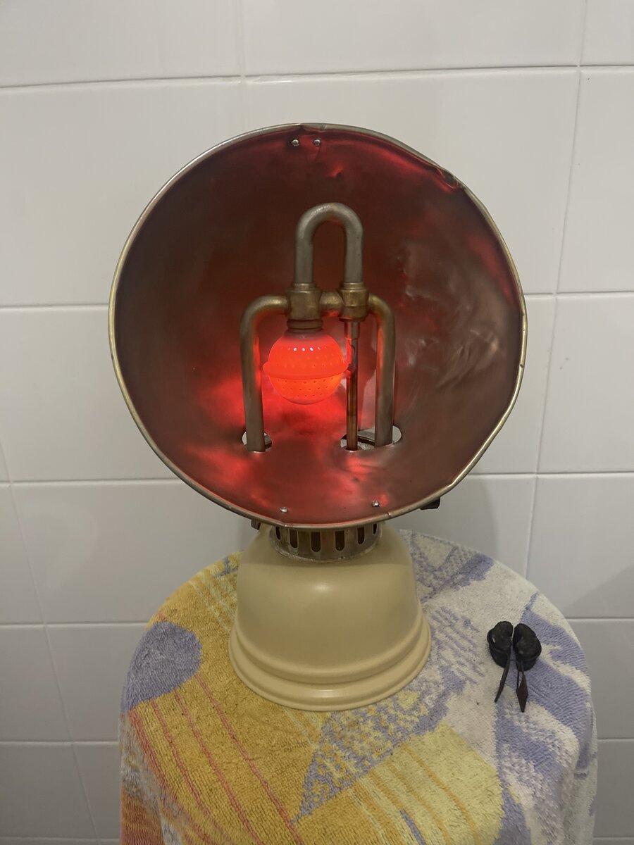

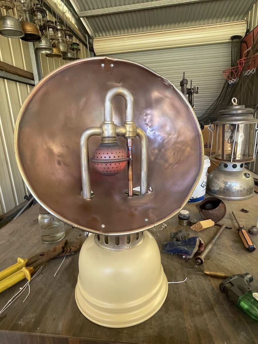

    It had original cream coloured B38650AE-23F7-44E5-B642-0E1B4C4925D2.jpeg 8509FC2A-EF48-4B19-956D-02AAB67CDF60.jpeg B332ACA3-91CD-4771-ABA4-CFD68C54BBFB.jpeg 625C0F02-2DAE-4A8F-8113-B6B245B59220.jpeg 87D236C6-40B0-4CA5-BD86-E8F19FC07239.jpeg AF4DA0F9-18AF-417D-8CCC-3B8FA2AF4CCC.jpeg A5E3F5EB-2ED3-4C09-84E2-A0B22F12E5EA.jpeg paint on the base so I went with the same colour. It looks very fitting. I reassembled the heater, the reflector cleaned and polished a new coat of black UHTP looking very smart.
    It a very cool looking heater unusual bit rare, I’m very pleased with the outcome
    I’d like to recognise and thank Neil @Mackburner and @ColinG for your valued assistance in the restoration.
    Now the money shot.
    33269373-FD41-415B-899C-8D7971167790.jpeg 35FB03F3-93E5-445A-BDF8-800312C59D0F.jpeg 12D81FF0-A151-4889-9873-D716A1DCFC28.jpeg 61CF2144-E681-4951-853B-DEBB6B07B74F.jpeg
    .I hope you all enjoy my write up and pictures of what is a very cool not so common unusual heater.

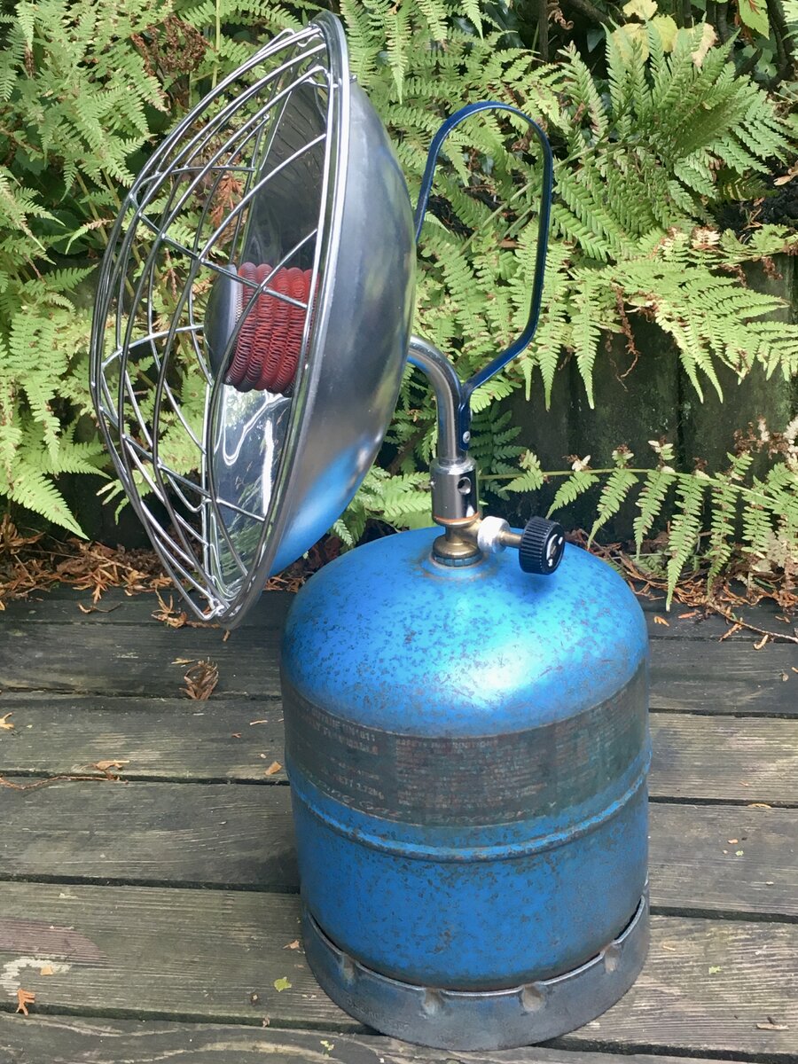

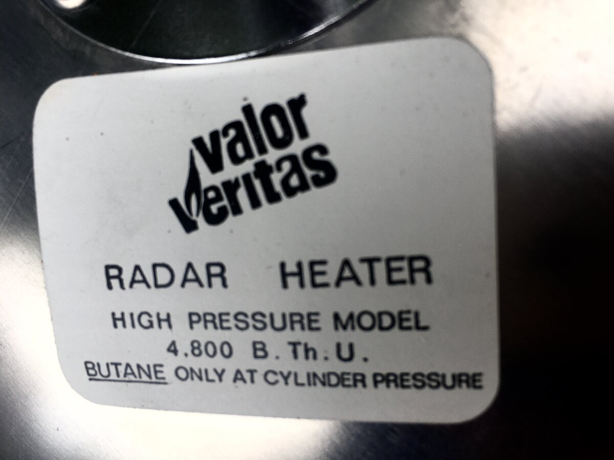

    Good work @Darryl Durdin Alas, not many years passed before butane took over.

    Well said Darryl. Still, it’s Winter here and the gassie has been put to good use in the workshop.
