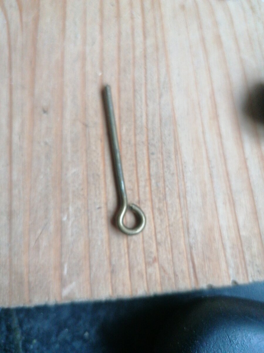

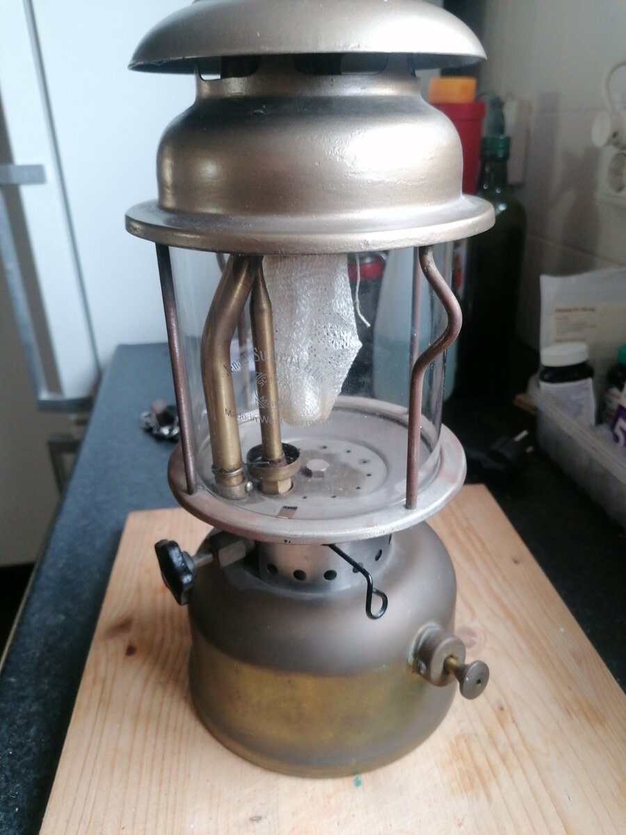

    I got this veritas via mail today, it looks Verry good and maybe new unused,
    But here's the thing, I wanted to check pressure, but I could not get pressure in the tank, so I removed the pressure valve, and it's a odd thingy, a little ball incapsuled, and another threaded thing that screws inside the valve with a little point that pushes at the little valve ball.
    If it's all the way screwed in I can't get anny pressure in the tank, if I loosen the middle screw I can, is that normal? Am I doing something wrong?, also this thingy was taped to the bottom, donno what it is image-16-05-2026_19-04-22-24.jpg image-16-05-2026_19-04-29-89.jpg

    Hi @Loe nice find :thumbup:
    its a P350 and can use naptha although some seem to run ok on paraffin ?
    thats why it has the positive shut off similar to a Coleman or AGM?
    have a look in the gallery under Veritas
