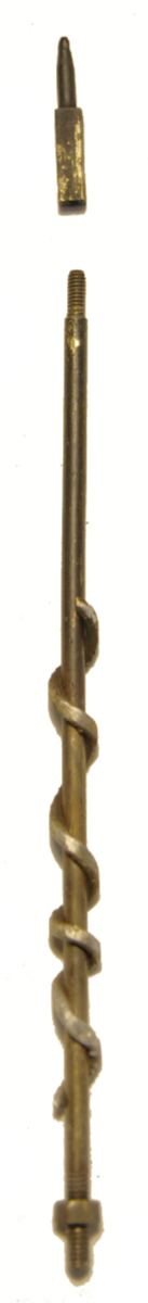

    Meanwhile, this Veritas, -I'm trying to assemble the Vaporiser (V2/31) but don't seem to have a pricker spindle atomiser (?) the right size to go around the spindle and into the vaporiser tube. Does anyone know if it's a spiral wire wrapped around the spindle or is it a brass wire gauze wrapped around it like an Austramax? Any ideas?

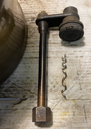

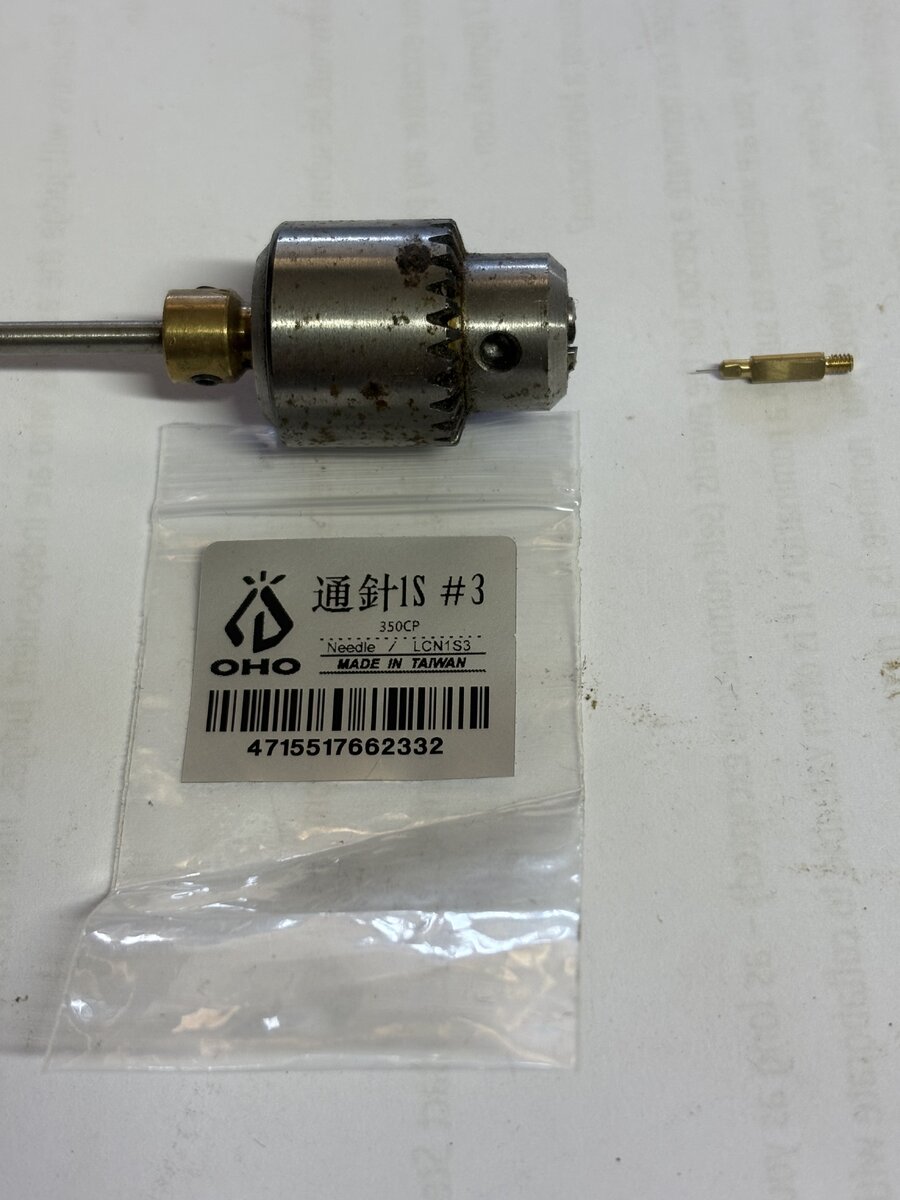

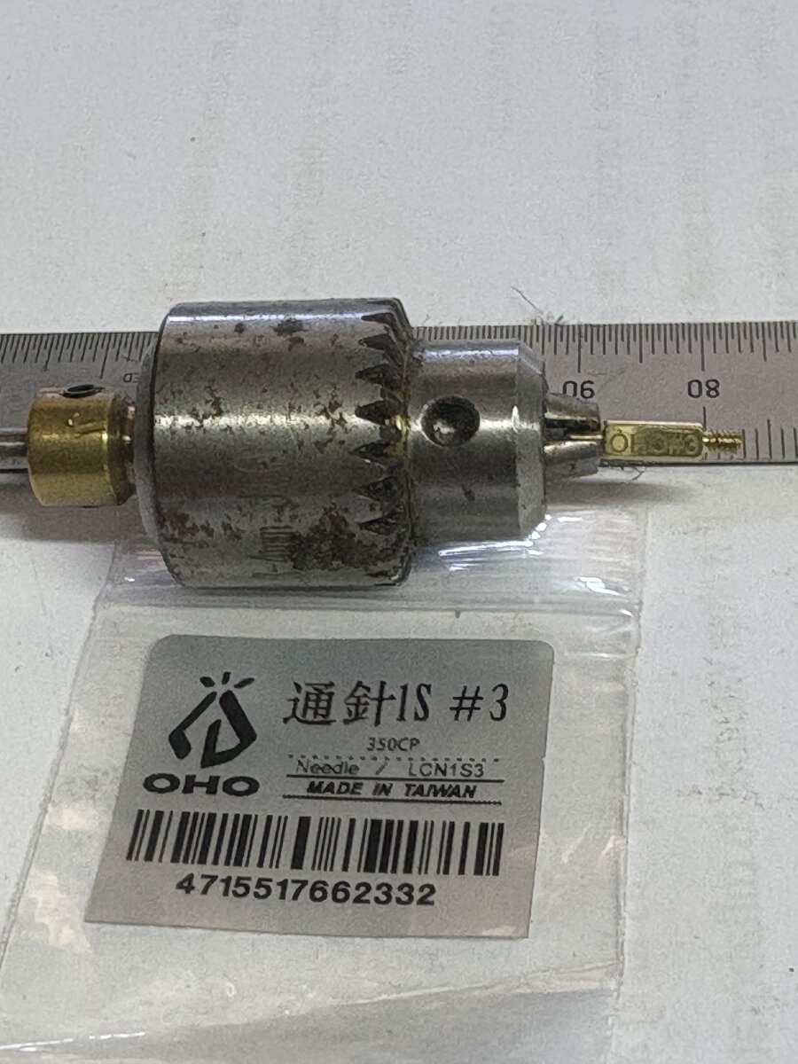

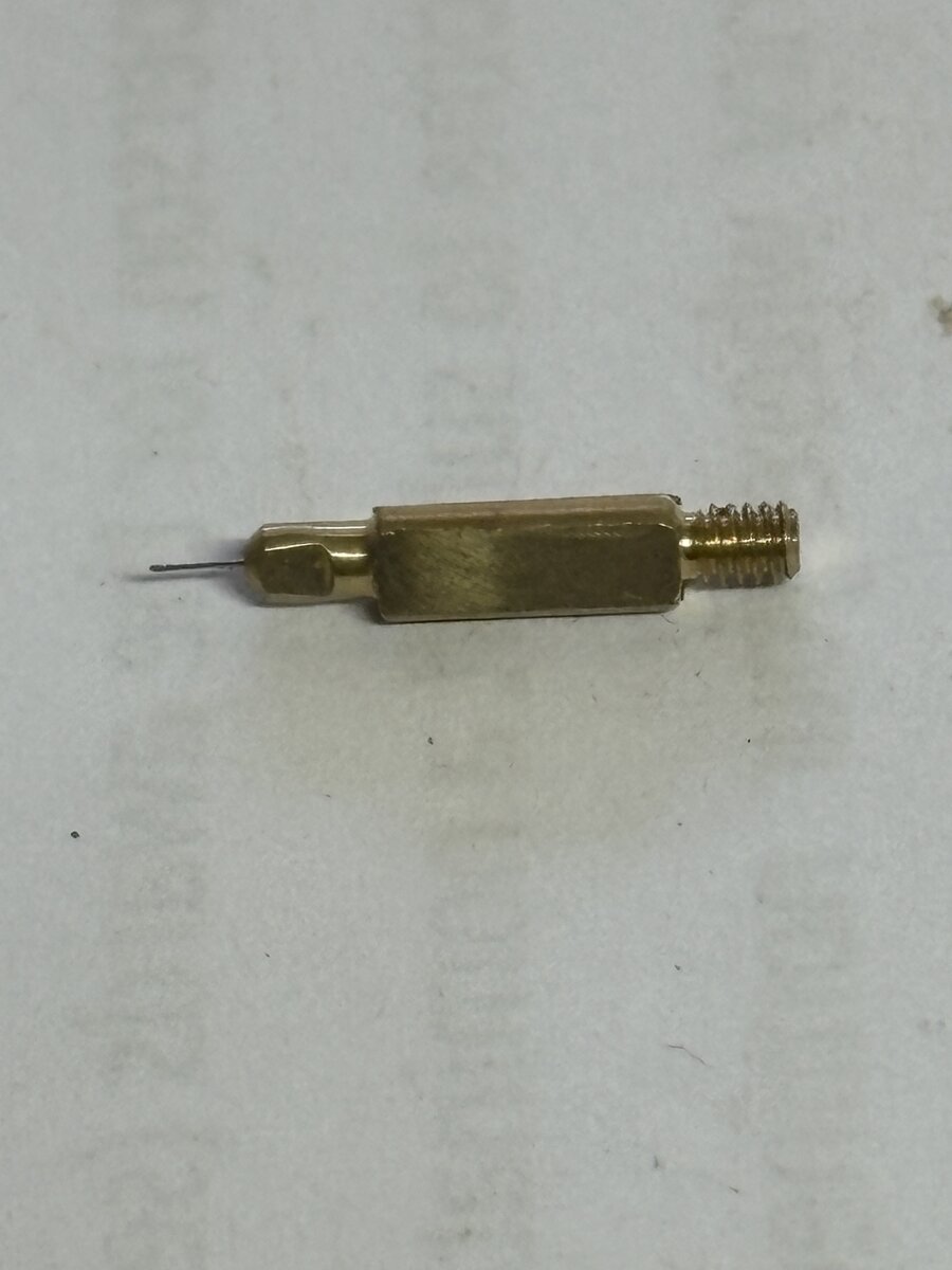

    Right... I've found some old photos so I can probably figure it out for myself. Veritas4073opt.jpg VeritasNeedleOpt3972.jpg VeritasPackerOpt.jpg

    Now... that nice lump of brass, your opinion... to polish? or to leave patina?
    That wire spiral has been wound then flattened a bit by the looks of it. That could be fun. I wonder how critical the shape and form is. Suck it and see maybe.

    @Julian Whittaker . just make it out of the fine mesh wrapped around the rod. I don’t think it will make any difference. It’s just to restrict the flow as the heat vaporises the fuel turns it into vapour under under pressure. Check out my threads in the gallery under veritas.

    Julian, the Veritas 350 didn't have anything wound around the pricker rod originally. That wound wire has been added by an owner, probably trying to reduce flicker in the lantern.

    Interesting Martin, nothing around the spindle originally ?, -though I notice one model does have a gauze. (in other brands '50's 350) -Would be pretty difficult to add a gauze to mine, as the I.D. of the tube is only about 4mm. Yes I do have all parts I think... new pricker ordered from TW Sands, new glass. I'll know after I test it next week. Ta.

    I had completely forgotten my 'other' Veritas that I gave away years ago... found it in the Gallery. My theory is that the Needle fitting restriction shape works as a sort of diffuser obviating the need for a gauze or similar around the needle spindle.
    That make sense?
