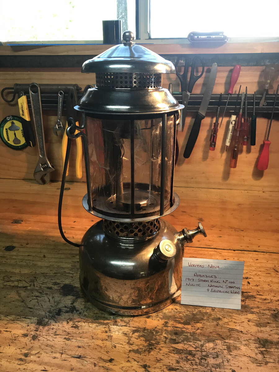

    Some months ago, on the Bay of Evil, I won this Veritas Nova Lantern.
    Although the lantern is badged as a Veritas Nova, it’s clearly a NULITE Storm King manufactured by the National Stamping & Electrical Works in America. It was then rebadged by Veritas as their NOVA lantern and sold. The approximate date appears to be somewhere between 1917 and 1920.

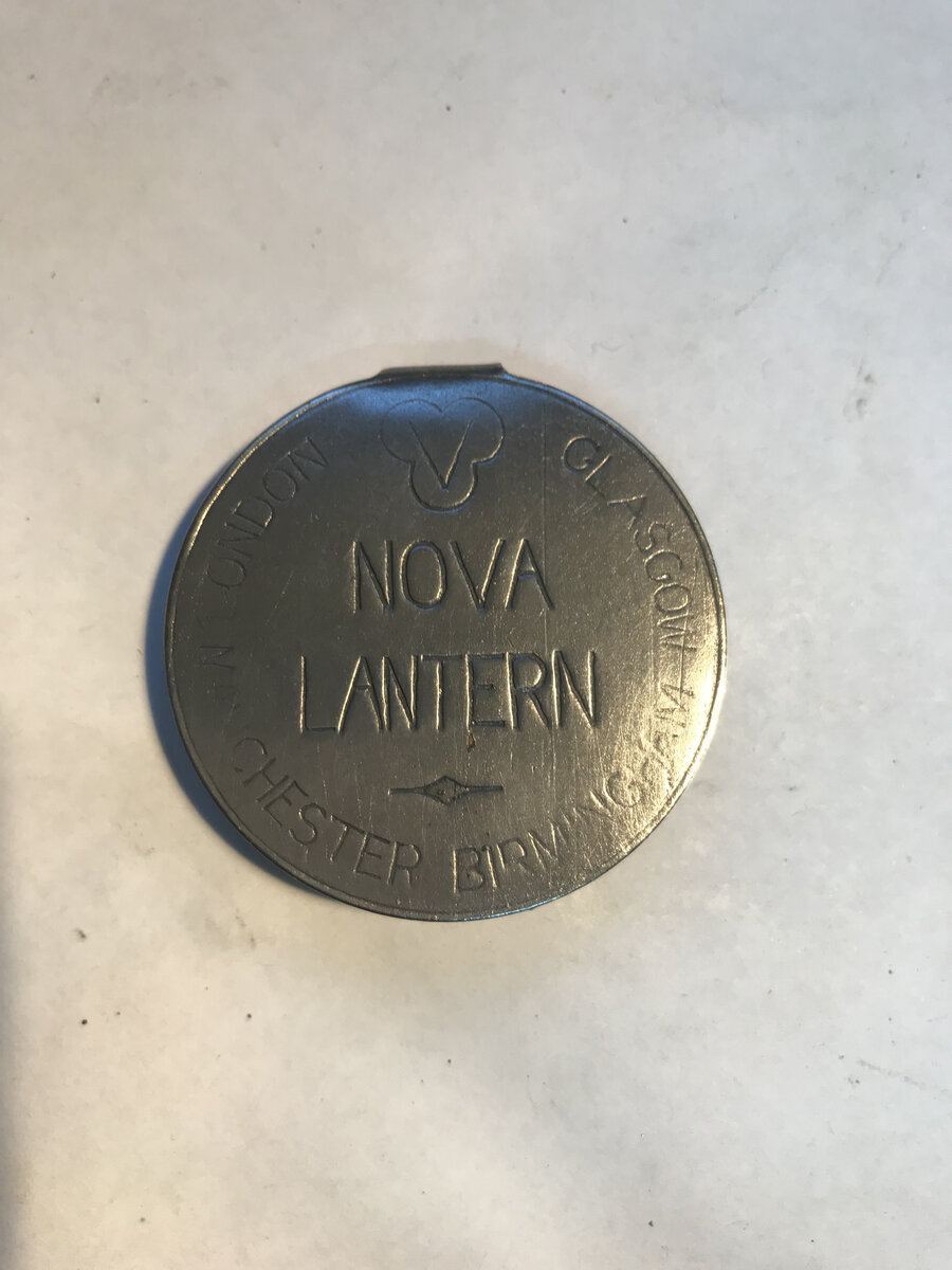

    The following name disk, with the Veritas logo, was installed onto the frame’s base.
    The nickel-plated brass lantern was fitted with a mica chimney/globe and it appears to be original to the lantern.

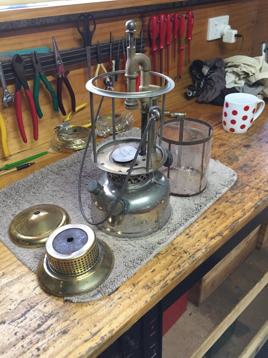

    The lantern was found to be in a clean and tidy condition however, on a closer inspection the following issues were evident:
    • The fuel filler cap, that once housed the external pump connection had the pump connection removed and the remaining hole in the cap soldered up.
    • The control valve wheel/knob was at best a sloppy fit, it appears a bush was missing.
    • The lantern’s jet pricker wire was missing.
    • The lantern's hood components had their original nickel plating removed showing a polished brass finish.
    • This model of Nulite Storm King lantern utilised an external hand pump. At some time in the lantern’s past, an after-market pump was installed into the fount/tank. The pump was not working. Further, the foreign pump knob, shaft and retaining cap were unplated brass.
    • The mica chimney/globe is whole but the in a poor structural condition.
    Notwithstanding, the lantern was found to be in a reasonably good condition.

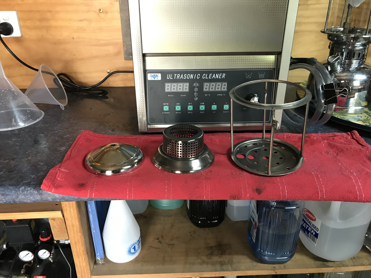

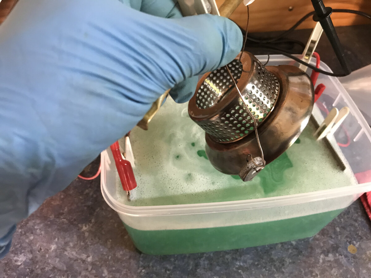

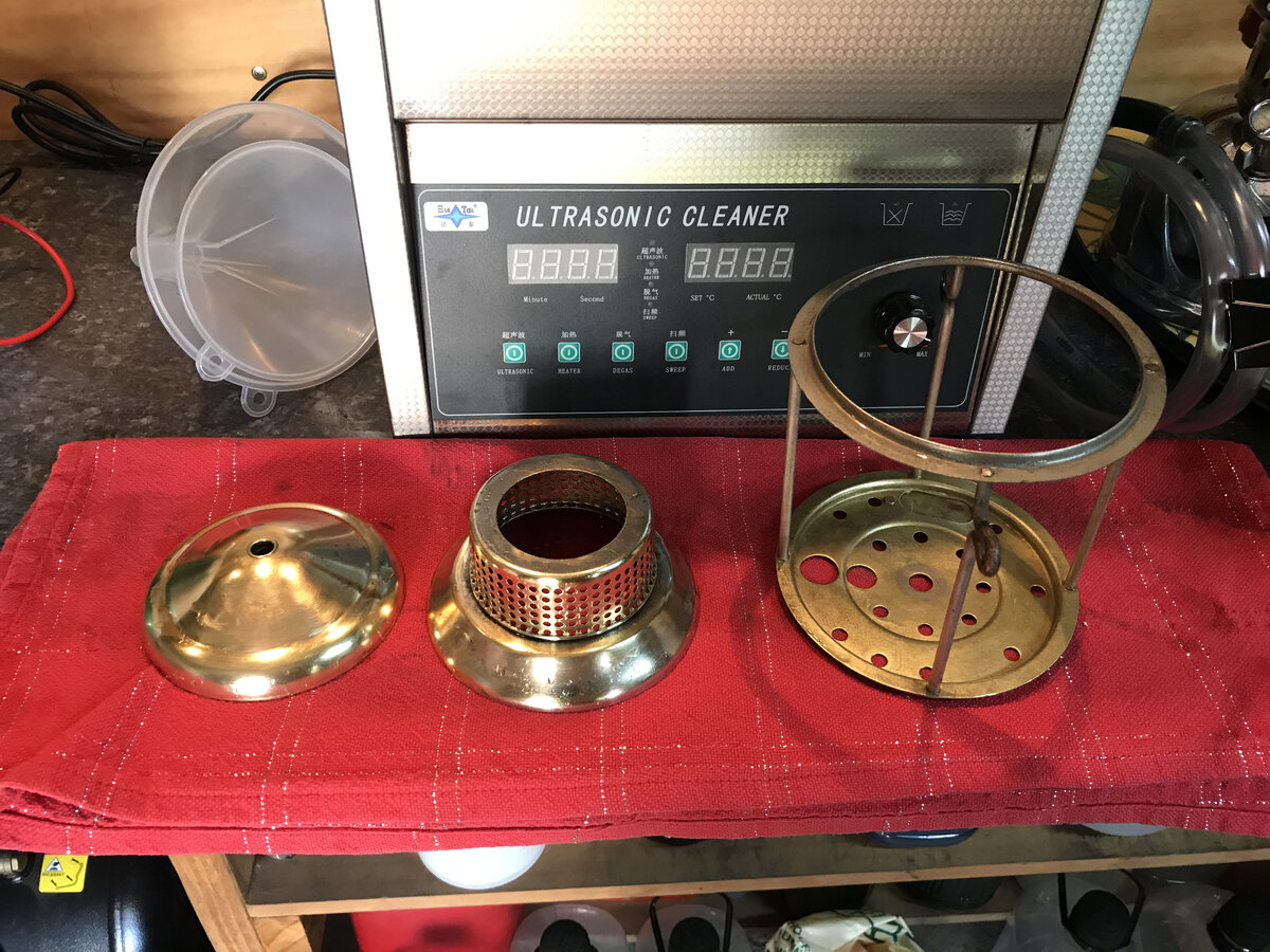

    The lantern was dismantled into its various components and cleaned. It must be noted that all parts appeared to be clean and tidy. The generator was found to be clean with no build-up of carbon deposits.
    Notwithstanding, excepting the mica globe and fount, all parts were immersed into vinegar bath for about ½ an hour, removed, rinsed in clean water, and put into a sonic cleaner to remove any rubbish and dirt from inside of the generator, jet, burner, and other related parts.

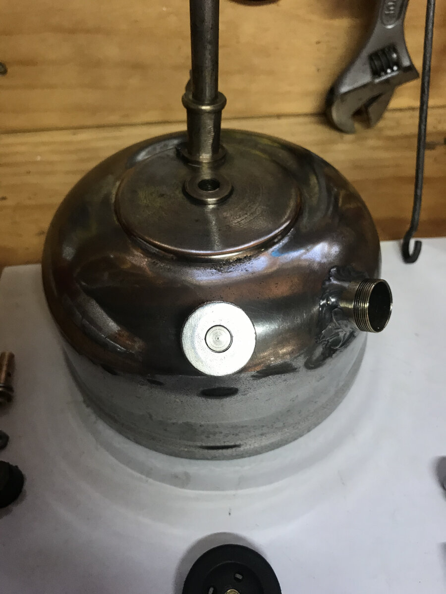

    The Fount (Tank)
    To preserve the original finish, the brass nickel plated fount was carefully cleaned with a hand detergent using a soft brush and then polished with Mothers Mag & Aluminium Cleaner. The gentle cleaning exposed the original nickel-plating in reasonable for age condition with multiple blemishes caused by age and use.
    The Filler Cap
    The original Nova's filler cap had an external pump connection thumb screw fitted in the top of the cap to allow pressure to be added to the tank. A similar type of connection was used by Coleman, Akron, and other manufacturers around the early 1920s and 1930s.
    On this Veritas Nova’s filler cap, the solder was completely removed, and a new brass disc was machined on a lathe and subsequently nickel plated. Once the cap and new disc were put together a viton washer was used to complete the seal.
    The finished cap is shown installed onto the fount/tank.

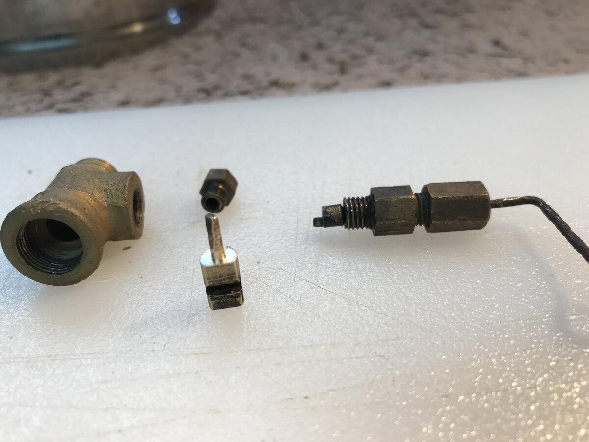

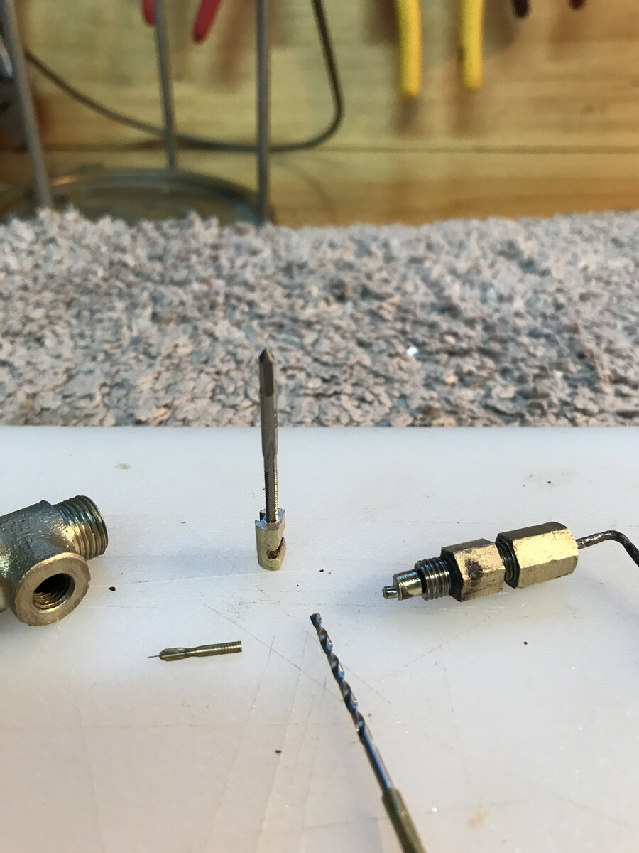

    Jet Pricker
    The jet’s pricker mechanism, although operational had the actual pricker wire missing.
    Further, the actual pricker rod was cast into the eccentric block. This meant that if the pricker were to be replaced, a new eccentric block would have to be sourced. As far as I’m aware, there are no pricker parts available for this lantern.
    What to do?

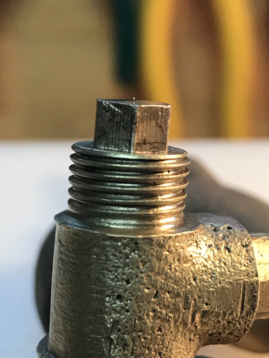

    The pricker rod was cut from the eccentric block and then the eccentric block was drilled and the hole tapped to M2.0 such as to allow a replacement pricker to be screwed into place.
    A new pricker was manufactured from 1/16” brass tube threading one end with a M2.0 die.
    The new 0.006” stainless steel pricker wire was crimped into the other end using my home-made for purpose crimping block.
    The following is a picture of the now functioning pricker with the tip of the pricker wire appearing out of the jet.
    Now, anytime the pricker needs replacing, its now a simpler process to replace the actual pricker without the need to replace the eccentric block.

    The Money Shot
    The assembled Veritas Nova lantern's single burner was fitted with a mantle and then fuelled with Shellite. After a few pumps of pressure the control valve was opened for a second and closed. After a bit of fiddling the lantern was lit.
    Pumping a further 60 strokes on a near full tank of fuel, the lit lantern settled down and ran flawlessly for over an hour.
    After the hour’s test run the lantern was turned off by closing the control valve.
