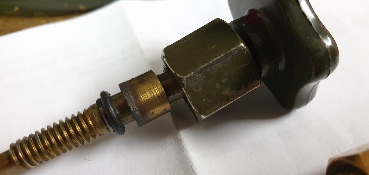

    Recently I acquired a Veritas P350.
    The generator, burner, air tube and valve assembly were all clean.
    Oiling the pump leather and a new washer on the filler cap enabled me to light it without any real problems.
    There is only one issue an that is that there is a quite a leak at the valve control once the the valve is opened.
    Here is a picture of the valve stem:
    Compared to a 220C valve stem, my P350 valve does have the graphite packing and a second brass bushing.
    There is only an O-ring and a wider brass bushing.
    I have added a Coleman graphite packing and it reduces the leak, but does not completely solve the leak.
    Does anybody know what the P350 valve stem should look like?
    Thanks!
    Dion
  2. Brenneman Netherlands
    Nov 11, 2018
    128
    The Netherlands
    Adding a smaller Coleman brass bushing and a graphite packing did the trick.
    As the control knob is glued/molded onto the valve stem, I had to pry out the snap ring first to be able to slide the bushing on the valve stem.
