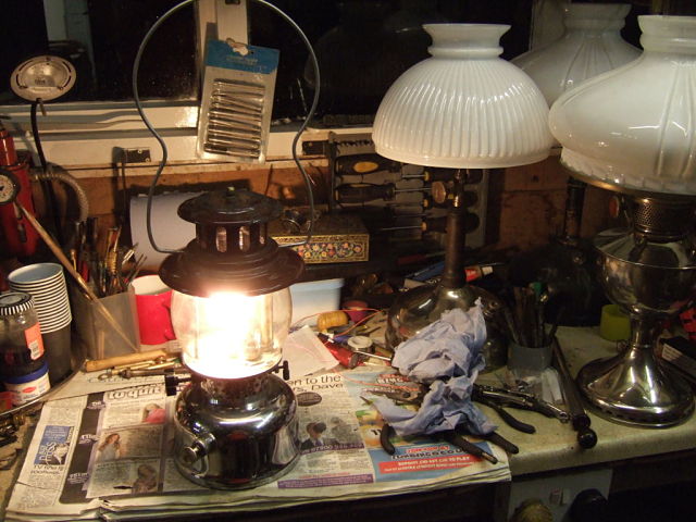

    Hi All

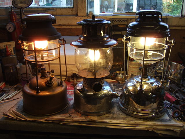

    I won this Veritas Superb lamp from ebay & was informed by several members here that they are a bit of a sod to get working properly :doh: :roll: :whistle: , but with a bit of persistance & luck i managed to get this fickle lamp to burn & stay lit [-o< :shock: :D :thumbup:

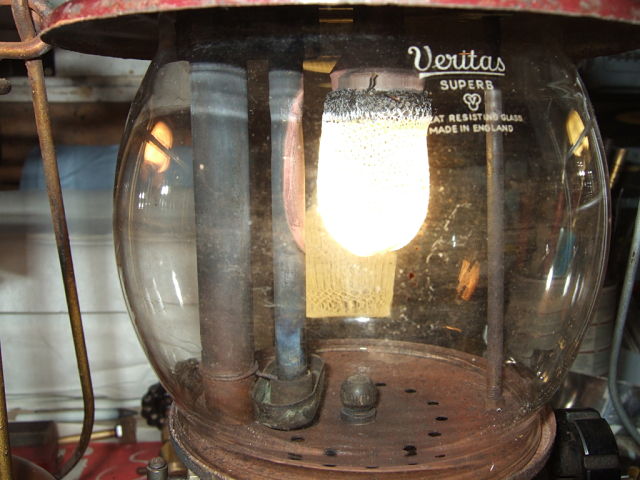

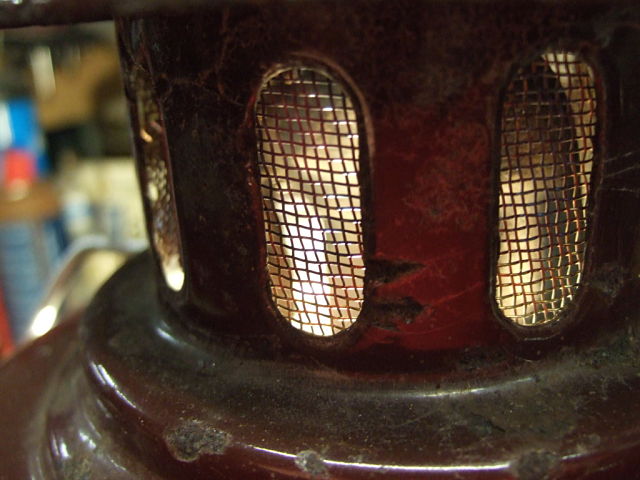

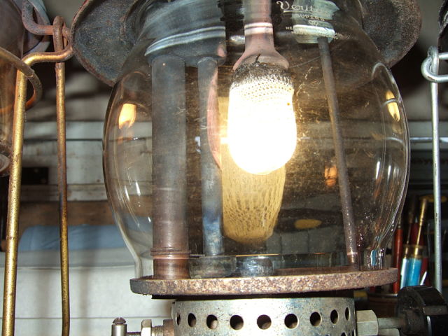

    I have used a Coleman 500cp mantle on my first attempt & on this one i used a Bullfinch gas mantle as it was all i had , in the pictures you can see the area of the vapouriser being heated by the mantle quite well :D :thumbup:
    The lamp needed a lot of TLC to get it this far as the pricker needle was shot & i had to make a replacement tip i also had to improvise & re-size the jet because this was quite worn & seriously over fueled :doh: :shock: , next job is to do some cosmetic work now it's running
    If any of our members from Finland or in that region has any idea for spares please get in touch :D :thumbup:
    Best regards ,Stu :D :thumbup:

    Hello Stu, excellent fettling to get it working, :thumbup: but how long does it work for? Jeff.

    Hi Jeff
    Over 2 hours before i had to shut it off & go to work this morning :doh: :roll: my wife had to drag me out of the workshop & send me off to earn a crust :D , but will light it up tomorow again & see how it goes :D :thumbup:

    Hello Stu, over 2 hours for a VS., is great, perhaps you have obtained a decent example, [-o< :thumbup: Jeff

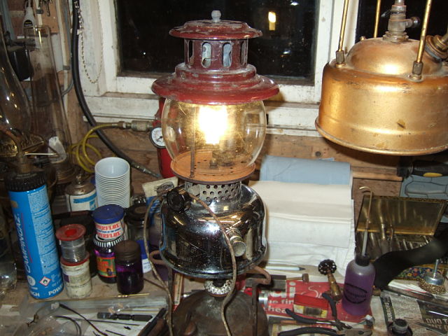

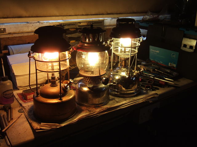

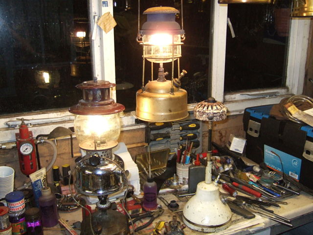

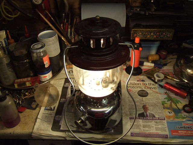

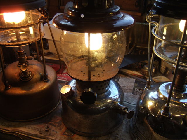

    Here are some more pic's from this evenings testing :D :thumbup: , the Superb has been burning for three hours this evening from just after four untill now :D :thumbup:
    The Stuman vapouriser is now on test in the X246 pork pie hanging up next to the Superb & a Bialaddin T10 on the bench , i got the base from ebay & it arrived today , but i already had the top part lolling around the workshop for ages .
    The Superb finally worked for about four hours this evening & not a hiccup [-o< :D :thumbup:
    Stu :D

    Indulge me, please, and try running it outside for a couple of hours tomorrow evening. I had one of mine running outside for 40 minutes a few years back. I could be wrong but I suspect it failed because it was evening and ambient temperatures were dropping... :roll:

    I'll give it a go David if it's not raining & Nils That's a 1925 Primus stove & is one of my oldest that the Veritas is sitting on 8) :thumbup: this was so as i could see the lamp while i was having my dinner from my conservatory , just in case of a flame out :D :thumbup:

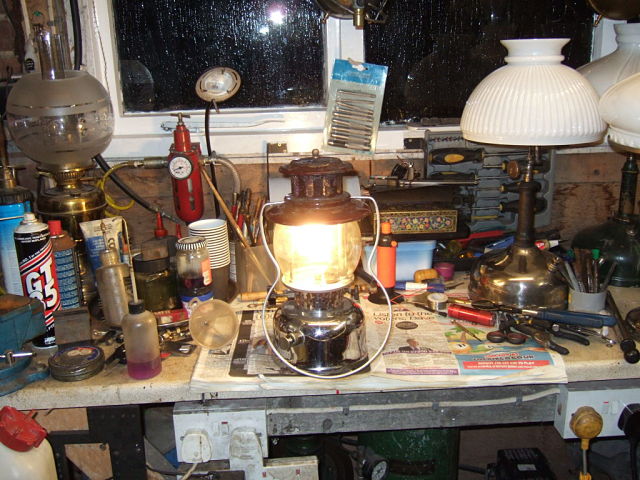

    I have tried a bit of an experiment this evening using panel wipe in my Superb instead of Kero , i changed the seals to viton & re-built the burner head again as the mesh flame retarding disc was too small , i now have a bigger cutter :D :thumbup:
    The lamp seems to work well on this fuel & the flame front seems to be a bit more stable in the mantle , no sooting up :D/ :thumbup:
    I also put a ring of mesh in the hood top vents to keep some more heat in & this helped too :D :thumbup:
    It does seem happier :D :thumbup:
    Stu :D :thumbup:
