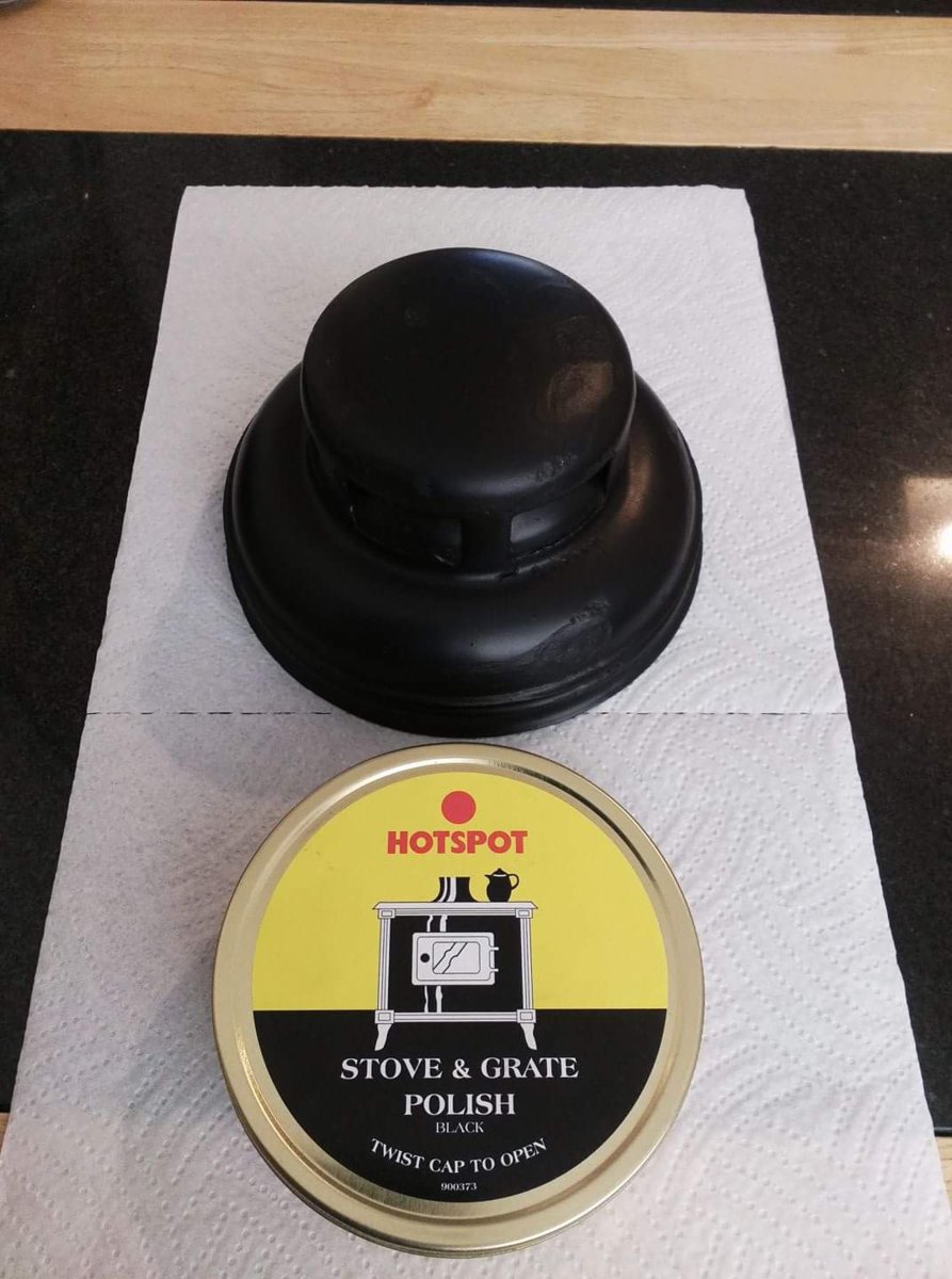

    I have sprayed Tilley hoods with stove / BBQ paint and had no problems. It is usually good for about 700 / 750 degrees C which is more than enough to cope with the heat output.

    I have used stove paint before but have yet to find one that gives a gloss finish- they all seem to be matt.

    Stove polish gives a little bit more shine than VHT paint. But I suppose there is no substitute for enamel.
