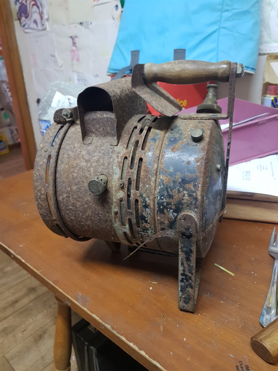

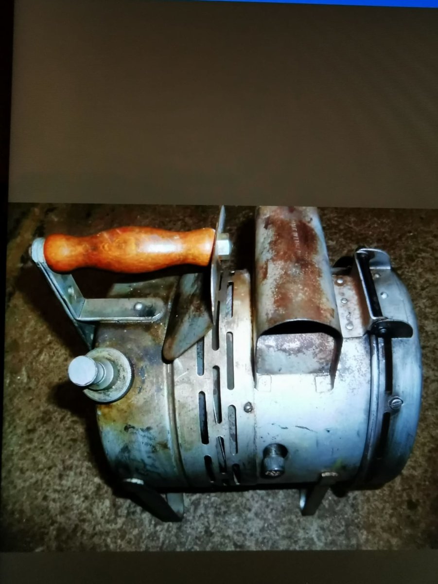

    Well not buses..but I have been on the lookout for a reasonable AL21 for ages, picked up two a few weeks ago and then another from Germany last Tuesday..and here is the latest. IMG-20200210-WA0015.jpg

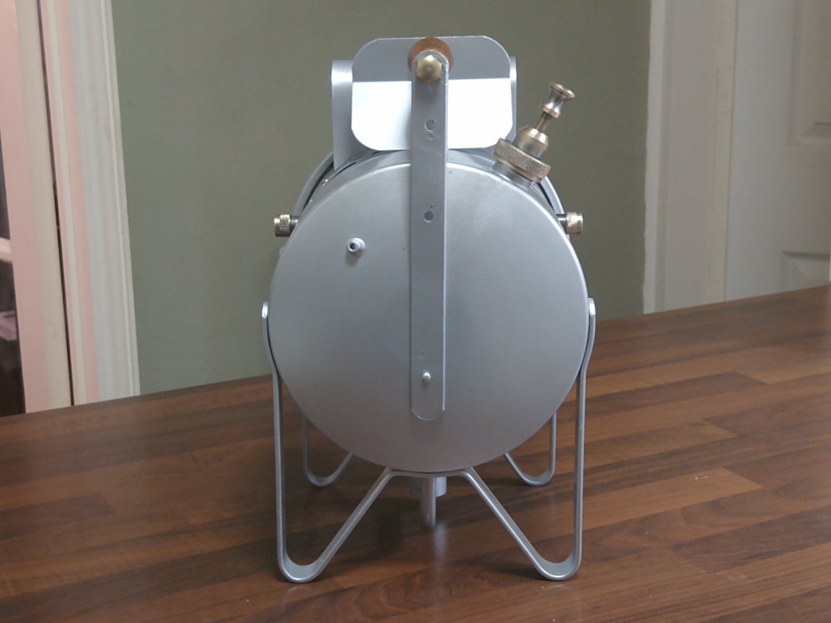

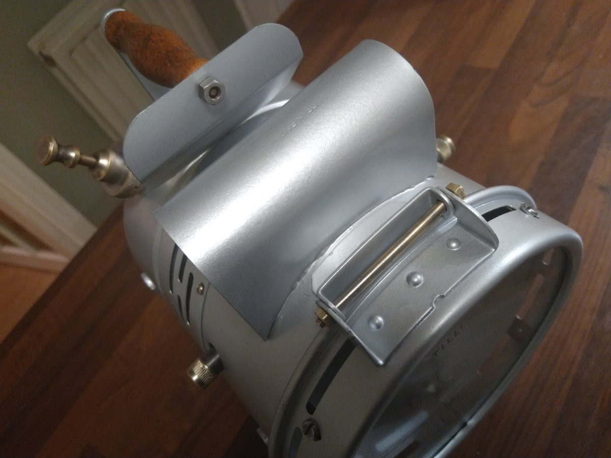

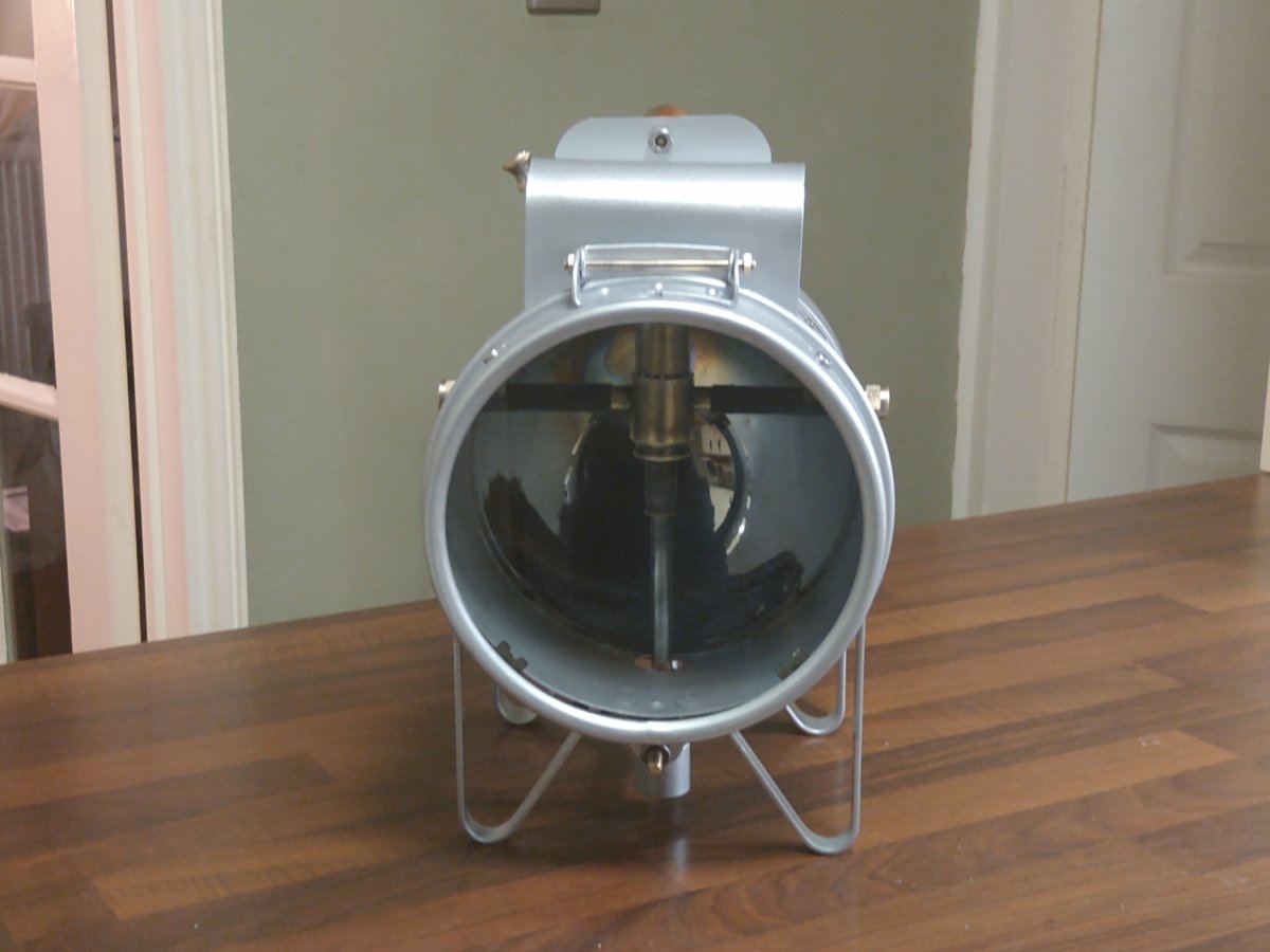

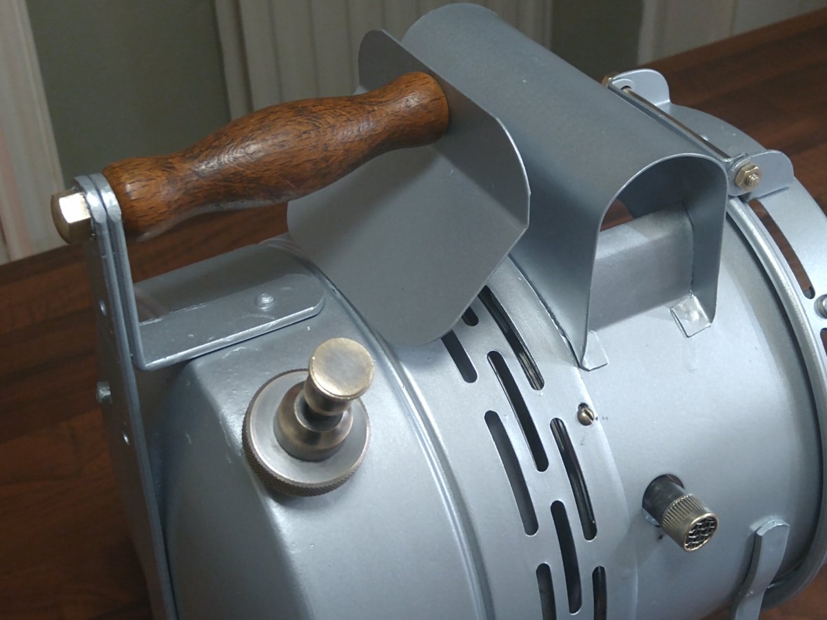

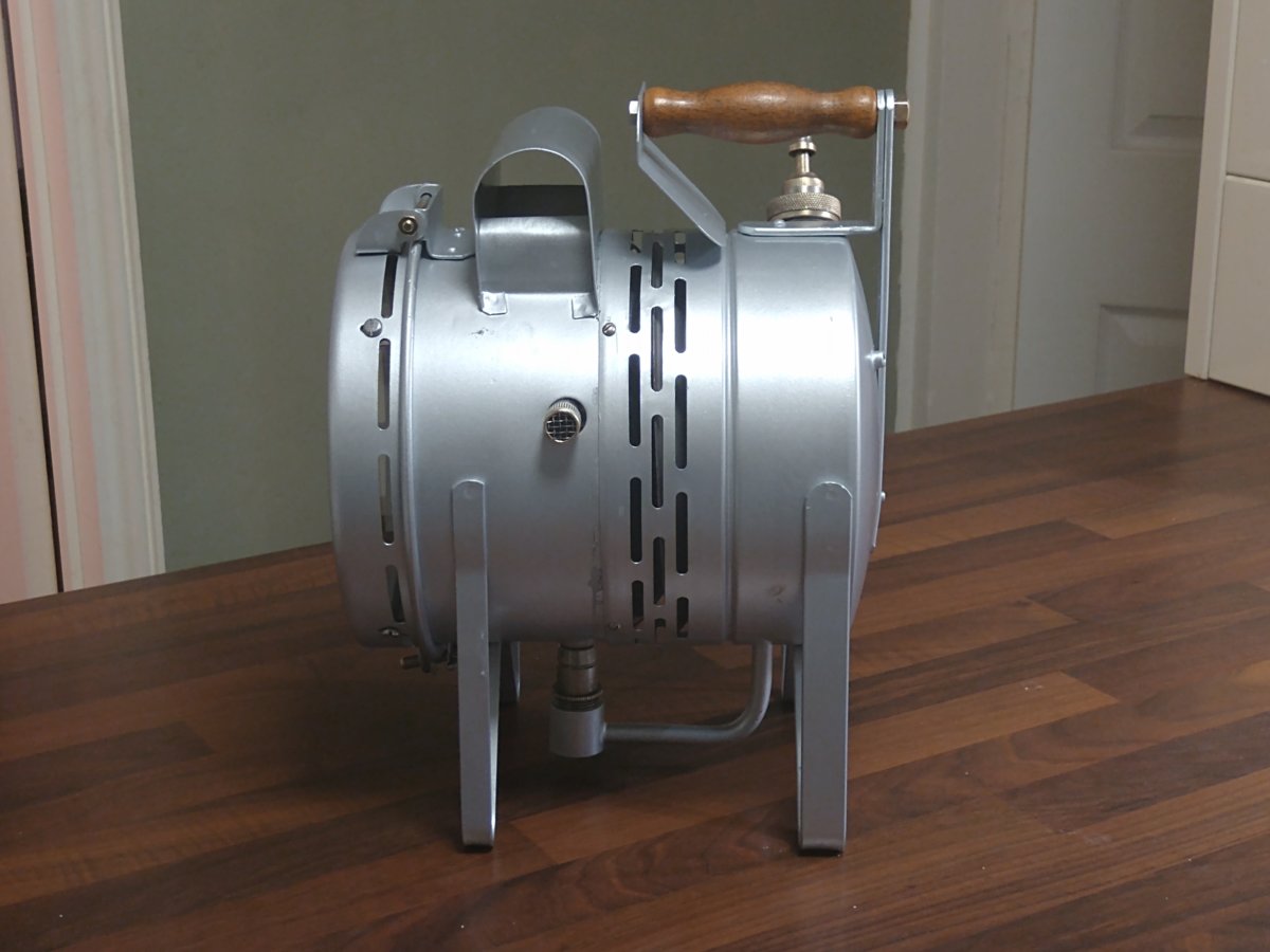

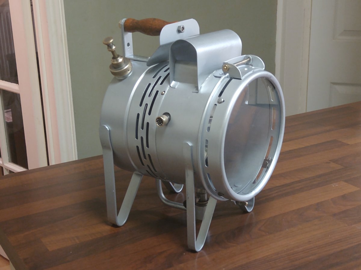

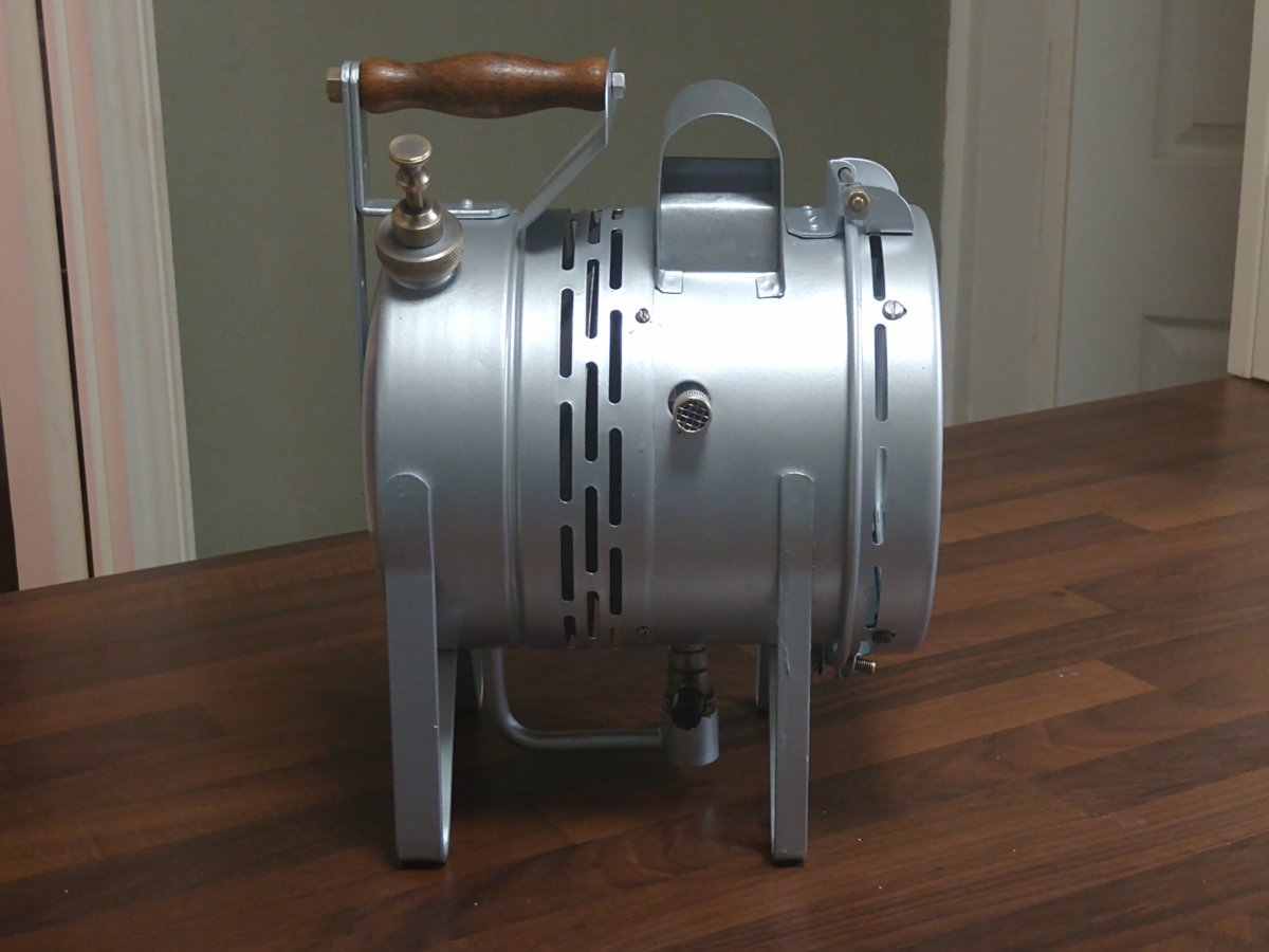

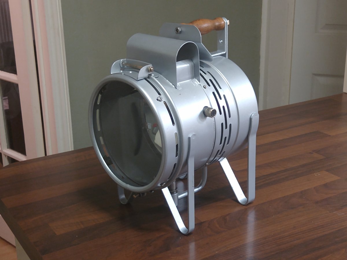

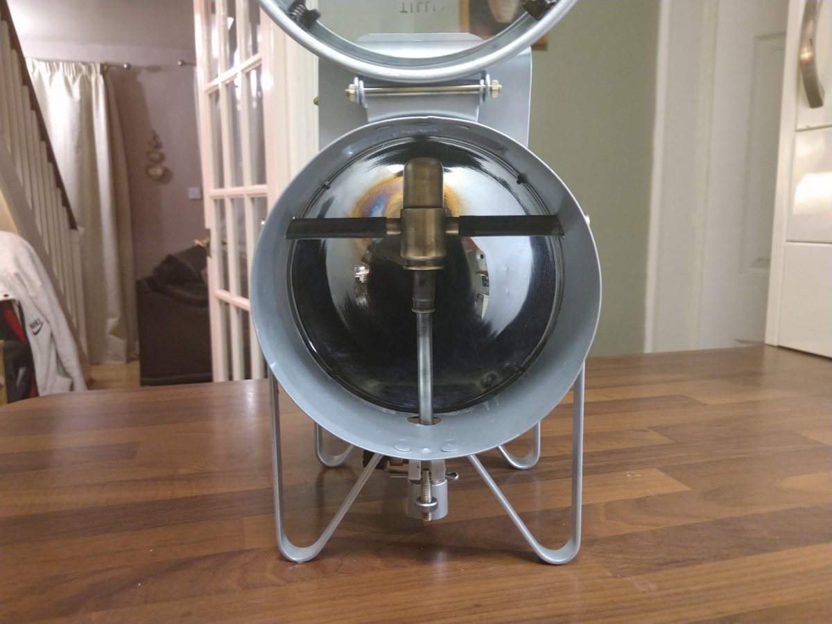

    Lol...yeah I know, arrived Friday and here she is now. IMG_20200210_191155542.jpg IMG_20200210_191211901.jpg IMG_20200210_191250002.jpg IMG_20200210_191336929.jpg IMG_20200210_191356760.jpg IMG_20200210_191445437.jpg IMG_20200210_191459726.jpg IMG_20200210_191624178_MP.jpg IMG_20200210_191653758.jpg

    Wow - Nice work!

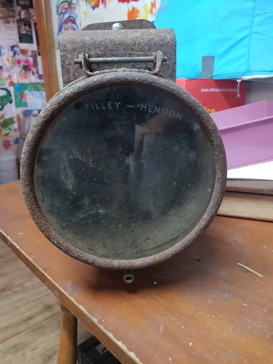

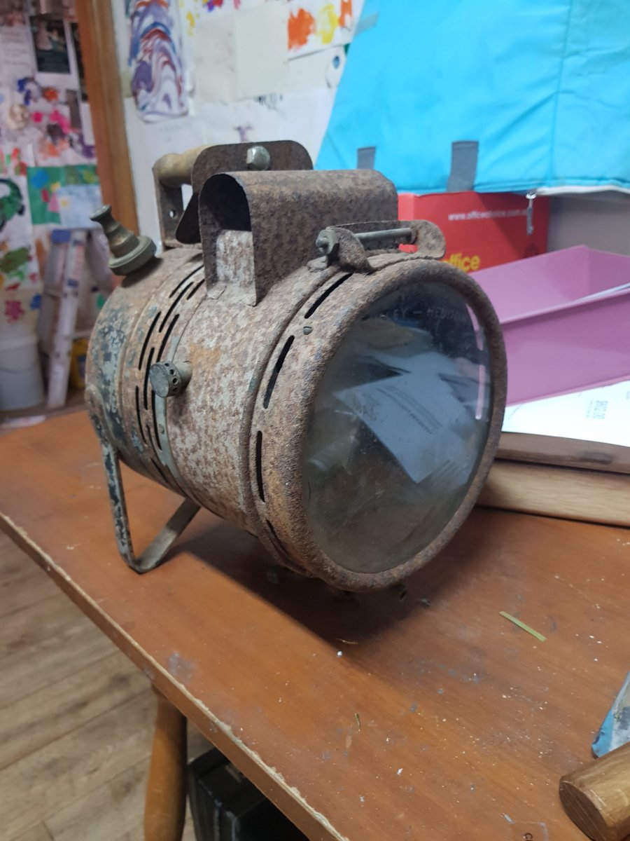

    20191112_085300.jpg Very nice, i hope i can restore mine to look that good

    What a find!! This looks like NOS, is it?
    What a real beauty! If I came home with something like this the little woman would probably "shove" it someplace where the sun doesn't shine! lol
    WOW!:mrgreen:

    That is the lamp George..in the first pic. However, I think I was lucky Darryl/George, the lamp looked much worse than it actually was, mostly cosmetic, no real rust to speak of. But I'm pleased with the result. I'm really loving my AL21's
    Black is a little more forgiving Darryl..I wish you all the best with your fettling..

    You have done an awesome job on the restoration.
    Is that a hammer tone finish? I like it.
    Did you polish the reflector in the lamp, what do i need to look out for, do or don't ?

    Be very gentle with the reflector. First just clean with water and detergent to see what state it’s in.
    You can then decide if it can be polished (very gently), but sometimes they are worn beyond redemption.

    You cannot polish the reflector at all, the plating is very soft! As stated, wash with warm soapy water

    I used T cut on mine.polished up nicely but doesn't remove all marks.

    Nice lamp. what silver paint have you used for the hood / above burner?

    Hi temp type for exhaust manifolds and I picked some Kia silver from a local seller for the rest of the body, 4 for a pound bargain (small 200ml cans) and most of a large can of Valspar primer. Sprayed in less than ideal conditions i.e. in a cold shed with a small blow heater doing its best to take off the chill (it was snowing outside at the time lol)
