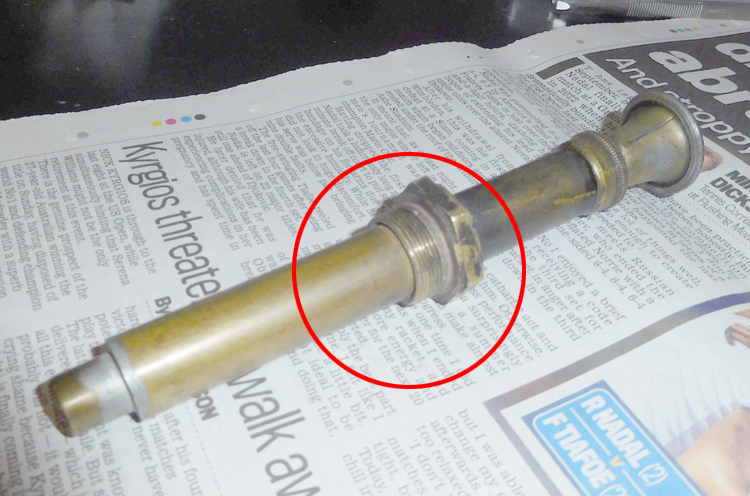

    I will start off buying a couple of washer kits but thereafter as I have several items I would like to make some of my own.
    What materials should be used for various washers.
    What sort of thickness.
    Where to purchase (uk)
    Items are Tilley lamps / blow torches / Optimus stoves.
    Example:

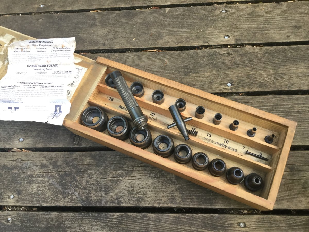

    Viton’s good for many applications but fibre on that one, since anything softer would distort on applying torque to the hexagon flats. Novus sheet gasket material is ideal because it is heat-resisting too and can therefore be used to make burner sealing washers.
    Investment in a decent set of punches is justified only for regular use to cut your own seals, otherwise go with Fireexit’s suggestion to buy ready-made
    My Maby punches.
    Maby website

    Yep, preferably fibre gasket for that example. Otherwise, lead sheet if its not going to be unscrewed often. Lead deforms irreversibly and can usually be used only once or twice if you're lucky.
