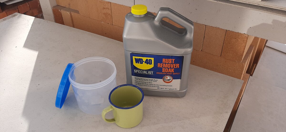

    Anyway, I've finally purchased a gallon of the WD-40 Specialist Rust Remover Soak. It arrived weeks ago. Been quite busy of late, so hadn't got the right time to work at it until now.
    I'll start with a very simple test.

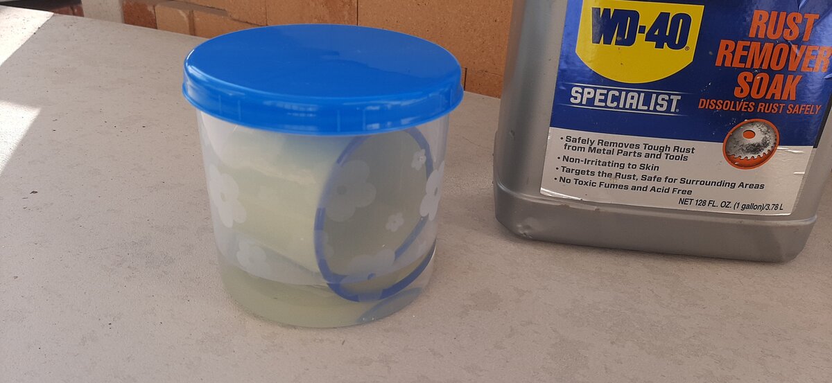

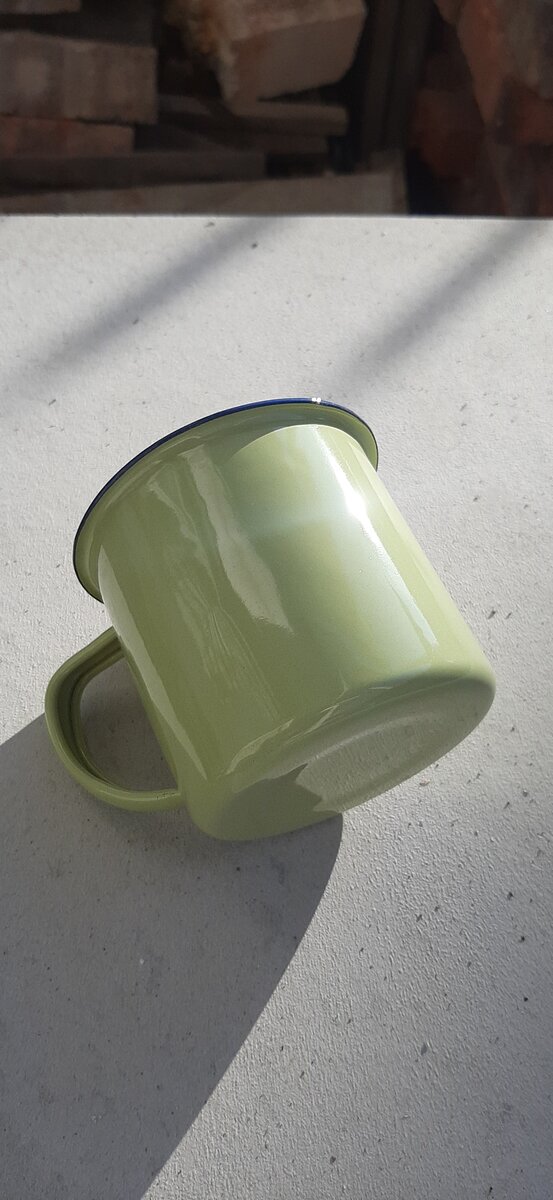

    Here are the basic stuffs. An inexpensive(kind of hesitated to use the word 'cheap') vitreous enamel coated steel mug, a plasic(polypropylene) container with a lid and the said WD-40 Rust Remover Soak:
    The primary purpose of this test is not to evaluate its rust removing efficacy but just to find out if the stuff is detrimental on porcelain enamel or not.
    Here's the enameled mug that's been cleaned/degreased and dried before the test:
    Its quite smooth and shiny. I don't know what's the composition the enamel but its certainly isn't acid-resistant(tested and verified with both vinegar and citric acid on another sample a couple of years earlier).

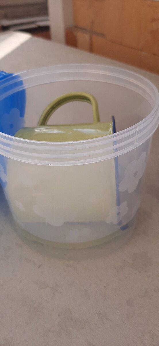

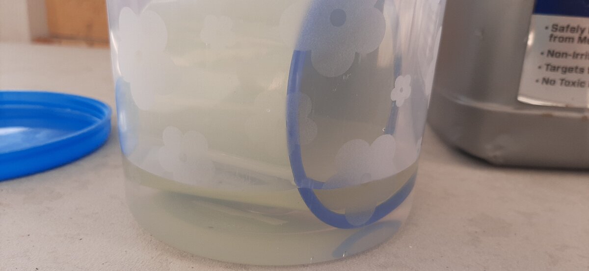

    As for now, I'd just fill the plastic container with some WD-40 Rust Remover Soak and leave the mug inside it, partially submerged in the liquid:
    And then, closed the plastic container with its lid to keep out contaminants:
    I'd leave the mug in its current pòsition for a few days,..starting today.
    I'll report later on the results.
    Thanks for viewing.

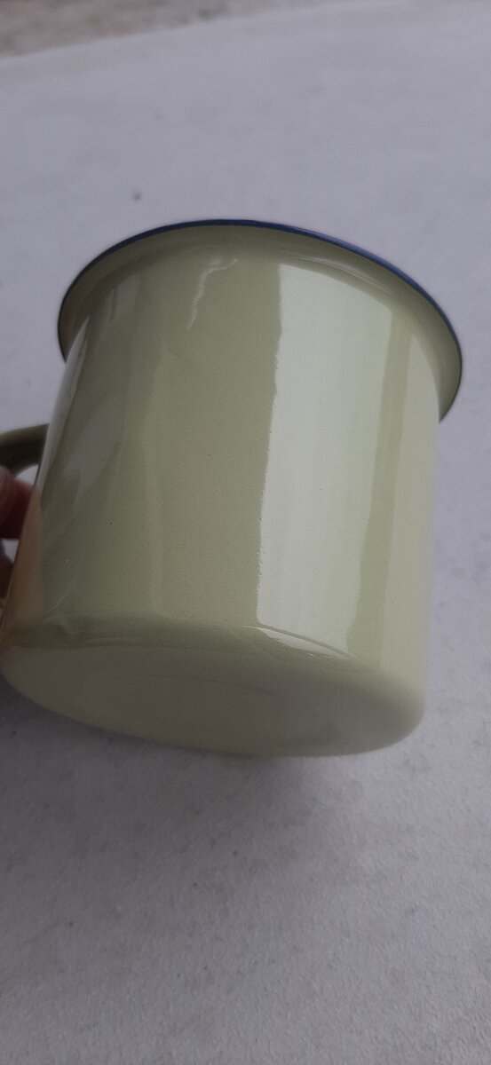

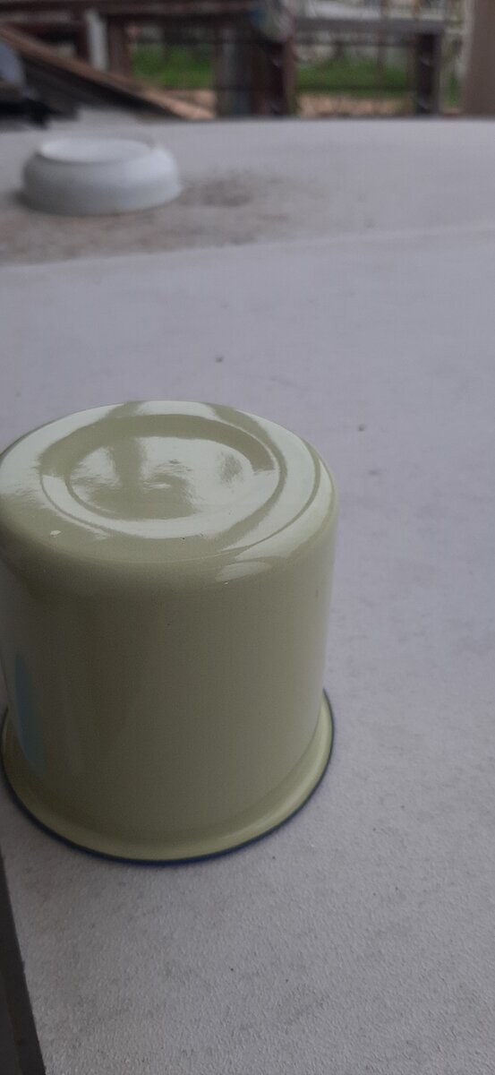

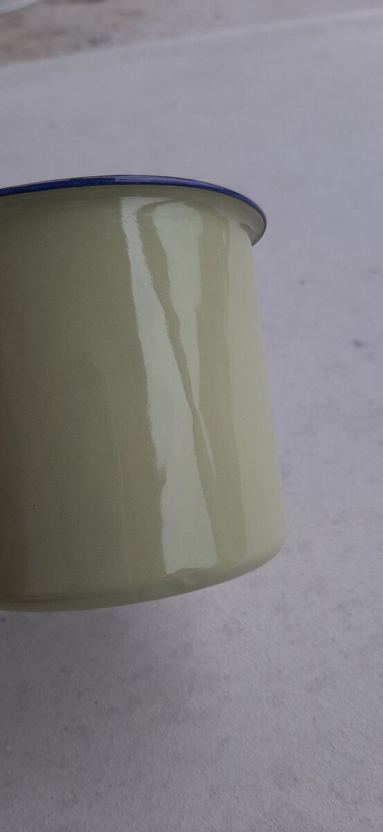

  13. MYN
    So...after slightly over 120 hours (5 full days) of partial immersion, this is it:
    Time to lift it out of the liquid:
    This is what it looks like after water rinsing and drying:-
    Well, its exactly what I've been hoping for, at least till this point.
    Upon inspection, there's basically no visible signs that the WD-40 Rust Remover Soak would attack the porcelain-enamel coating on the steel mug. I guess 5 days should be long enough for anyone to judge on the results. This is tested without addition heating, though. Its done in a tropical environment(here) where ambient temperatures are quite uniform in the range of 27 to 32 deg C throughout the year.
    Therefore, I'll conclude that under the limits imposed on this simple test, the stuff is pretty much safe on most vitreous enamels.

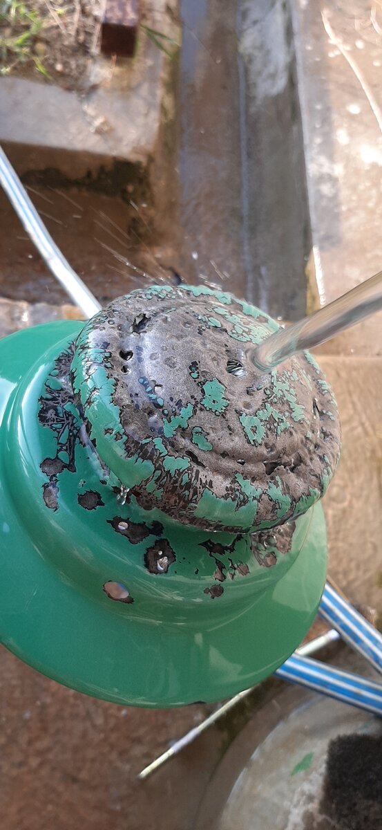

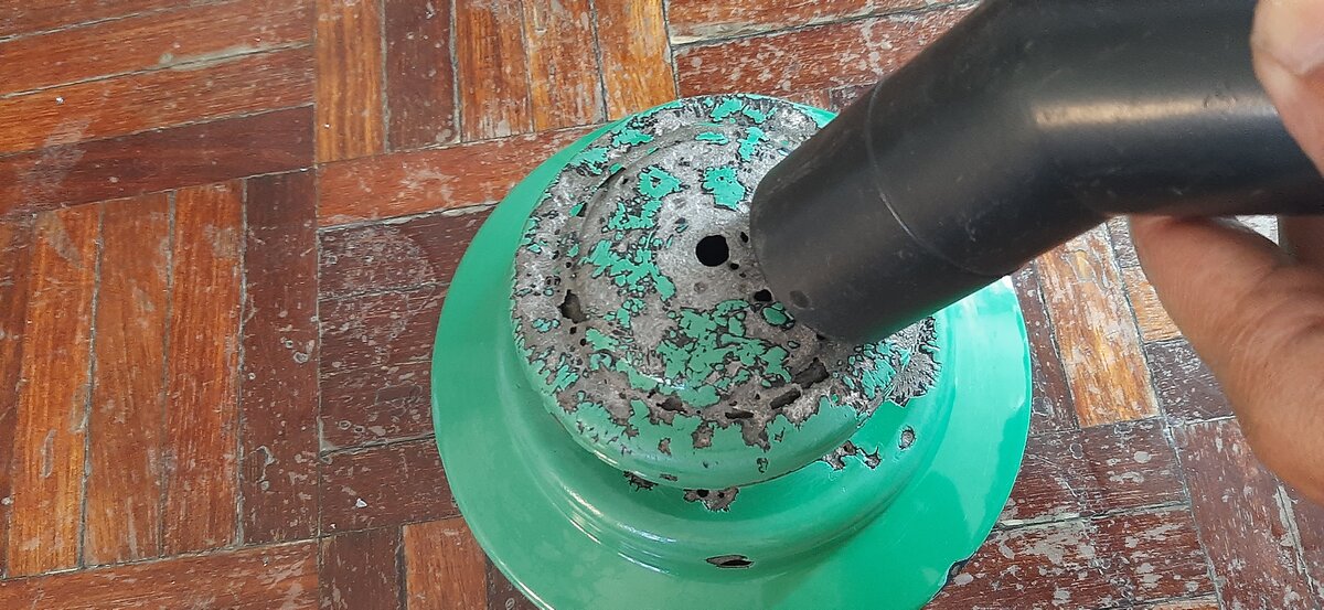

    Next, its likely that I'd test it on a real target:-
    That's a badly rusted-through vent/hood of a Coleman 237. That's when we'd see how good it really is on rust removal without affecting the remaining enamel.

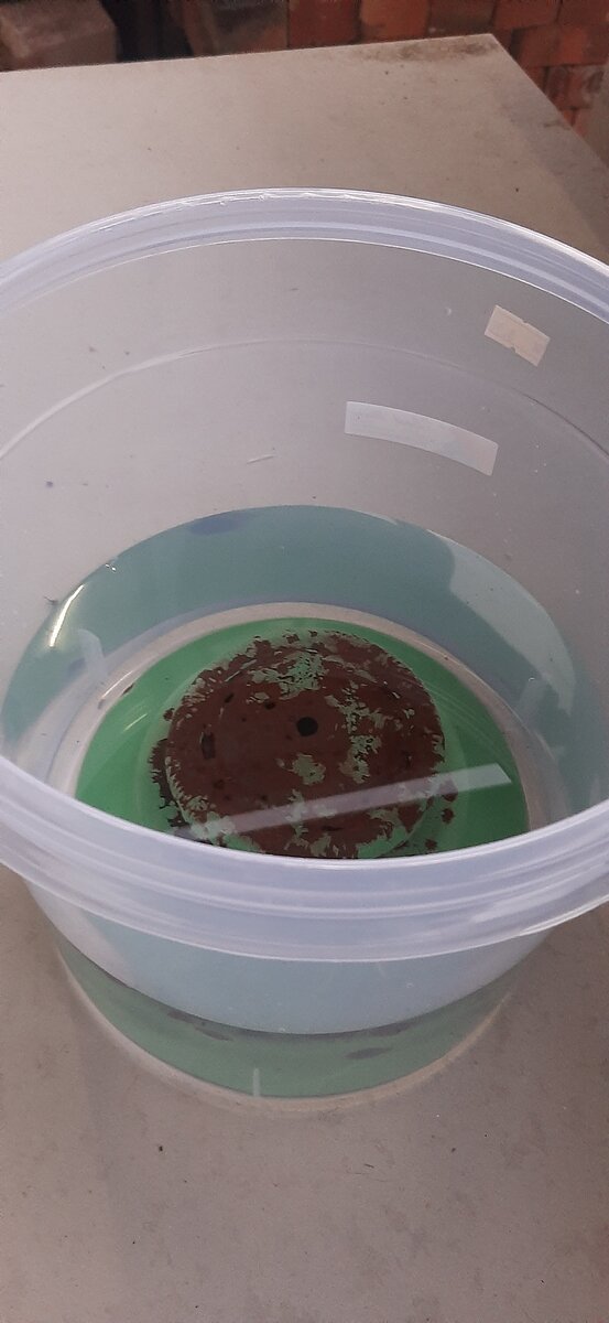

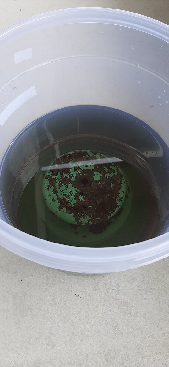

    Ok, since I reckon that there isn't much to lose, the vent is certainly going into the solution:-
    Note that the fresh solution is clear. It doesn't smell much as well. Decided to leave it aside till sometime the next day.

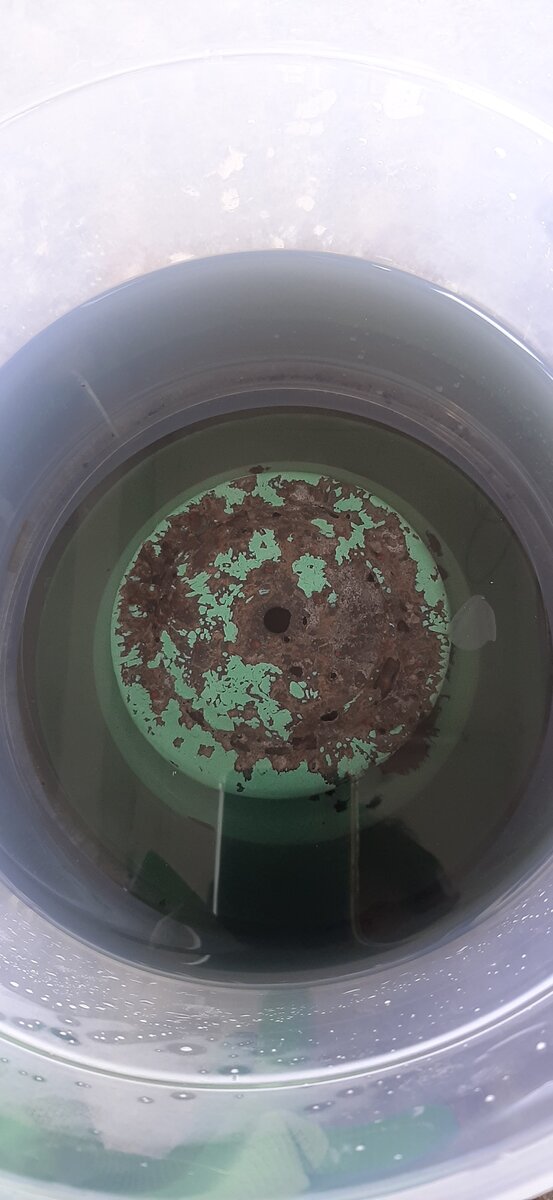

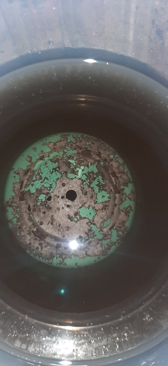

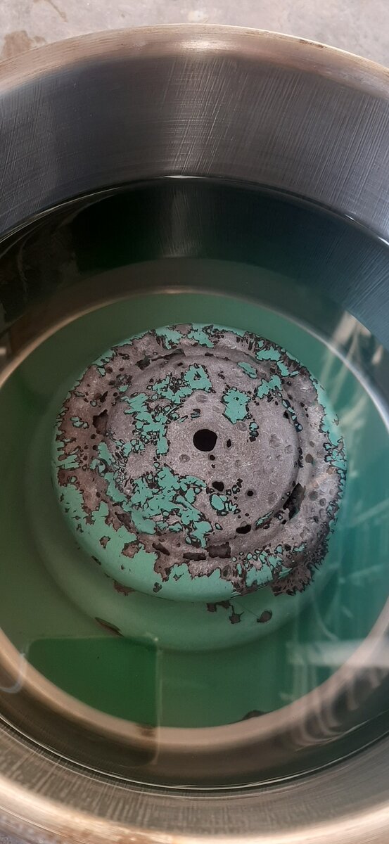

    So after about 22 hours, it looked like this:

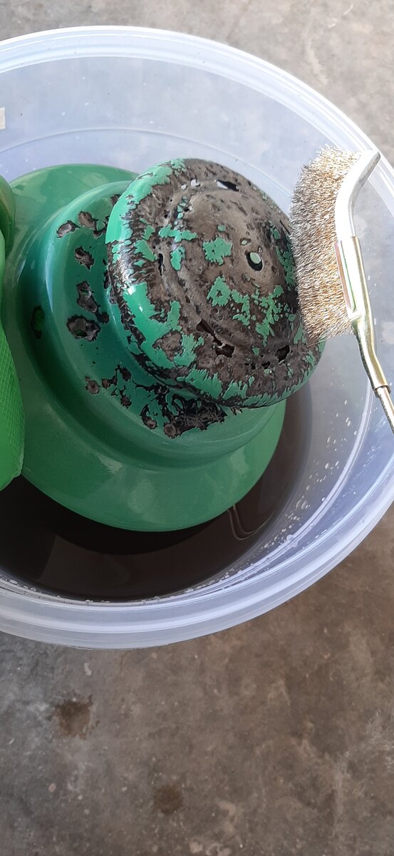

    The liquid has turned darker and murkier. There liquid seemed to emit a sulphurous-like smell at this time. The rusty areas appear to be less reddish and somewhat a darker brown/grey. I've decided to give it a little helping hand with a brass brush. Just a gentle brushing at most:
    It looked promising enough. Most of the rust and dark greyish reaction product seemed to be very easily removeable with the brush, leaving behind some relatively clean, nearly-bare steel.
    There's still some rust remaining in the deepest pockets, pits and crevices. The remaining porcelain enamel seemed to be unaffected,..at least visually so.
    So, I'd just put the vent back into the solution to continue the soak. I'll return to check on it again the next day.

  23. MYN

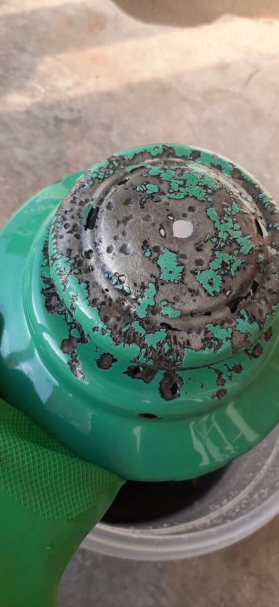

    So, I was busy with work yesterday and the vent was left in the soak till the third day. All the rust is pretty much, gone and bare steel could clearly be seen at this stage:

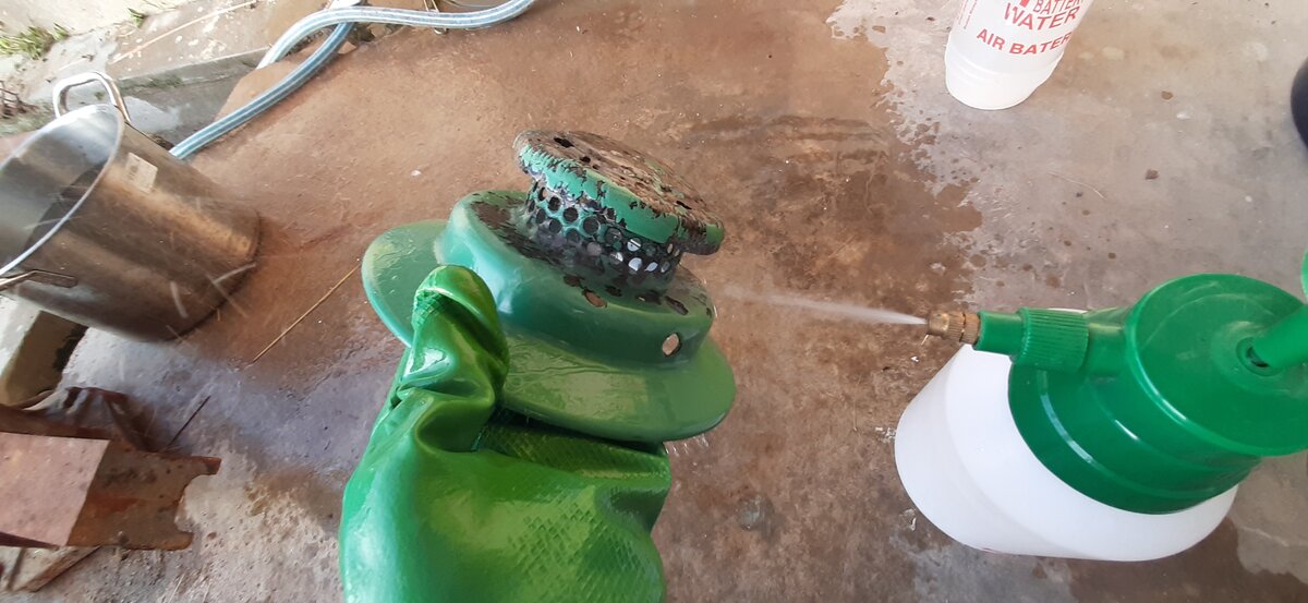

    After lifting out for a final brushing, its then thoroughly rinsed with running tap water:
    Followed by a brief immersion in concentrated sodium carbonate solution to remove or perhaps neutralize whatever traces of newly formed, weakly acidic compounds if any.
    Followed by another rinse with deionized water to remove the carbonate:
    Next, to remove all water/moisture as quickly as I can with a methanol/spirit rinse:
    After the methanol rinse, a quick brush and flush with acetone to remove any traces of alcohol and moisture:
    Followed by a thorough rinse with a light naphtha-based product called WD-40 Speciallist Parts and Brake Cleaner. That's to remove all the acetone, (which is still a water-soluble solvent) and to prevent moisture condensation upon cooling due to its rapid evaporation. The naphtha-based brake cleaner is a little less volatile and doesn't cool the steel surface upon evaporation as much as acetone.
    To hasten the process, I used a vacuum cleaner to dry off the last of it:
    Now, to at least temporarily prevent the rust from coming back. I'll just use Fogging Oil for this. All in all, the enamel is completely unharmed and the rust fully removed down to the tiniest pits.
    I then coated the entire vent with Fogging Oil and allowed the excess to drip off:
    I'll leave it aside till I could figure out some ways to permanently protect the steel from rust when hood's put into operation.
    The permanent protection would need to be at least as heat-resistant as the original vitreous enamel coating.

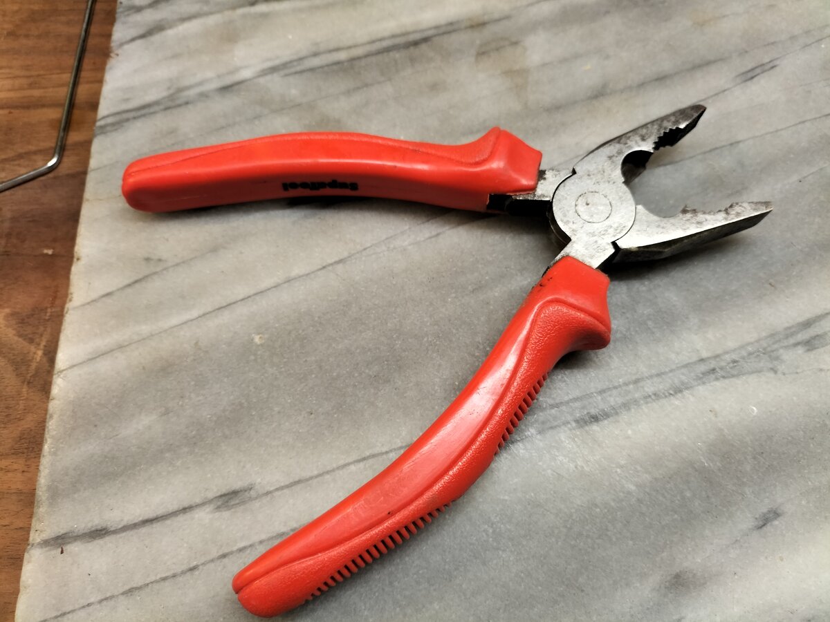

    My vinegar and citric acid bath looks just the same. The liquid doesn't clear but there is a layer of precipitation at the bottom. I guess I could syphon off the liquid but the 'sludge' doesn't seem to do any harm.
    By the way, these pliers were found in an abandoned caravan on the Scottish coast. They'd been exposed to sea water and rain for years when I discovered them. Although I don't have a before photo, believe me, they were very heavily rusted and wouldn't open. I soaked them overnight in my vinegar/citric acid solution and scrubbed them with a wire brush the next day.
    I've used vinegar on its own and it works just fine, but adding citric acid powder gives it a kick and makes it more aggressive!
