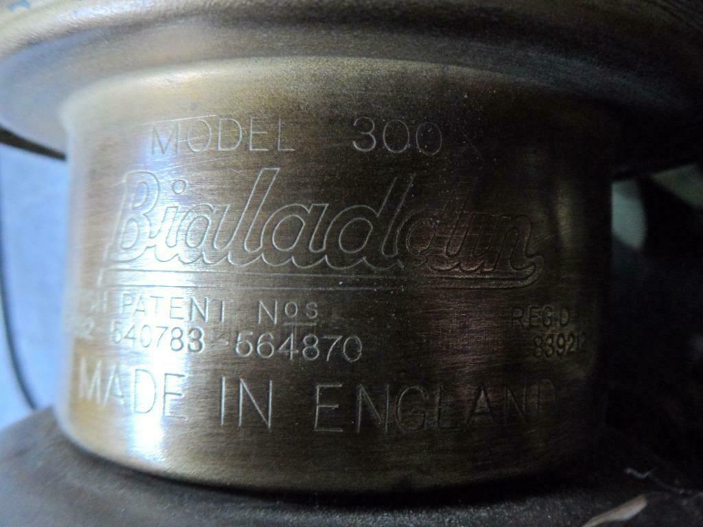

    To continue here on the same subject, I like to submit a picture as part of a current advertisement on a dutch buy & sell platform: two Bialaddin 300 X (in the title of the advertisement) lamps for sale. This is the only picture that shows a model number.
    If your knowledge of W&B is sketchy, you see a model number 300 stamped, that unfortunately seems to be confirmed when you look it up in CPL's Referrence gallery.
    I hope this can be corrected in time.

  5. Henry Plews
    3,050
    Well I see 300 X. The X is not very clear but it's definitely there.
    Henry.
    16,647
    I also see an X.
  7. AussiePete
    Yes, I too see the "X" on the above picture.
