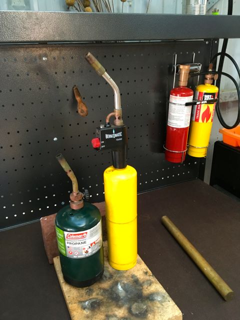

  23. Tony Press
    11,102
    I use the propane torch (left) for soldering; the MAPP torch (right) for brazing; and the oxy-acetylene set-up on the far right for fine brazing.
    I buy the cylinders whenever they are on special, so I always have one in reserve.
    The good news is I can now recycle or swap the cylinders...
