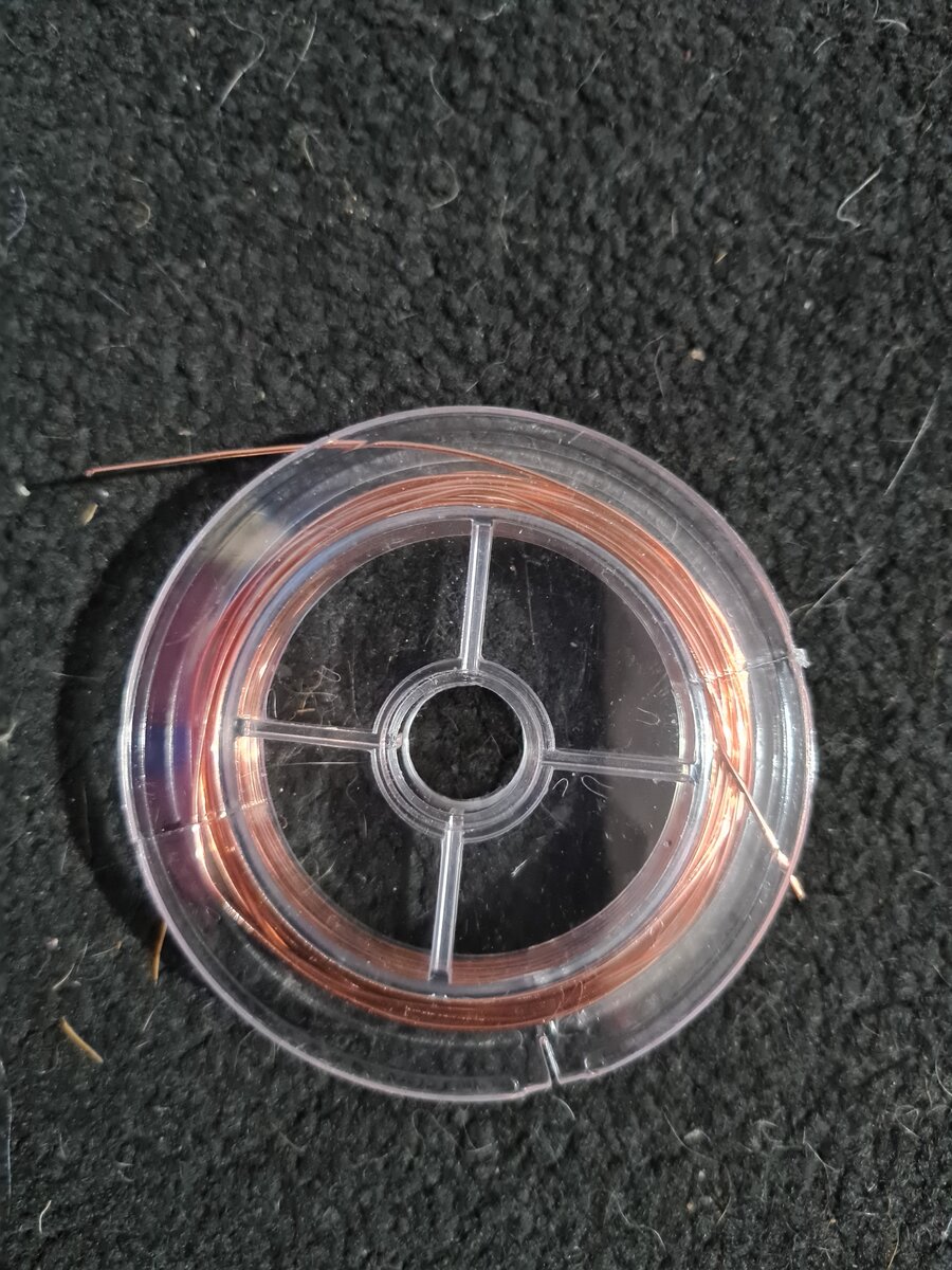

  13. Buggerlugs
    Me too. Thanks for all the contributions, I ended up using some copper 0.8mm wire.
    Lucky for me my wife well you might say is happy to help out with the threading of the mantles.:^o
    You might even go so far as to say this instead.:rage:
    Here is a photo of what I use.
    Thanks.
