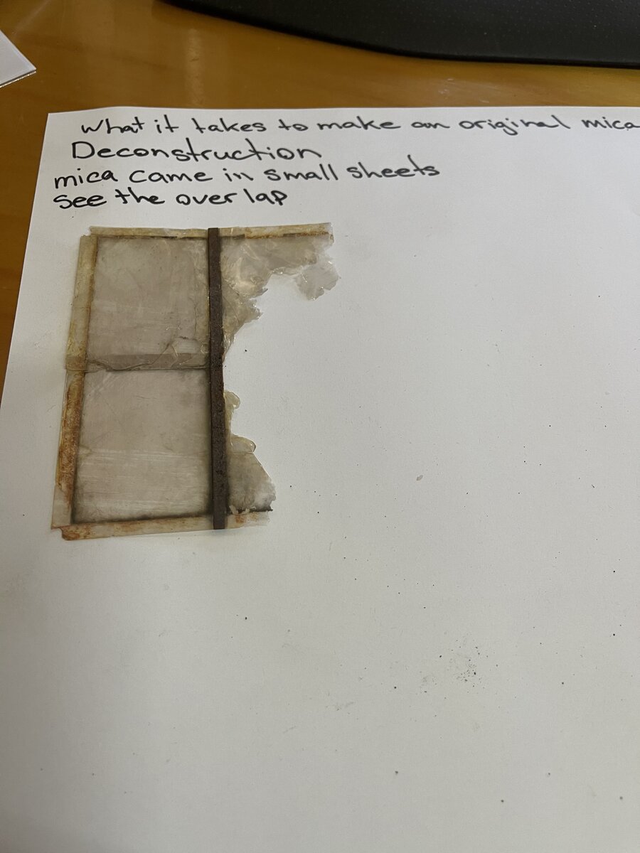

    Hi fellas, following on from my old Coleman thread from open forum, I’ve basically mapped out what it took to make a mica globe, I must say it’s more than meets the eye, the craftsmanship, the tooling,
    I hope my pictures give it some credit to the making.
    I’ve had this globe for a fair while, thought I would share it with others who may want to venture into making your own.
    Mica must have come in small sheets, they all seem to overlap, 1DC429E5-507A-4991-A29F-B8391E9E10E9.jpeg

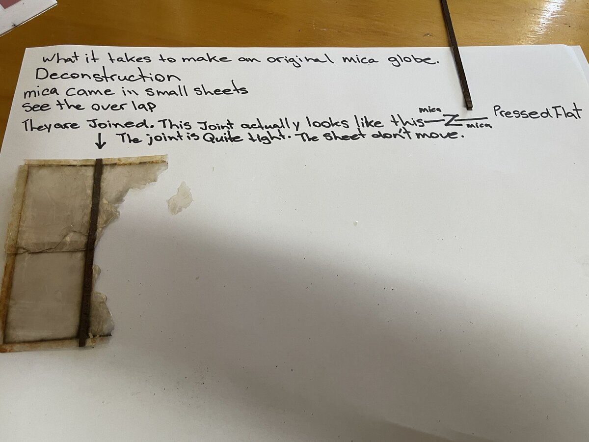

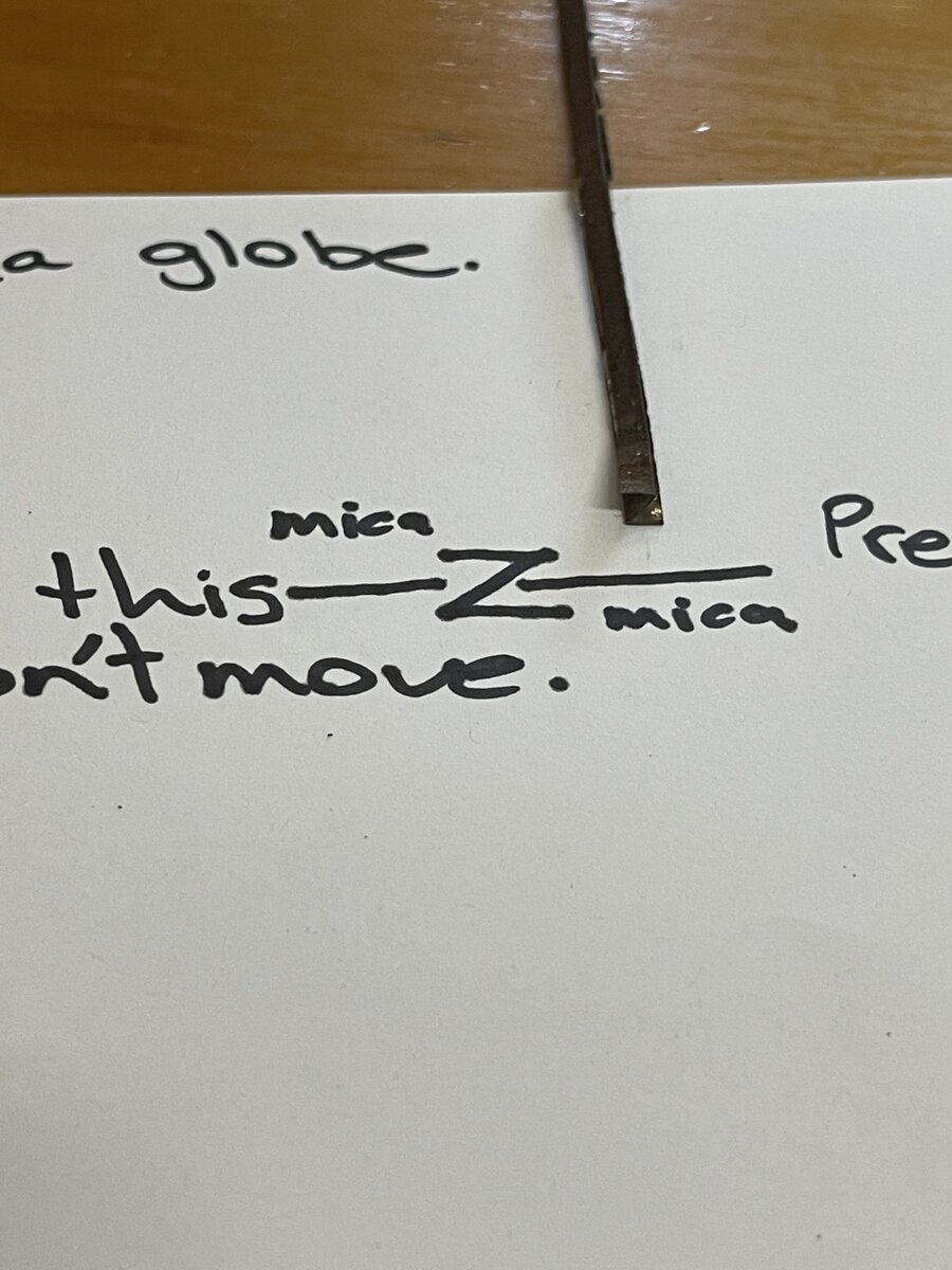

    The joint between sheets looks like a Z the mica goes in the top and bottom and is pressed very tight

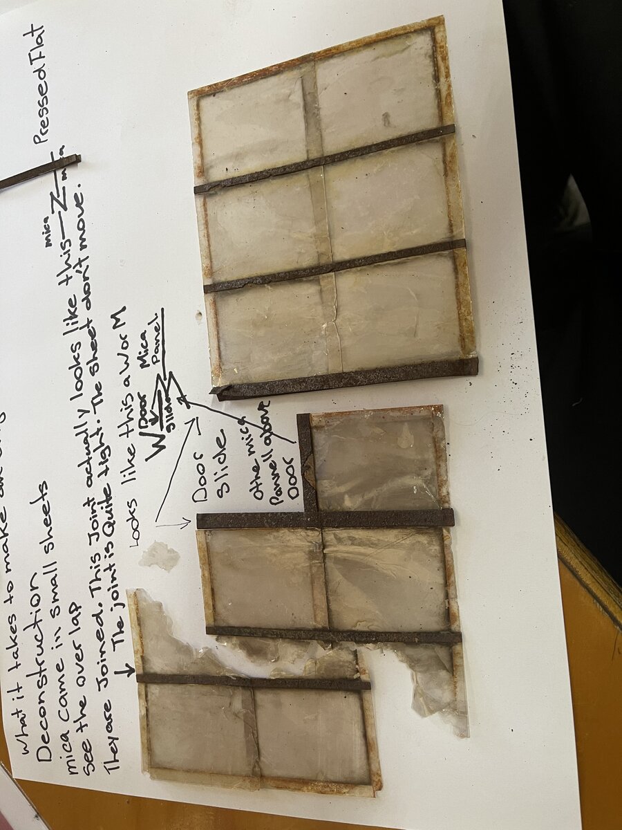

    It’s a repetitive process until the slide door,
    the door slide looks more like a W or M the small v part holds the mica panel, 1/2 the W holds the mica panel above the door, the other 1/2 of the W is bent out enough to allow the door to slide up and down.

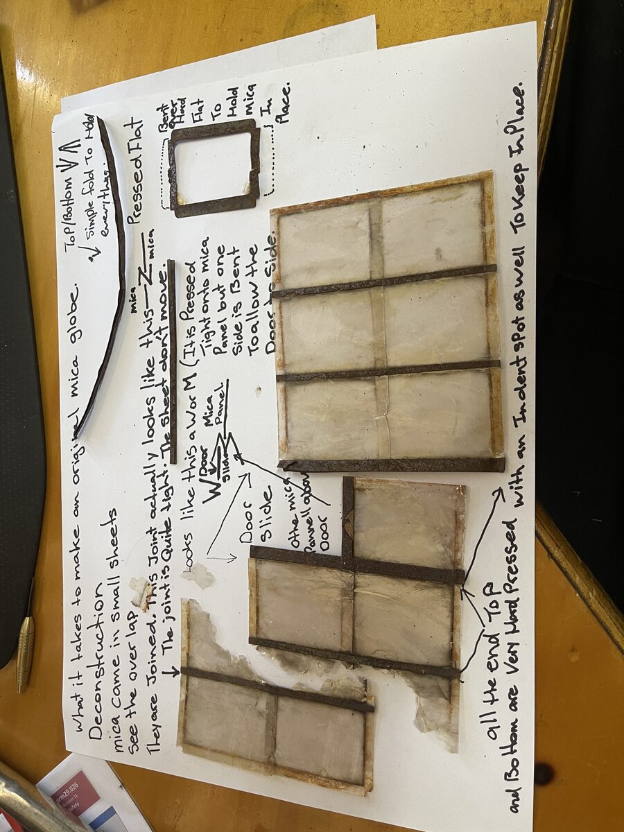

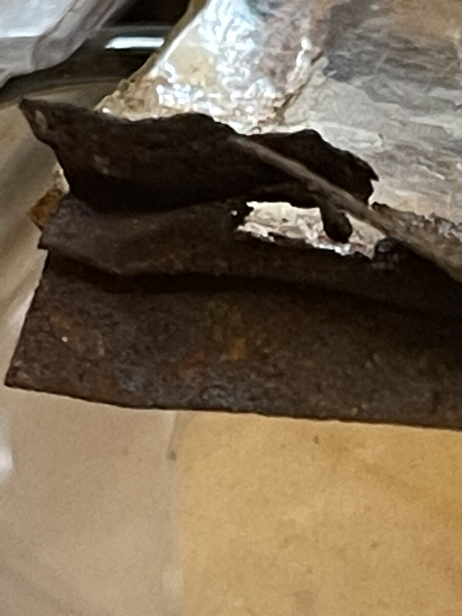

    The door was mica, it to had been folded top and bottom hard tight, the top and bottom rings are simple folded over but all the bits covered by the top and bottom rims have like a pop indent and are flattened hard
    it’s a work of art, my next part to this post is I’ll be making a globe to suit a Coleman 327 I have restored,
