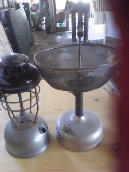

  1. phaedrus42
    phaedrus42 Subscriber
    2,056

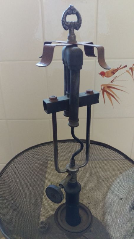

    It is the one on the right ;) I'll be picking them up this afternoon, but I have so far not matched up the model with anything I've seen.
  2. Jean J
    3,000
    Don't know but that shape suggests something to do with a Coleman arc lamp maybe?
  3. phaedrus42
    2,056
    There were some lamps that had fine wire mesh insect guards like this one.
    The distinguishing characteristics of the lamp are:
    -Metal rod connecting valve and burner
    -Short air tube
    -Hexagonal fuel cap with external pump NRV
    -Badge attached to side of fount

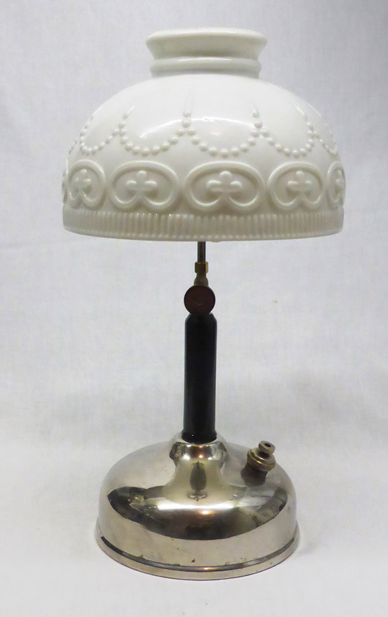

  4. Mackburner
    This is a Coleman CQ table lamp with the bug screen. Nice item because the bug screens are a rare thing and this one looks complete and in reasonable condition. ::Neil::
  5. phaedrus42
    2,056
    Thanks, but are you quite sure, Neil? There are no markings to be seen on or under the fount. The generator is interesting as the jet is not removable and it has a hexagonal fitting with very fine screw thread on the bottom. The lamp only cost me a tenner, but I had to drive 55 miles to fetch it :lol:

  6. Carlsson
    3,966
    And CQ's have a separate collar covering the lower part of the stem where it attach to the tank.
    This one seems to have the conical shaped part made directly in the tank itself, and the stem mounted without any sort of covering.
    More like one of the Nulite 110M versions.
    By that not saying that this is a Nulite. Just that the tank is similar, but I guess there are others who use similar design.

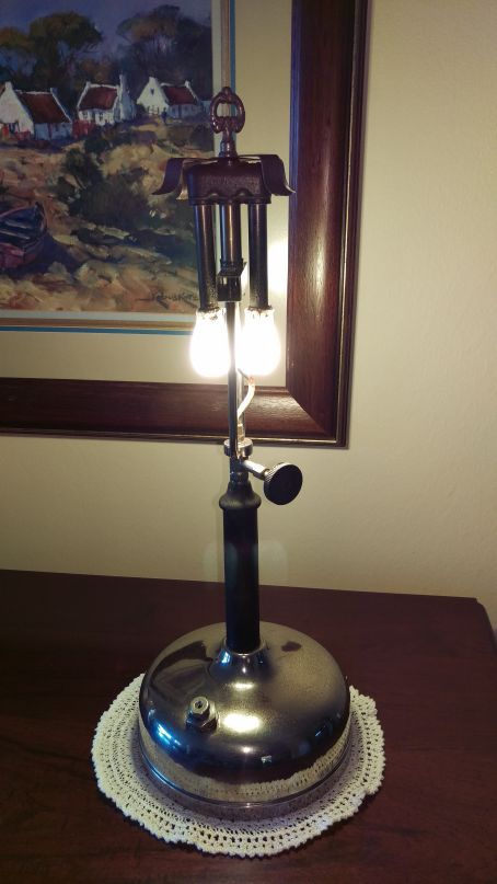

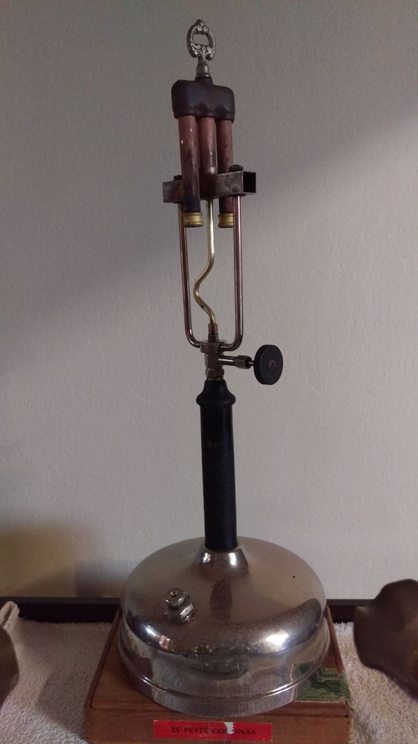

    Thanks for the responses, everyone! All I still need to get this one operational is the bushing that screws into the air tube where the generator goes in. It looks like these parts were made with more than one internal diameter, to suit different generator diameters.
  17. phaedrus42
    2,056
    I made an adapter from some odd bits of brass I had lying around and was able to fire up the lamp today. She's a very quiet runner and provides good light with moderate fount pressure. She has no trouble filling out a pair of Peerless 2C-HG mantles.
    1474200068-gloria-2.jpg 1474200079-gloria-1.jpg 1474200093-gloria-adapter.jpg

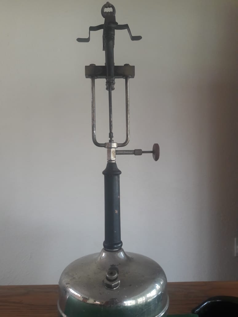

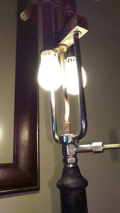

    That is very interesting, Neil! Are you referring to the one acquired by @JohanOptimus ?

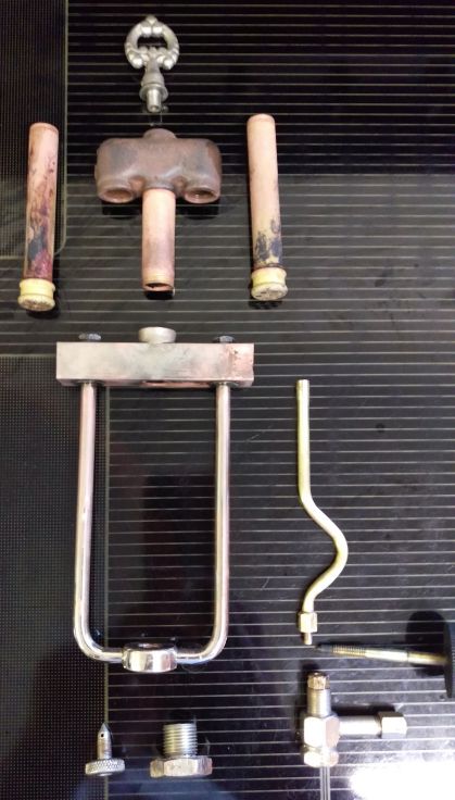

    From the photos he sent me it appears to be mostly identical to mine apart from the valve, generator and insect guard.
  23. Mackburner
    Yes this is the same lamp with a different generator but it was advertised as available with either a torch lit or match lighting generator. ::Neil::

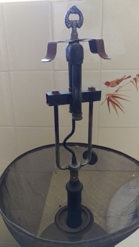

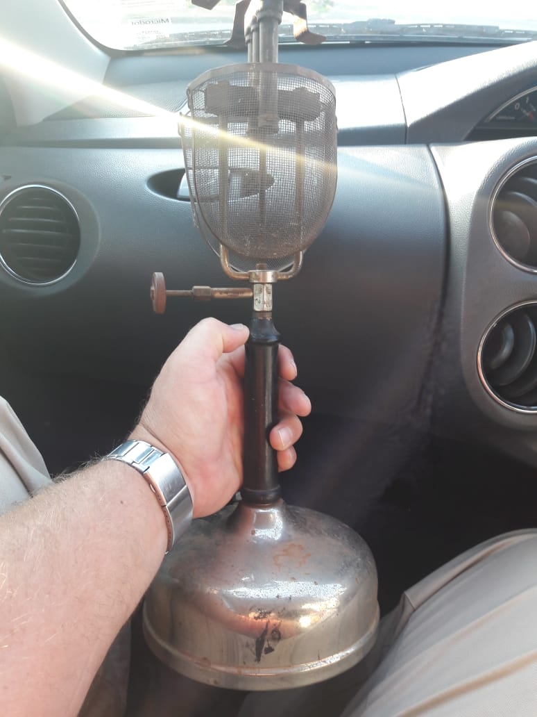

  25. JohanOptimus South Africa
    Feb 6, 2018
    125
    South Africa

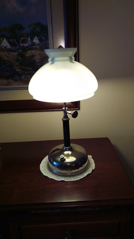

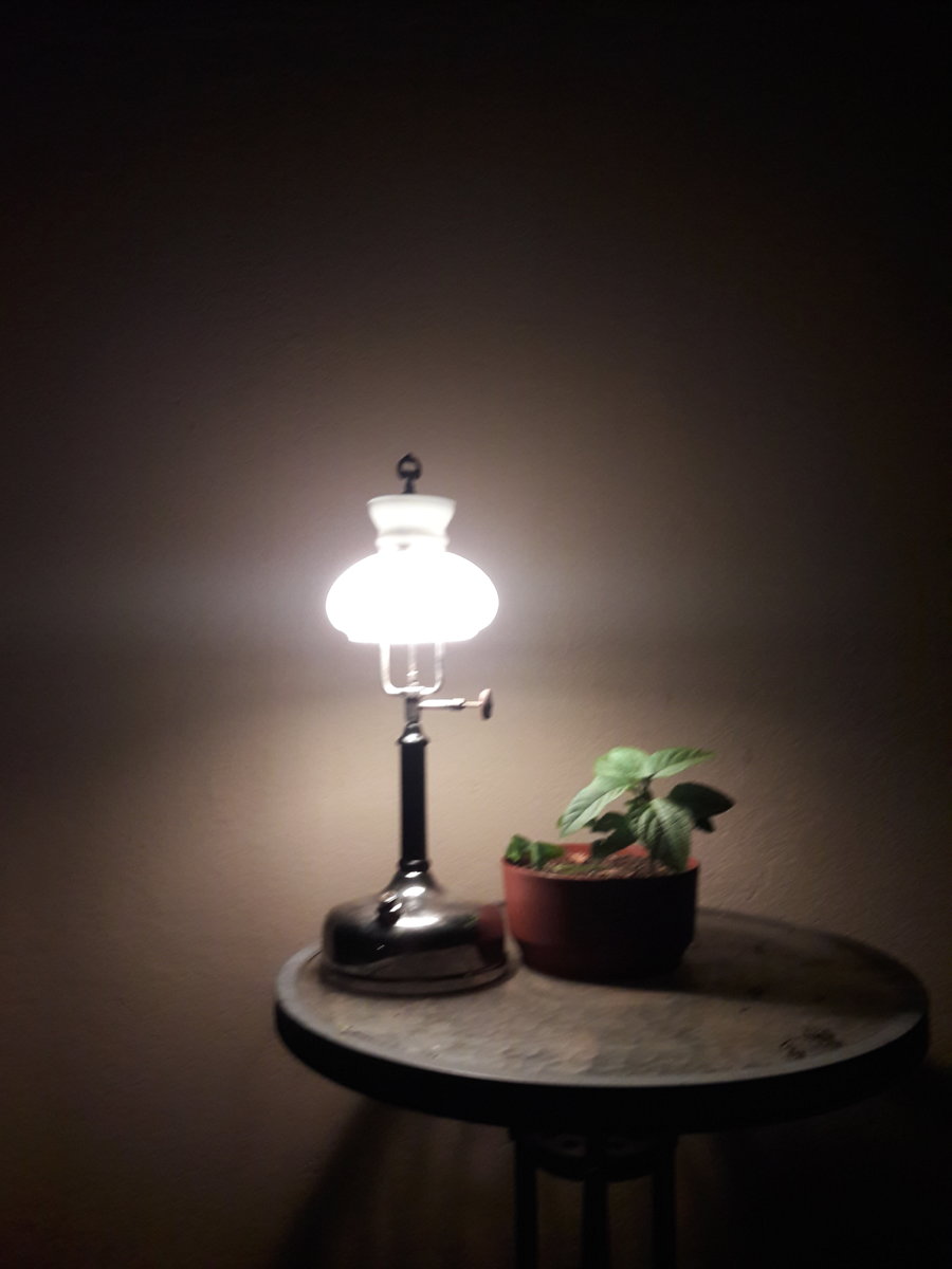

    Thanks for your input Phil and Neill.
    My lamp is very similar to the one in this thread. The generator is very thin, straight, had no pricker and requires preheating. Unfortunately I found it without a shade. I have fettled it and it has been running for about an hour. She is not very bright, but very beautiful. Note that the shade ia not correct.
  26. phaedrus42
    2,056
    Hi Johan, the lamp should be quite bright if the generator passes enough fuel and has the correct size jet. A jet from a 500cp kerosene Coleman lantern like the 237 has the same aperture as that of a 300cp petrol lamp.
    You can test fuel flow through the jet by unscrewing the burner assembly from the valve and checking that you get a straight uninterrupted stream of fuel shooting out when you open the valve (outdoors). If you do not get this, the generator needs cleaning and/or re-packing.
