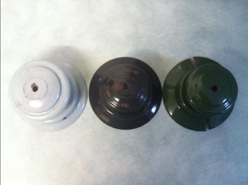

  1. KeroNut
    Jul 13, 2013
    41

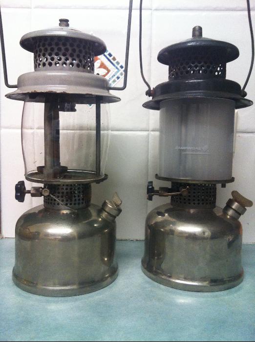

    Hi Guys, This is my first post and I apologise for abusing this forum in the past by reading posts for a couple of years but never ever joining until now because I am really stumped. Can anyone please tell me what the black ventilator (or really dark brown, unsure- colour blind) is from. I found it on one of my Handi Lanterns, but Handi Lanterns ventilators have a hole for a locating stud near where the bail enters (as seen in the grey Handi example in pic). It is similar in dimensions to my Coleman 249 ventilator, but missing slits for bail and obviously not Coleman Green. What else could it be? I added two images so you can see dimensions.
    The locating stud had been cut off so the ventilator fit perfectly.
  2. KeroNut
    Jul 13, 2013
    41
    One other thing is that I believe that the earliest Handi Lanterns did not have a locating stud on the support. However all 9 of my Handis do and it doesn't make sense to me that an earlier variation ventilator would be found on a later variation lantern as the ventilators chip/rust/deteriorate quicker than other parts of the lantern. So, slightly different dimensions and no locating hole are the main reasons I'm looking elsewhere, rather than the obvious answer being that it is genuine Handi.

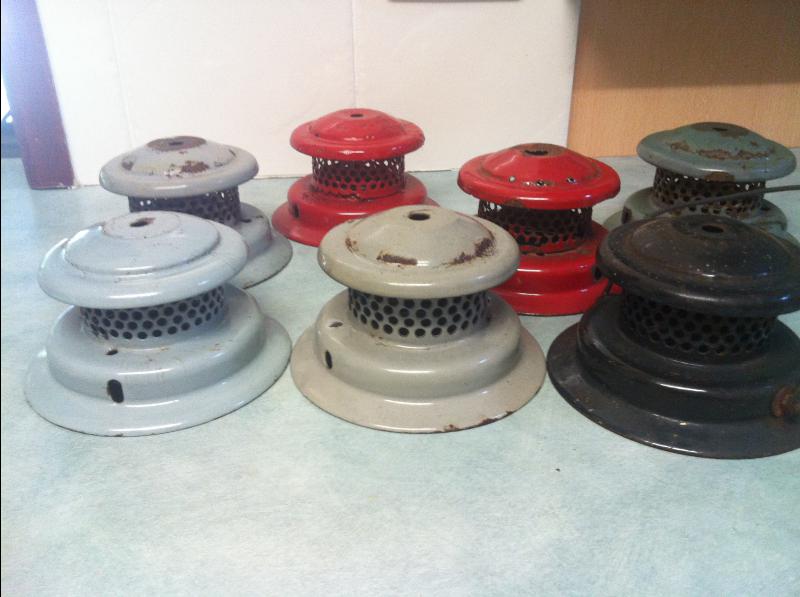

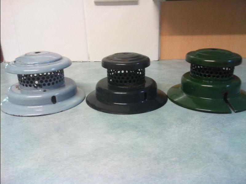

  3. KeroNut
    Jul 13, 2013
    41
    And here a pic of 6 of my Handi ventilators. All the same dimensions. Just different colored enamel (although the back red one was painted with VHT red as it has badly deteriorating)

    Sorry about my description of colors. My wife and son both told me that it was definately black and the Handi ventilator on left of pic was a silver/blue (not grey like some of the other Handi). But I guess anyone reading knew what I meant. Thanks that color blindness gene was not passed on. :) . very frustrating at times ](*,)

    Welcome to a fellow Aussie I have 4 - 5 Handi`s all seem to have curved edge on vent top cap your squared off one ?? looks Coleman-ish is it the same dia for globe as your others?. Only other options are to search in Lamp Reference Gallery and be patient someone may be able to I D it for you.

    G'day Graham, yep, the top section is squared off and the diameter of the top part a good 20mm'ish less as well. A few mm shorter height as well, and much smaller diameter of the center holed section, compared to both coleman and Handi. I checked the gallery from end to end, surely I missed something.

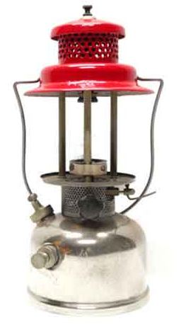

    Nov 15, 2011
    268
    Gowrie juncton Queensland

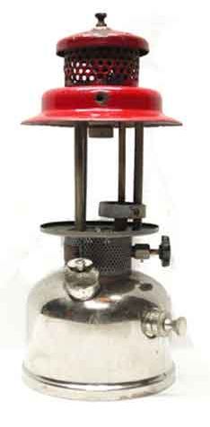

    Hi Tony, i have a few Handi, and among them i have the very first Swiftlight, your mystery ventilator looks like it, they aremodeled on the AGM 100 regards Frank
  9. KeroNut
    Jul 13, 2013
    41
    Thanks Frank. I agree that the closest match I can find in the gallery is the one Handi swiftlite. And despite it being on a Keropet in fairly good nic, it probably is a swiftlite hood.
    Not a lot of pictures of swiftlites around and I'd love to see a pic of yours if your able to. Thanks for responding. I will consider it solved. :clap:

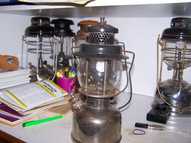

  11. outback boy Australia
    Nov 15, 2011
    268

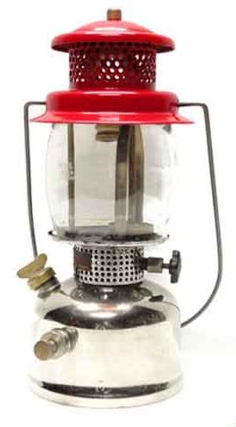

    Hi Tony, here is a pic of my lucky find Handi Swift Lite, sorry no spare to give you :lol: cheers Frank
  12. KeroNut
    Jul 13, 2013
    41
    THATS IT! Very nice Frank :thumbup: . I seriously think that belongs in the CPL gallery! In good nic to. And the glass is the original as well? something doesn't seem right about the fit of it, looking at the gap between glass and edge of support at bottom. It seems to bulge a bit more than the keropet glasses I have, which I understand cracks from bail hitting it if you put it in a swift lite. (And a nice original version of the 246 pork pie hiding in the back. I have the second variation of the pork pie, very good lamps)
    Maybe someone on the forum here needs a swiftlite hood. I would rather it helped to complete a swiftlite than end up on a franken lantern if I keep it.
    Thanks Jeff, I had visited the Handi museum site before, but just guessed that it wasn't maintained by owner often as front page says Updates - 2002. I presume it belongs to the Handi Albert who's name i have seen a bit on some forums, usually followed by "where is Handi Albert?"Has anybody heard from Handi Albert?". seems to have disappeared.

    Thanks for the reply Tony, the glass on the lamp is not a Handi Tony, it is a bulge glass that happens to roughly fit a Swift lite, same as 550 Coleman globe, but will not fit standard Handie's, i have a stack of army surplus Schott Suprax West German glasses i picked up from a disposal store, i just put one on that lamp to rob the original Handi globe, Yep, i love my pork pie Tilley, Frank

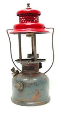

  17. outback boy Australia
    Nov 15, 2011
    268
    Hi Colin, thanks for the great input,you got me thinking after i read your post, the lantern and dark blue badge are original, i put a magnifying glass on the the badge to get a accurate reading, on the left of the small shield in the middle it says swift lite, the other side, Handi works, down at the bottom of the badge is states for Shellite,it has the AGM type burner,the great grandson of the original Handi Works Company in the late 30ies visited with me some time back and bought his Swift lite up to compare them, he said it was a swift lite, this may add to the confusion, thanks Colin regards Frank
