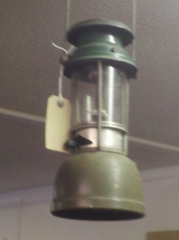

    Just wondering if anyone can ID this wee lamp? I've been offered it and I'm not sure what it is or how much to pay for it. Thanks.

    It's a Vapalux M1. Maybe worth £20 to £30 if it is complete and in good nick and the glass is OK.

    Now this is the sort of thing you ought to be buying, Stephen... :thumbup:

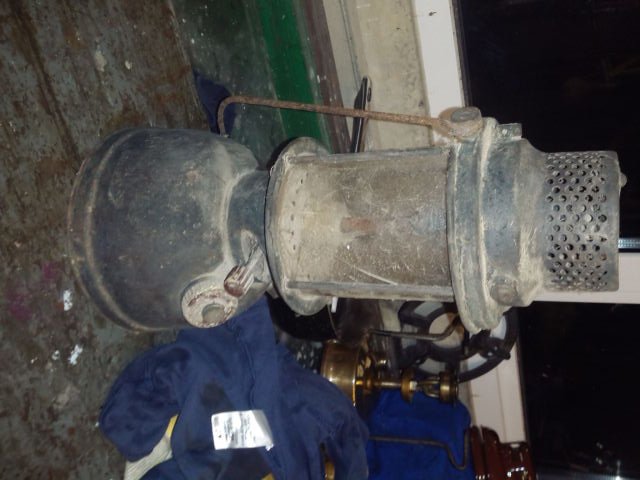

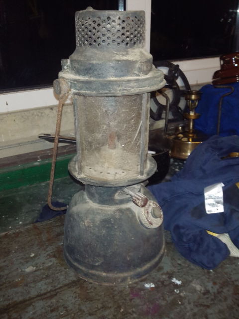

    So here goes, looks like it needs a ball of work but hey it was free! Any specific tips for this lamp?

    A good clean! :lol:
    It's missing it's hood, but you can usually find some good reproduction brass ones...
    Personally in that condition I would probably strip the paint and respray.
    You'll need a decent flat bladed screwdriver to get the non return valve out. Other than that there's not a lot of difference between fixing this and a Tilley X246B.
    A new washer kit and some mantles is probably all you'll need other than the hood.

    Ta, its was maroon once so I think we'll go for a full respray and polish up.
    Absolutely everything on it is seized solid so I'd say I'll be needing a new pump and filler cap as well as a globe. I saw a picture of one in maroon with all the brass bits shone up which looked rather lovely so I'll be aiming for that finish.
    I take it base camp have all the necessary bits and bobs?
    And I take it the inners ie the burner/vapouriser arrangement is similar to tilleys?

    Won't you have to remove the current pump and filler cap in order to fit new ones? In which case you can re-use the existing ones.

    Yeah James I've not had a proper try as its soaking in penetrating oil but I reckon I'm going to have to be rude with it to get it off. If I can get the pump out without damage it should clean up but the filler cap is ally and its badly corroded anyway.
