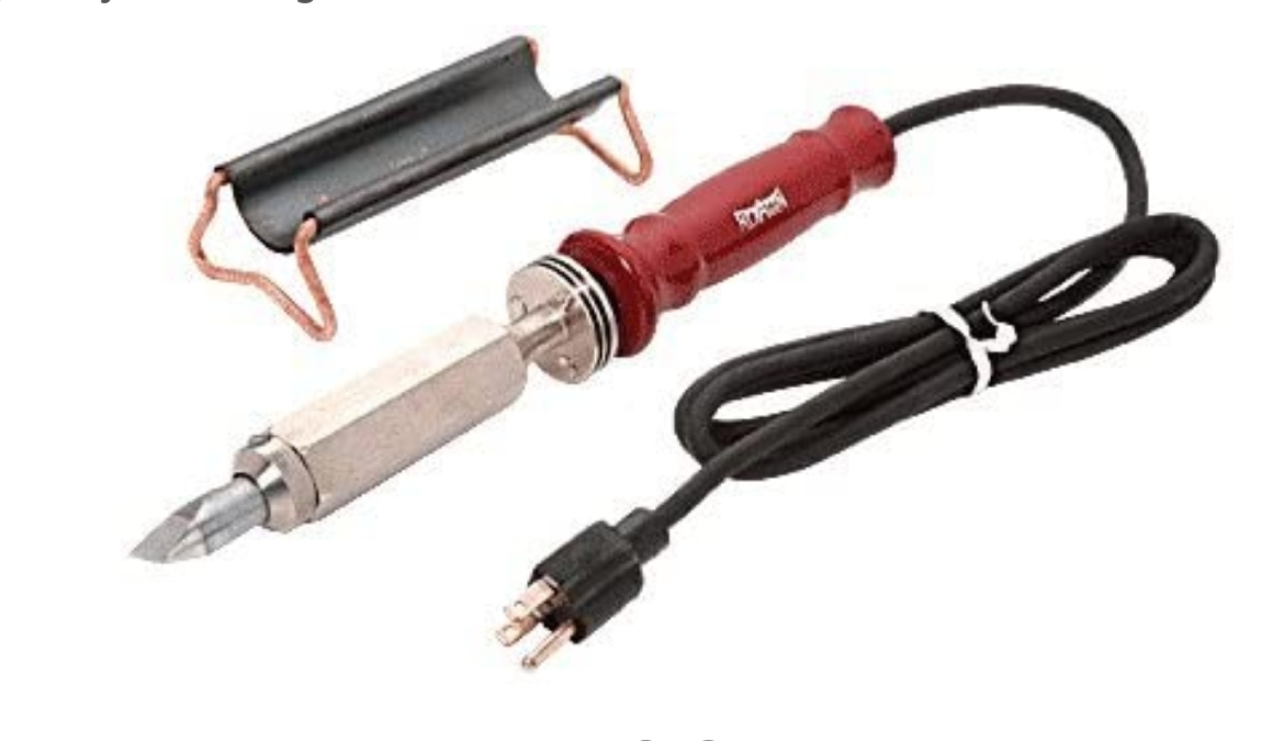

  6. Thomas
    Thomas Subscriber
    Jun 24, 2017
    209
    We use these at work, and they work great. We plug them into a variac to control the temperature.

    @Thomas
    I nearly bought a Weller 120w soldering iron with a similar tip but it had sold by the time i asked the seller about it, good idea using a controller too.

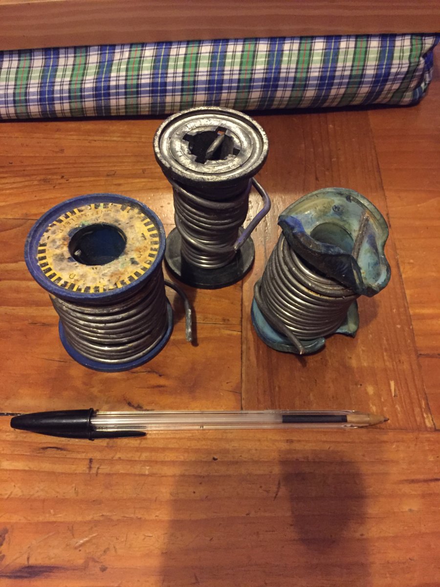

    I think Henley Solon is also another decent brand, i have found a secondhand one that i am tempted to buy but it is rather large, i also came across three part rolls of old solder which is quite thick and may be of use too, all the labels have been removed though,

    Beware solder on a green reel, it is likely acid core solder. Rosin core solder is traditionally on a red or a white reel. If you cut through the solder with a craft knife and it has three or more fine holes it should be rosin core. One hole only is usually acid core.

    Again thanks for imparting your knowledge Phil, i think they are all blue rolls but i will cut them open to check, are they useless if they are acid core?
  16. phaedrus42
    phaedrus42 Subscriber
    2,056
    The scid is corrosive so not the best choice for lamp work.

    Hopefully they are Rosin core as they would last me years.

    A green reel has lately meant lead free solder in electronics work. Some brands are almost neat tin with flux core. Some add copper or silver in small %.
    Melting point is high and not good for lamp work. It is reluctant to flow and the joint always appears grainy.

    I haven't cut them open yet but the melted ones label says Powerflow solder wire 500 gram 11 gauge contains lead 30.. i can't make out the last two numbers
  22. JonD
    JonD Subscriber
    Apr 15, 2014
    1,011
    Hertfordshire, England
    They look a bit old to be for electronics & lead free.
    That said there was also lead free for use by plumbers on drinking water pipework. That is older than the electronics usage I suppose.

    I think they will be worth trying at some point especially as they were free.
  24. MYN
    I'd not be too worried if they're lead-free or not. Afterall, most of the lamps we're dealing with are classics. I'd guess that they were soldered mostly with sheet metal or plumber's grade materials.
    Those in the picture appeared and could likely be un-fluxed. It'll be a good idea to have additional fluxes at hand.
