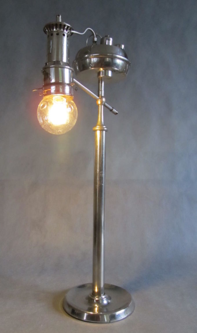

    I got Lucky searching for lamps on the internet and finally found my Wiktorin. Conny made me search for it since I saw his tablelamp on Youtube getting fired up.

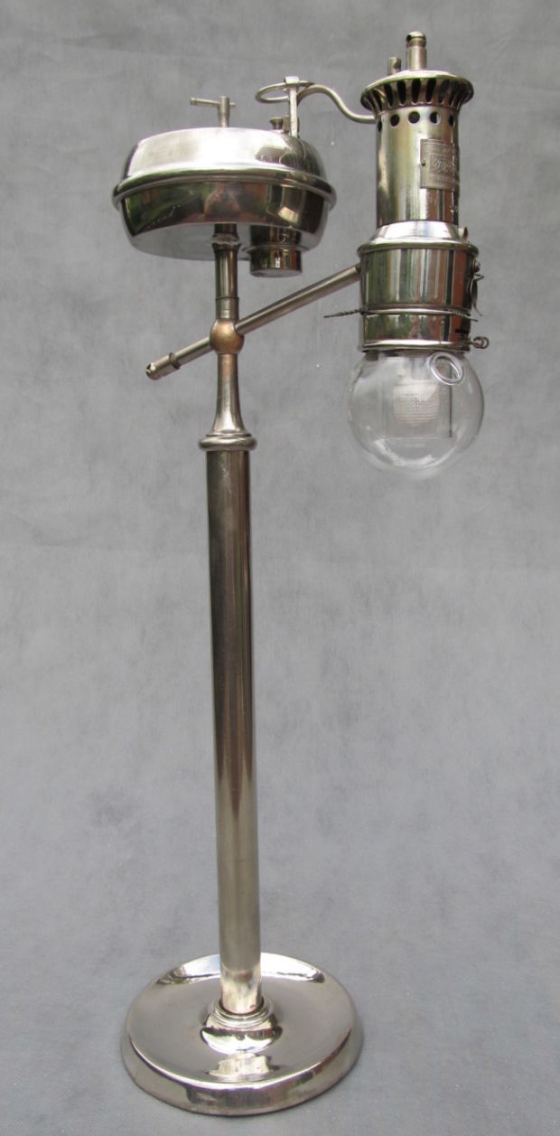

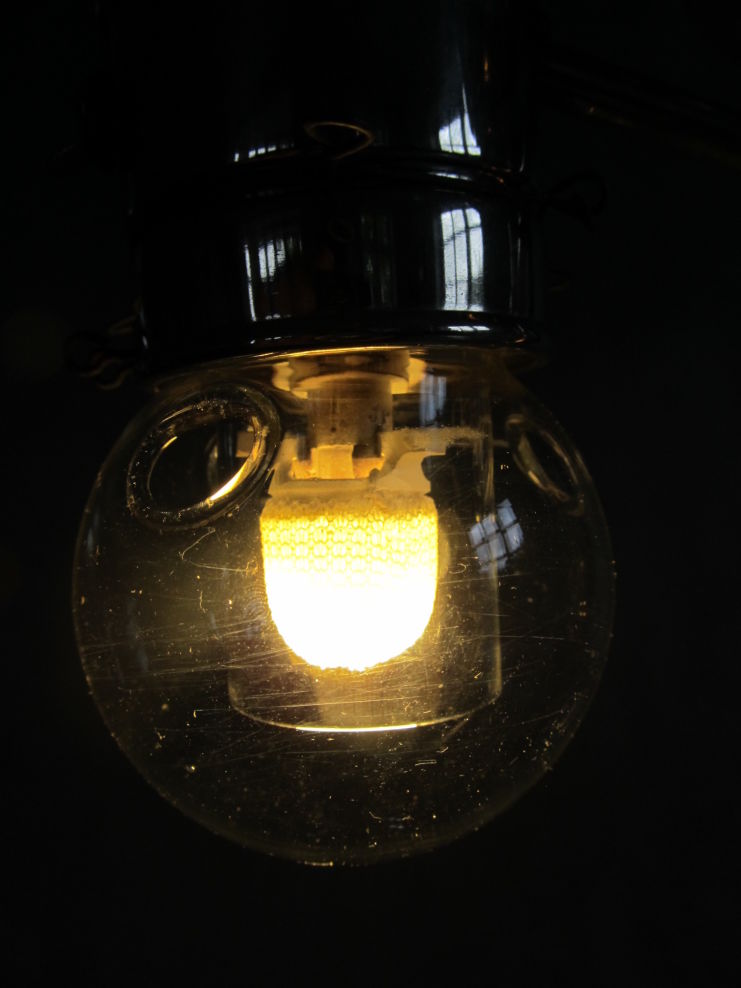

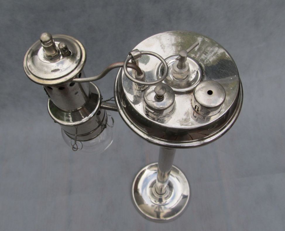

    Here she is:
    The ring on the top of the tank makes it possible to hang the lamp in balance from a hook.

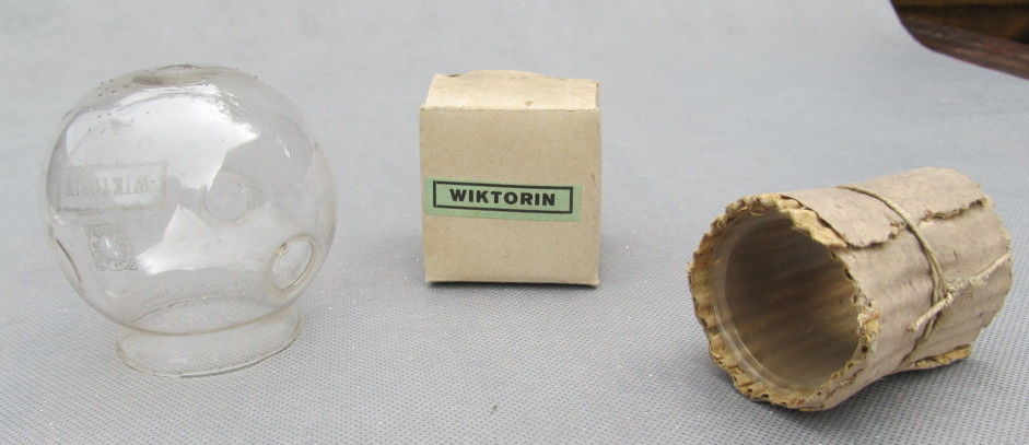

    And the belonging glasses/globes and mantle direct from Wiktorin-plant:

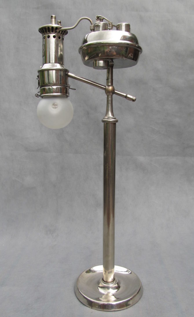

    She also comes in White:
    Enjoy

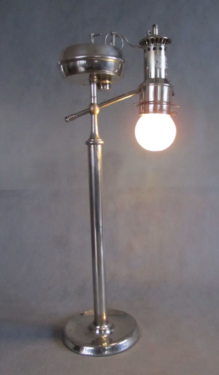

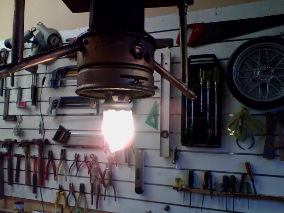

    :shock: uuh oh, almost forgot, It can also burn.:

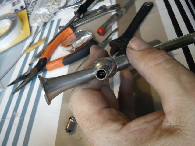

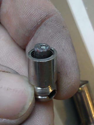

    If it is the sloping fueltube containing a filter you mean, then I didnt take the filter out. I opend the bottom-screw;
    And found close to completely clogged. Then I gave it the wellknow citric-acid-water-trick and that did it. Out came a total green fluid and I think the filter origin is made of copper that over time did react with the brass-fueltube.
    I managed to clean using it like a drinking-straw (I know) just without the drinkingpart, then it came so clean that blowing air through was like blowing air through a syntetic washingsponge as those for cleaning pots and pans you know.
    I was not able to take out the filter and as it Worked fine I left it in.
    Claus C

    Yes that is the one. In mine it is a very fine mesh which steadies the flow of metho into the heating chamber. I find that by altering that packing (different sorts of mesh)the fuel/air mix changes and the brightness varies. By removing the mesh I have a wonderful flame thrower and packing too tight it doesn't work properly.
    The old mesh in the tube needs to be replaced but haven't got around to it yet.

    The purpose of the mesh in the tube I believe is 1. preventing backfire and 2. making a counterpressure to prevent the alcohol in steamform to press the liquefied alcohol backwards.
    I dont believe the mesh is there to prevent impurities.
    Nr. 1 is easy to fullfill and I dont think this will give any problems to you, but nr. 2 I think is a bit more difficult, while stamping the wadding too hard the fuel maybee will have too hard time getting to the vertical tube in the vapourizer and stamping it too light will make a flamethrower as you describe it.
    The density of the mesh is also a factor but I think it can be adjusted by the way you stamp it.
    I would have liked to see how my mesh looked but I couldnt fish it out of this narrow tube and I didnt understand this metal-stick sitting in the middle of the tube so I was afraid of doing something wrong :?

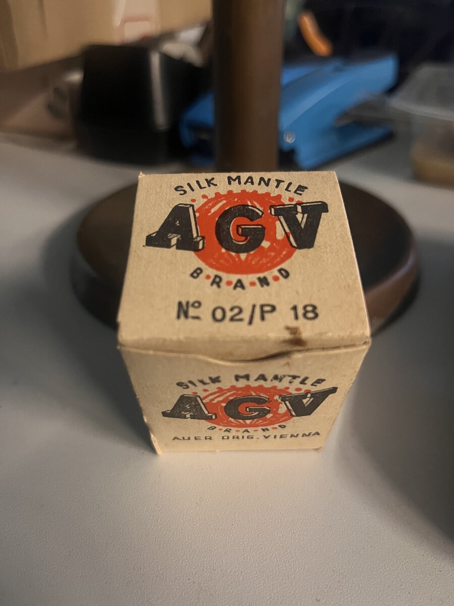

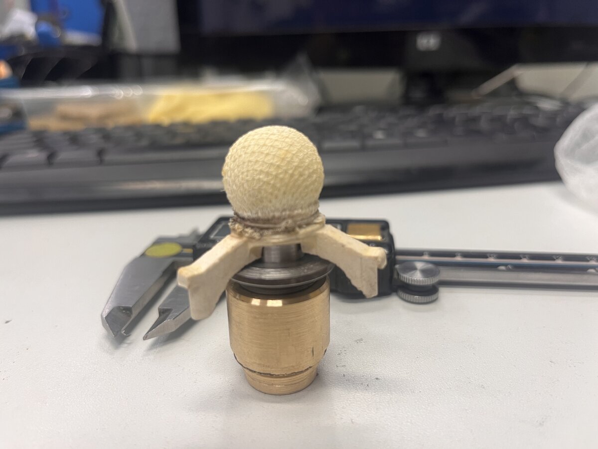

  15. Dan Bittner
    Dan Bittner Czech Republic Subscriber
    Aug 1, 2022
    32
    Czech Republic
    62F2A4F2-2188-4157-B545-11FCDE0C49F5.jpeg 11F8F992-00C9-4D33-A46B-A3DC038F5890.jpeg 0C4D06ED-E0AE-4A6D-A399-D448F46FC280.jpeg 67522645-0267-4978-A51B-FD36DFAACAF4.jpeg

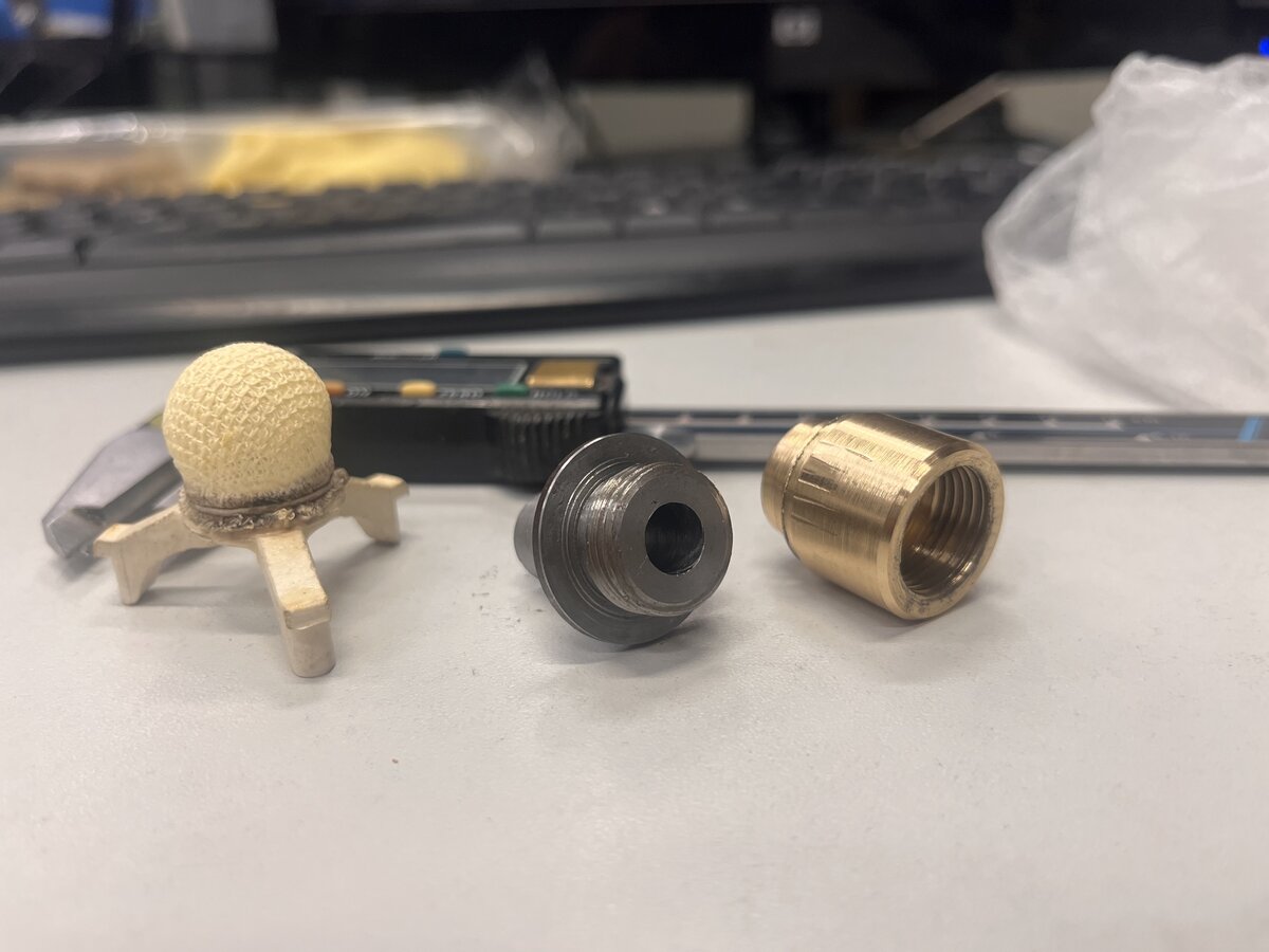

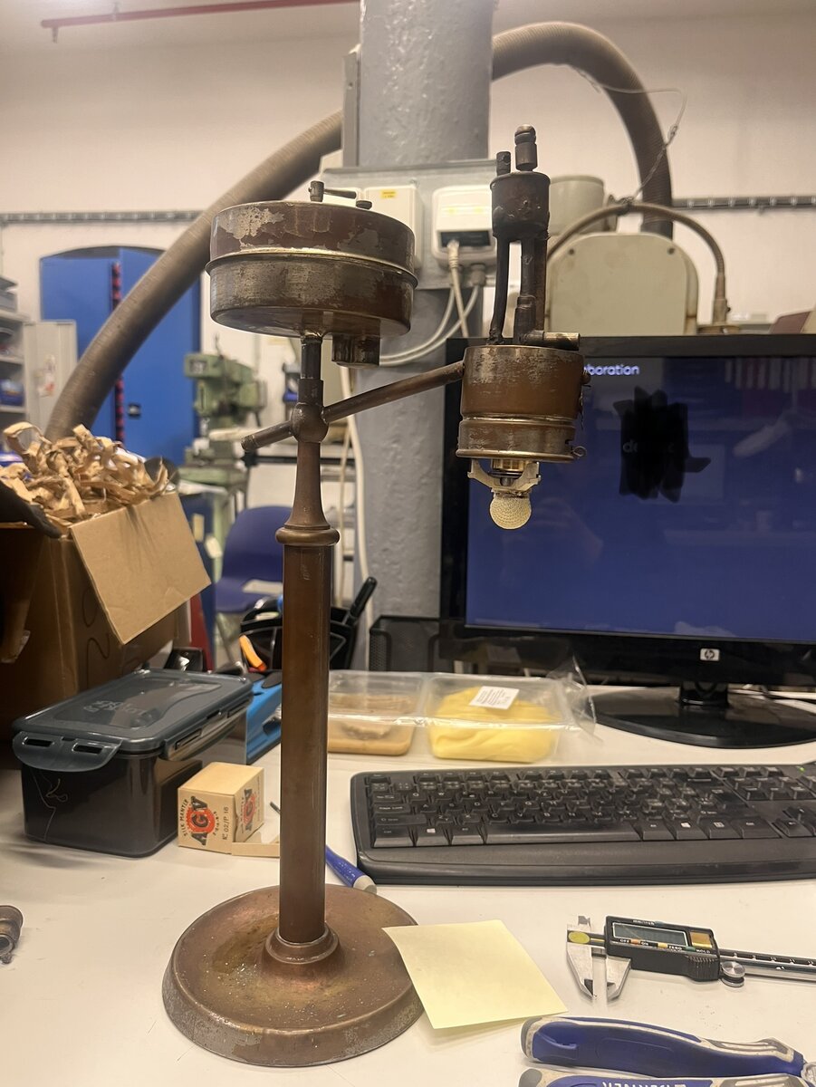

    Hello, I managed to buy a Lamp Wiktorin on ebay. Unfortunately, it is not in complete condition - the burner holder + burner and both glasses were missing. At home, I have many mantles with a type of lamp unknown to me. I made the burner holder out of brass and the burner itself out of steel on a lathe. Any chance it will work?
  16. WimVe
    3,531
    I would say:try it out.
    I think despite the craftsmanship that the steel and brass is to heavy, to thick and heat transfer may or may not work.
    It is an alcohol/spiritus lamp.

    I think it will work.
    Best of luck.
