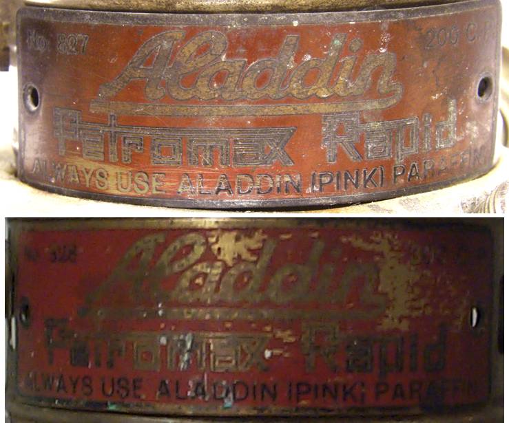

  17. Mackburner
    I am starting to think that pre WW2 Petromax were marketed in the UK by importer/retailers other than Aladdin. I have most of a pre 1940 Petromax Rapid 828 which also just has 828E on the collar label. ::Neil::
  18. Jean J
    2,984
    Haven’t got under all the dirt yet and not sure I even want to!
  19. WimVe
    3,531
    But Aladdin had them just for the war in their catalogue. So I assume those where labeled extra with Aladdin.
    At least I have one marked like that.
  20. Mackburner
    I don't have any adverts or catalogues with Aladdin-Petromax lamps dated during WW2. From the paper I have they were sold here 1937 to 1939. I am reasonably sure they were not importing lamps from Germany after 1939. It is possible they still had stocks from before 1940 of course but the latest Aladdin catalogue I have showing Aladdin-Petromax lamps is dated July 1939 with models 900, 821, 826, 827 and 828.
    As far as I know the Petromax lamps sold by Aladdin were all labelled with both brands so Aladdin-Petromax and the model number is on the collar labels but the tanks have just the German Petromax stamping. These lamps don't have the E suffix in the model numbers. So look like these two 827 and 828.
    So two pre 1940 Petromax lanterns, 827E and this 828E both found in the UK and not labelled as Aladdin suggests that Aladdin were not the only UK retailer of Petromax pre WW2. ::Neil::
