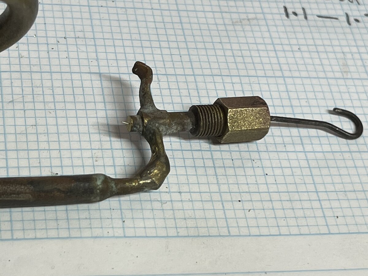

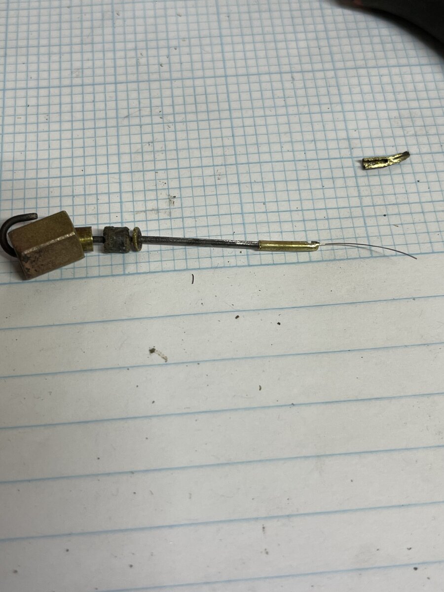

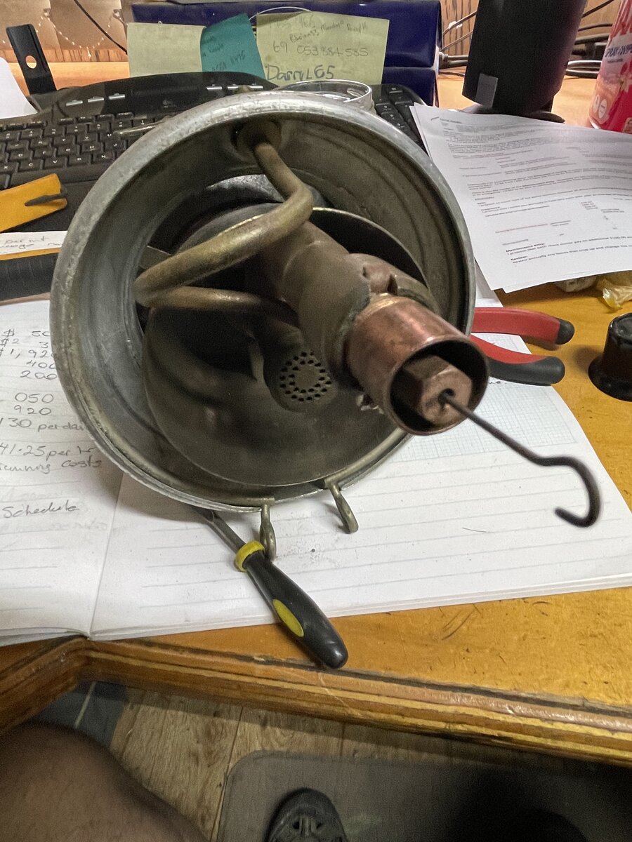

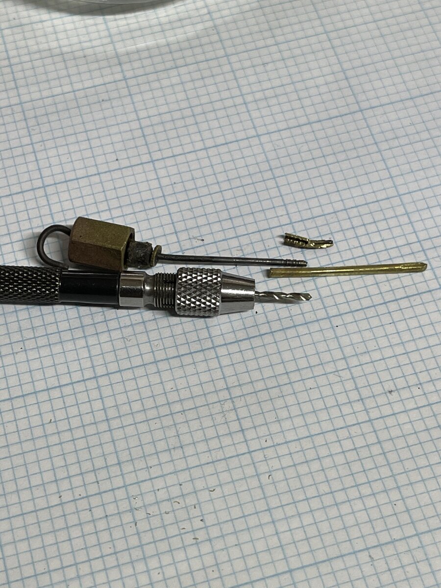

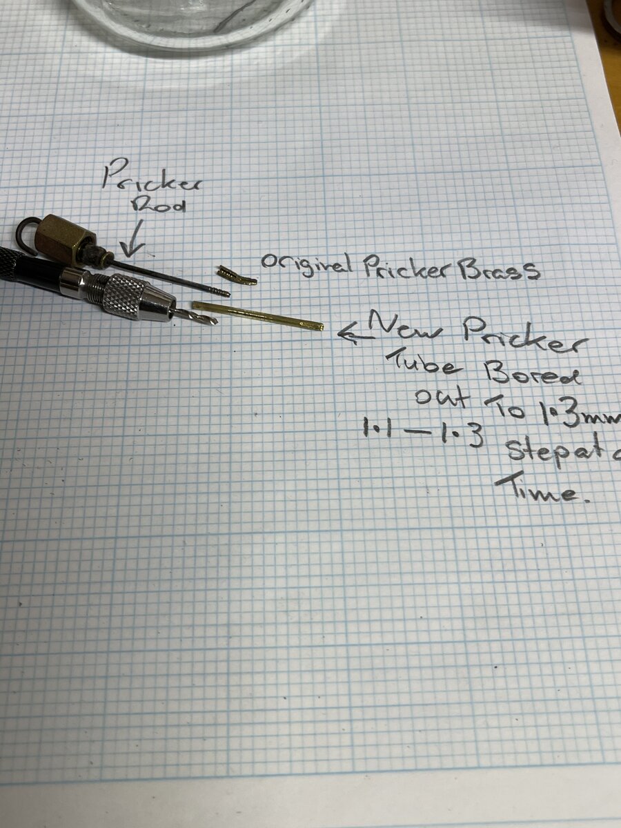

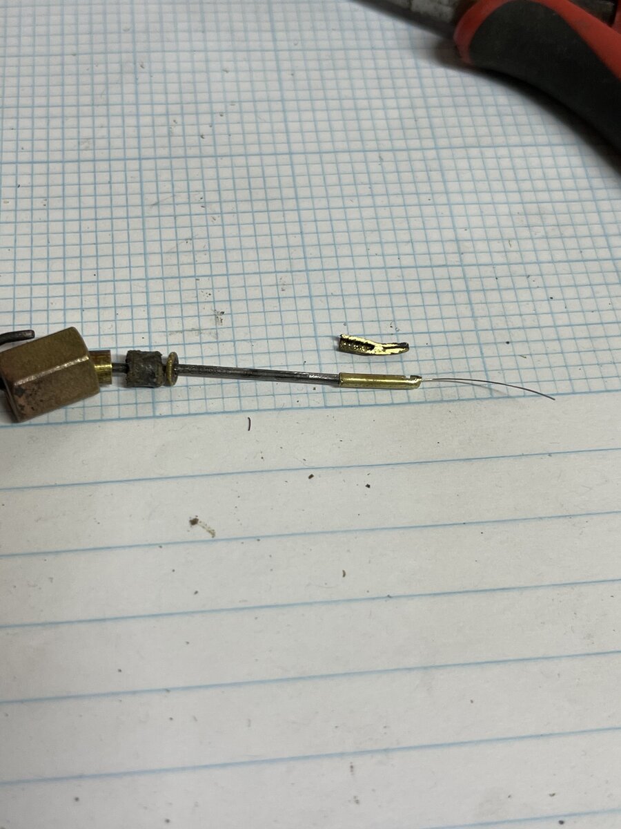

    Hi fellas, something a bit different but similar. I’ve been working on a wizard hollow wire lantern/lamp.
    The generator had corrosion on the bend and it needed a new pricker wire.
    I cleaned up and capped and silver soldered the repair to the generator, I then set about remaking the pricker with what I had. It was a bit fiddling but step at a time I got it together. It’s all a works in progress 1084F08E-B28B-4342-81C7-4810A8201E2D.jpeg 77AF84AC-5F5A-4765-9A33-F8B21F95CD15.jpeg 3736AEFE-B109-4A2F-B6BA-F8ACF10046DB.jpeg 3A96AF49-C79C-4561-811A-9F264D647BAD.jpeg 13DC5772-CFC2-4E35-9506-C1AD50264AEB.jpeg 5FECF3C6-FA41-435C-B337-525211486486.jpeg 65CABE14-7891-4D54-87CE-36396FB8B880.jpeg 5ADD9164-4DD3-47D2-94F1-3193F27EADDC.jpeg A6833F2C-7C94-4A4A-A6A6-71947240234A.jpeg D55F6C53-159E-4A2F-A23F-51FD70F7A73F.jpeg 77B5CCCB-FD8C-49A1-BCF3-E18C30187515.jpeg
