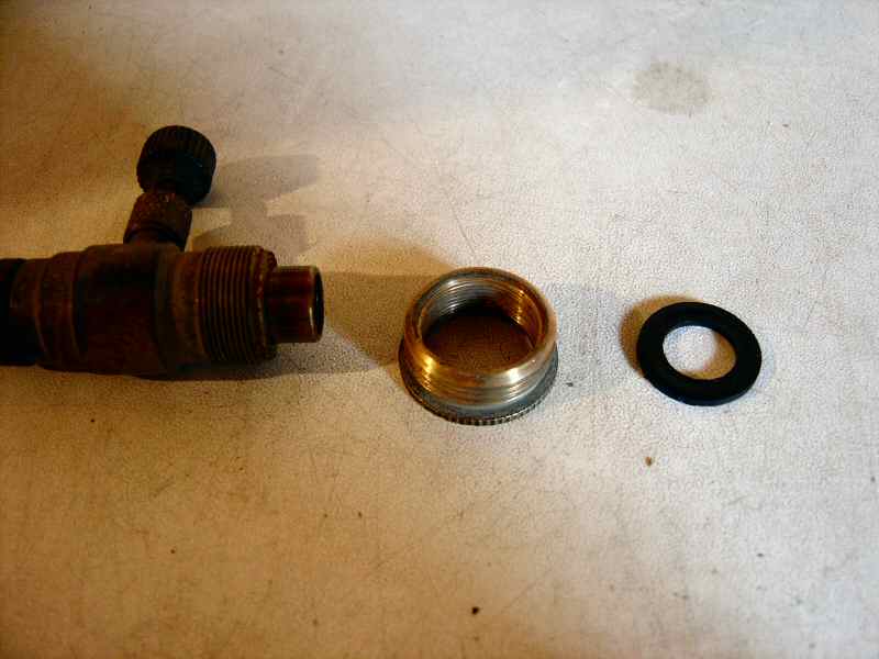

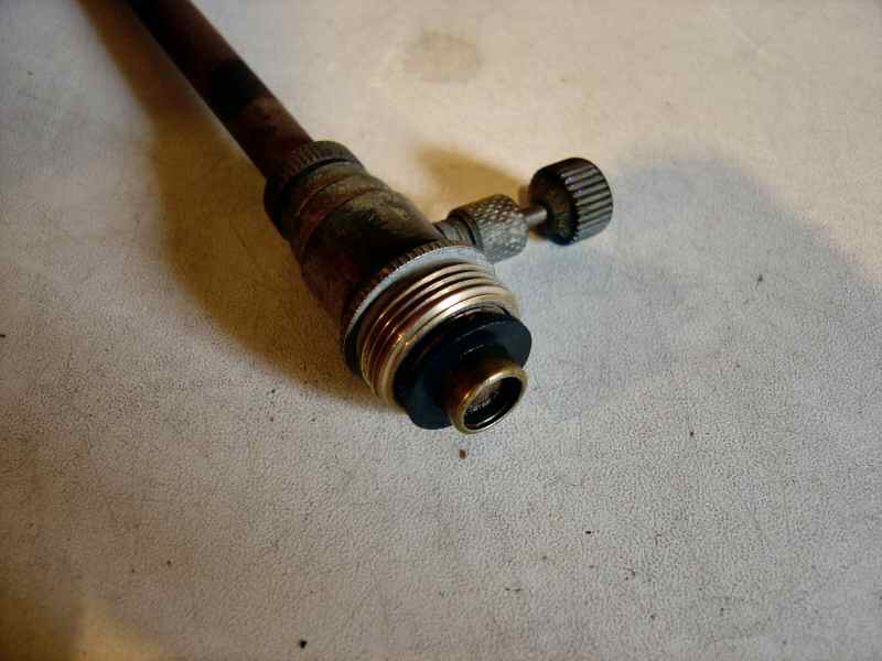

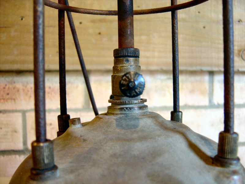

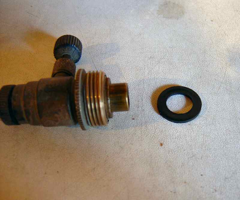

    1,590
    As they say, a picture is worth a thousand words. I'm sure others will have their preferred order of assembly but this is the one that works for me.
    The control valve, the collar and the sealing washer.
    I screw the collar onto the control cock so that about 2mm or so of the stop cock protrudes from the collar.
    Fit the washer.
    Then screw the entire assembly into the tank using the collar. Be careful the two parts don't rotate relative to each other.
    Then with a bit of fiddling and a few choice words you can set the control knob exactly where you want during the final tightening. I promise I didn't cheat here for the photo!
    There should be no need to use tools here, a tight "finger tight" is enough to obtain a good seal.
    Sadly I've seed a few lamps now that have been assembled incorrectly in their past life and the outer collar has been screwed all the way down so tight that it can't be removed without damaging it :(
    I Hope this helps...
    PS. The chances are you'll find your washer will be stuck to the bottom of the hole in the tank. They are rarely obliging enough to come out attached to the control cock base.
