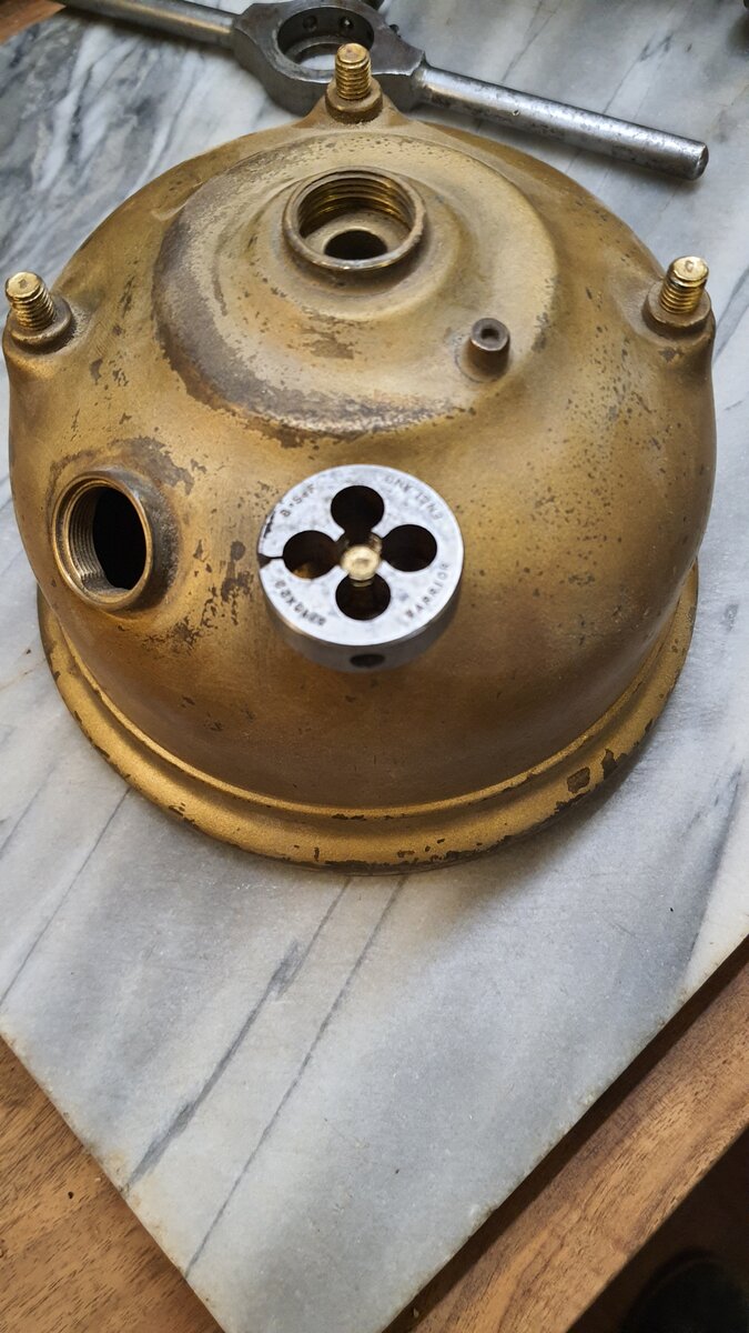

    Hi guys. My X246 TIlley has an "iffy" thread on one of the bolts/studs on the tank where the cage leg nut threads onto. Only one bolt/stud appears to have a burr on the thread, the other three are good.
    When i attach the cage to the tank, the same bolt/stud goes very firm after two complete turns of the ferrule nut, this is of course regardless of which of the four cage ferrule nuts are tried. Question: What thread and size is it? I've worked out so far that it is a 5/16 coarse thread may be BSW (Whitworth)?????

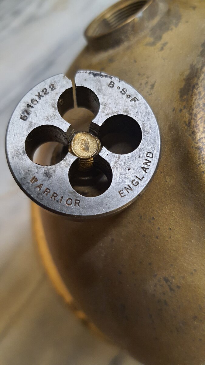

  4. ColinG United Kingdom
    4,816
    Sorted, the thread measures 5/16 x 22tpi which makes it 5/16" BSF
    I ran my 5/16 BSF die over it to make sure and it was perfect.
    I have to say I was surprised that is was BSF as it looked like a course thread!

  5. ColinG United Kingdom
    4,816
    PS... in case anyone's interested, I measured the diameter and the thread pitch before checking my taps and dies to confirm it was correct. No force was used and no threads were damaged in the process.
