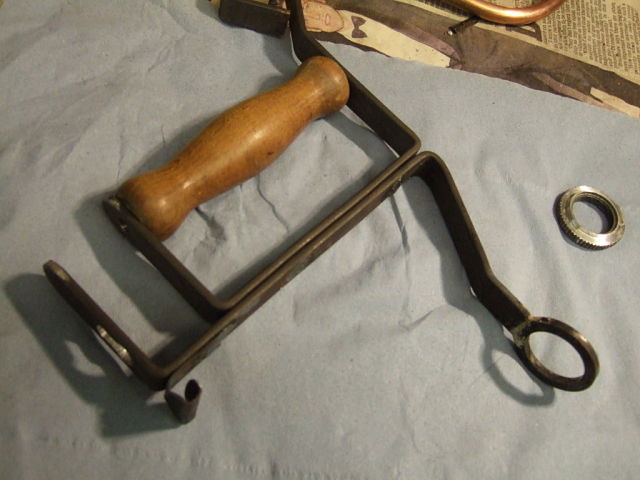

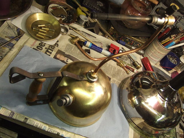

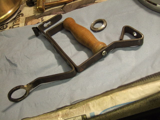

    I have been playing with the X246B founts making wall lamps & the latest creation is an SL/HL type using a homemade handle with fixings for the later "B" style tanks :D
    This was a bit of a stab in the dark as i was not sure of how i was going to fix the rear of the handle to the fount :doh: but a well shaped clip arrangement sorted itself out in the fettling [-o< :D .
    Here are some pic's :D :thumbup:

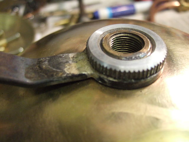

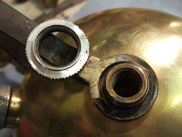

    The front of the handle is fixed to the fount with a slightly over-size ring & this is centered with a machined standard clamp nut , the oversize ring aids with the fitting on :D :thumbup: . the rear clip holds the tanks bottom rim not the tank base :D :thumbup:
    I just need to make a band fitting for the feet to keep it upright when fueling :D :thumbup: & when it's all complete i'll put some more pic's on this thread :D :thumbup:

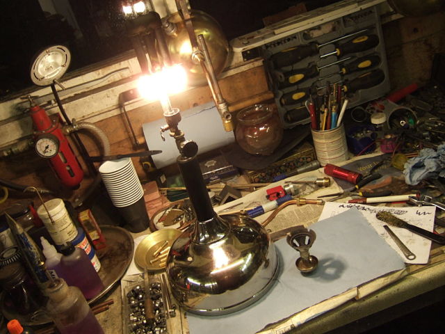

    Nice bit of work there Stu and is it being lit by the CQ?

    You must be psychic :D 8) :thumbup:
    The 96 burner bell & vapouriser next to the CQ is in the CCS fettling forum under "96 stuck burner head" if you fancy a look :D :thumbup:
